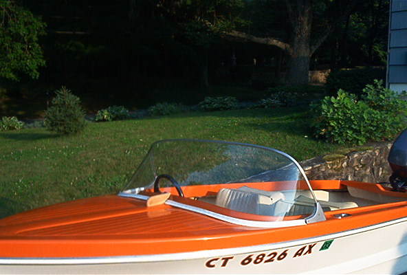

sandsailor, I wonder why it was painted in the first place ? If you're willing to spend lots of time wetsanding with "micro " sandpaper you always have the option to repaint it. heres a boat I had to repaint..I had to use some kind of marine or auto stipping stuff first and I wiped it down with actone before painting to be sure there was no wax or oil left in the fiberglass.I painted this eight years ago and it still looks like this today. its marine handwax no buffer paint. My sailboat has to be buffed and the jelcoat is getting tired from all of the oxidation. You may want to find out what oxidizing will do to your boat if use paint. my sailboat is moored for 6 mo and my powerboat stays in the garage....good luck Smitroe
