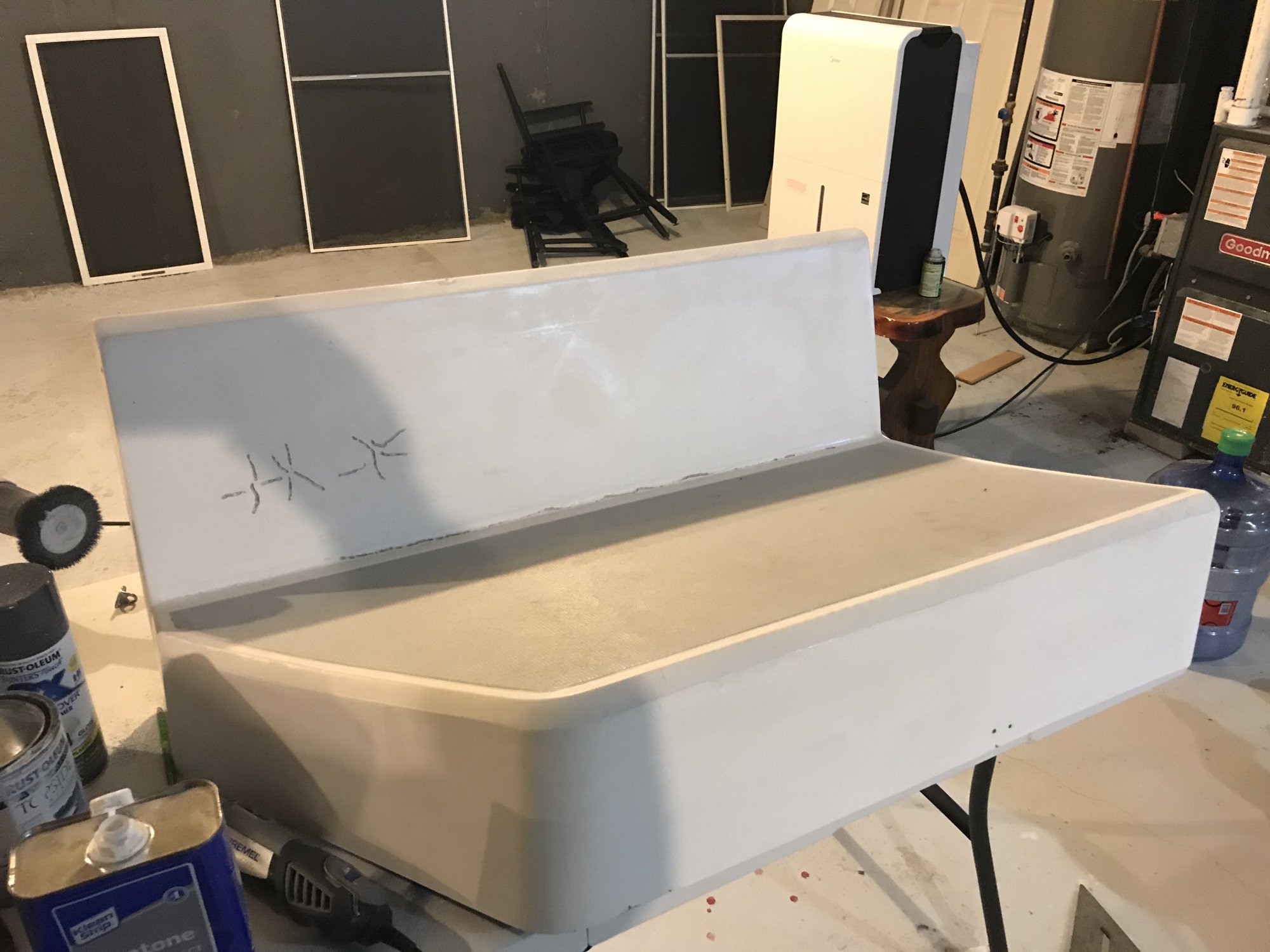

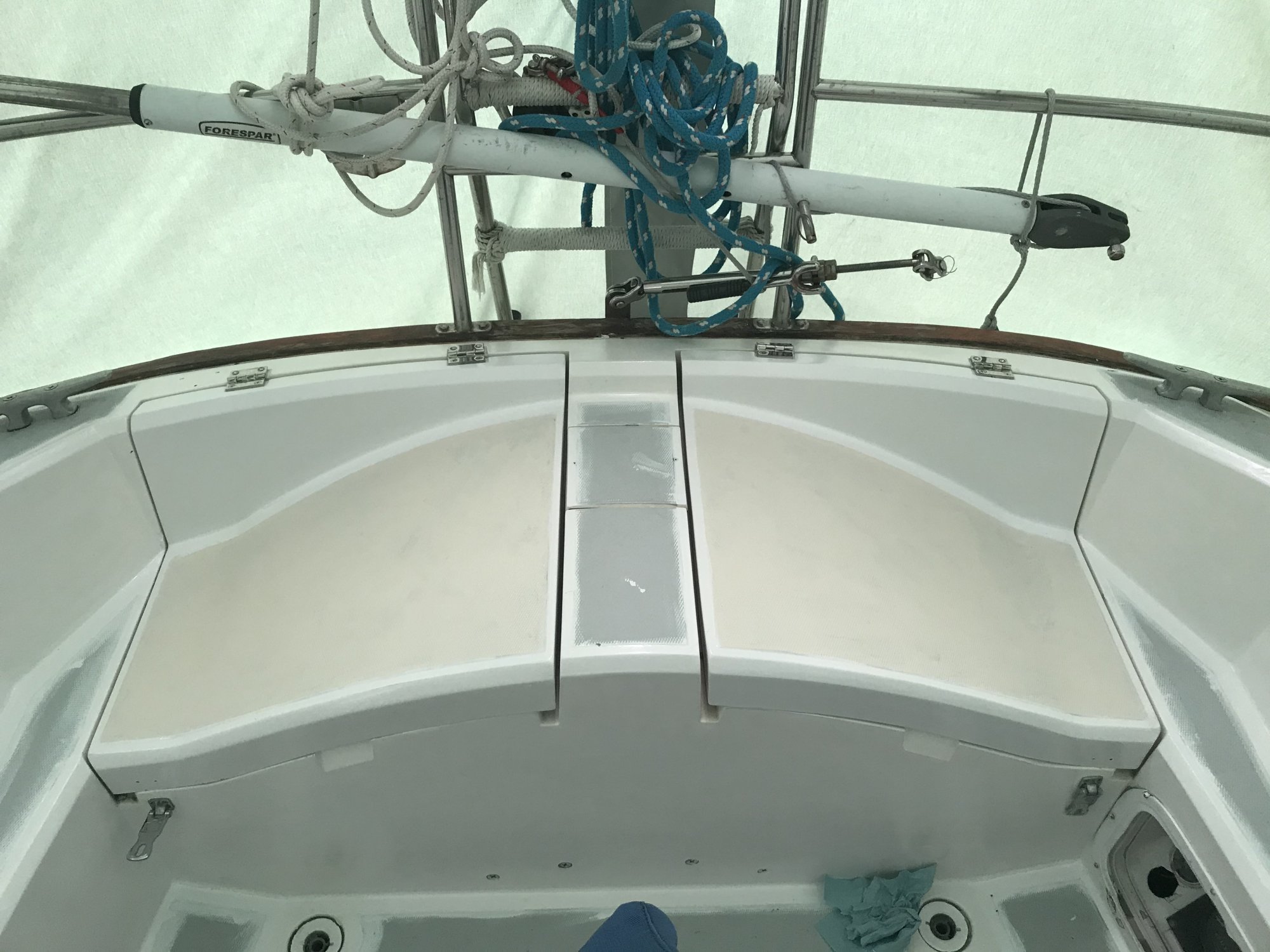

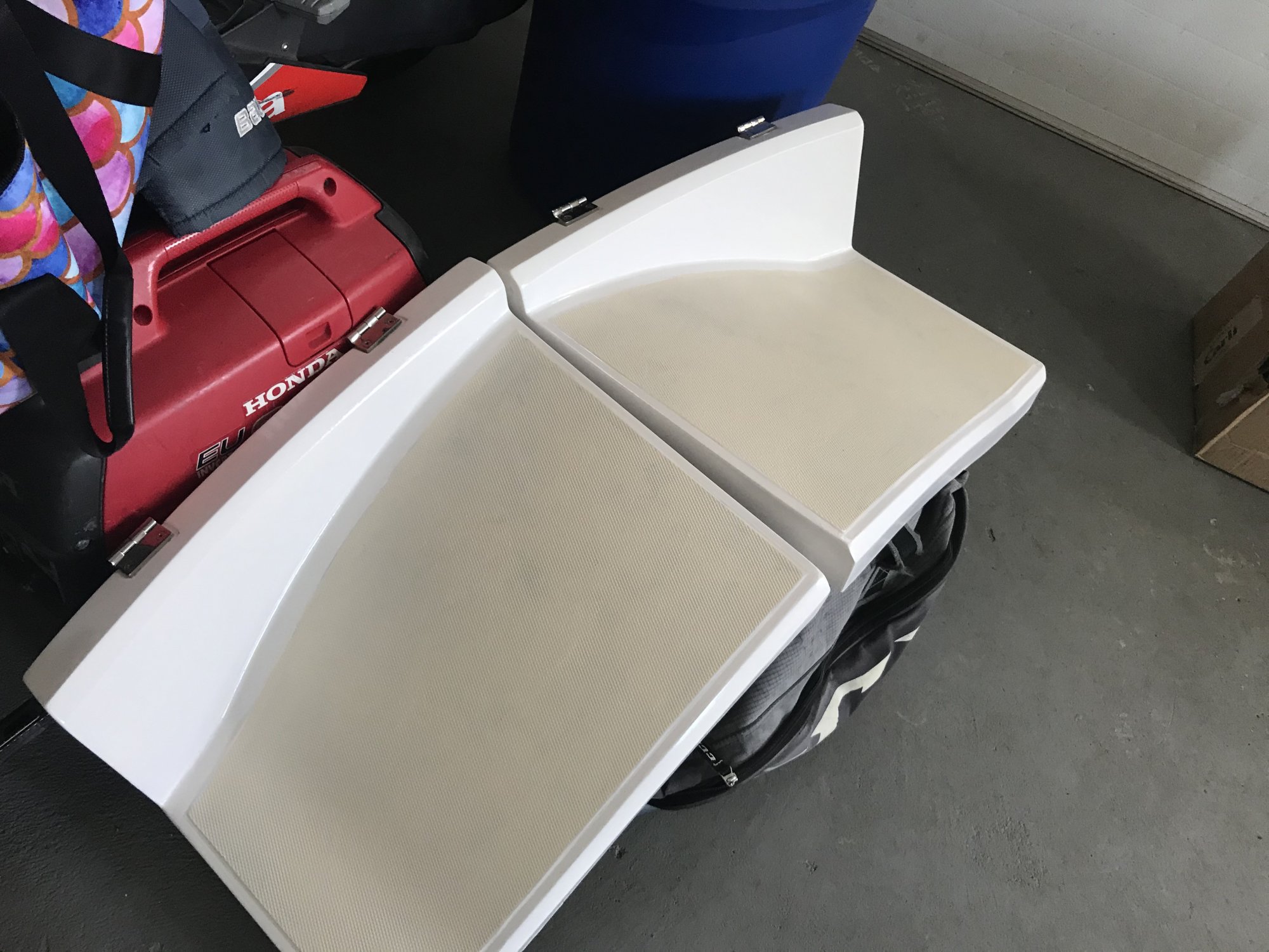

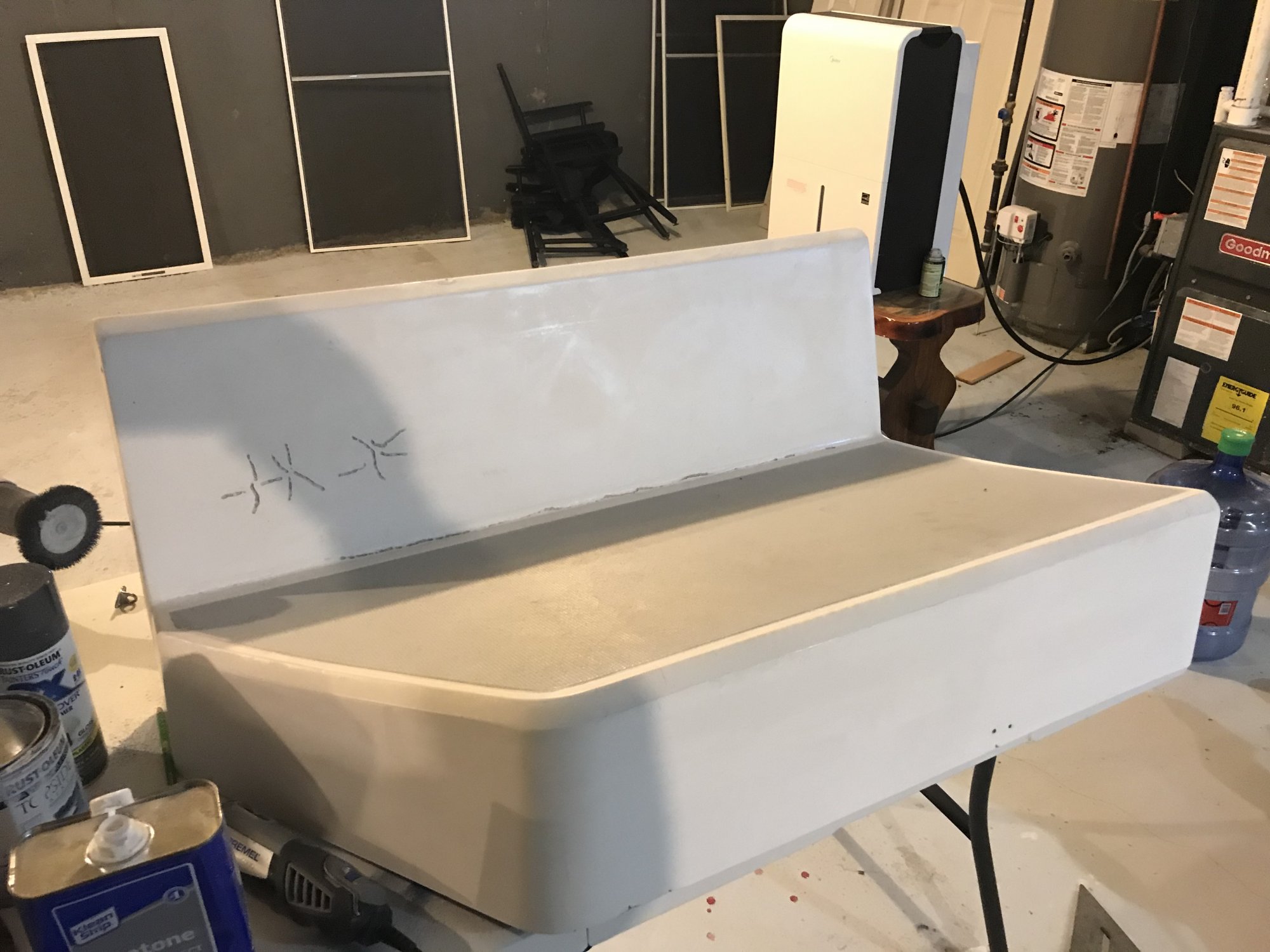

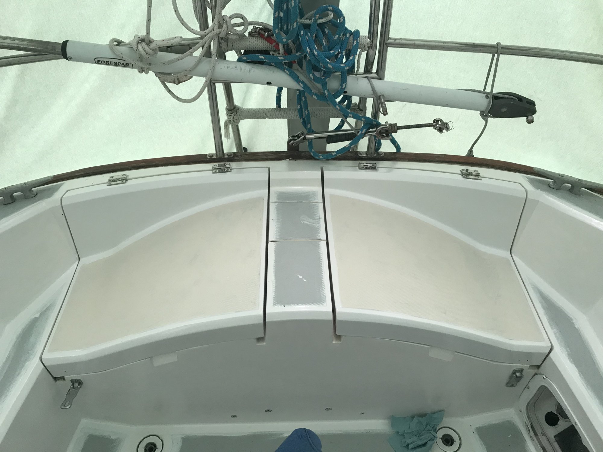

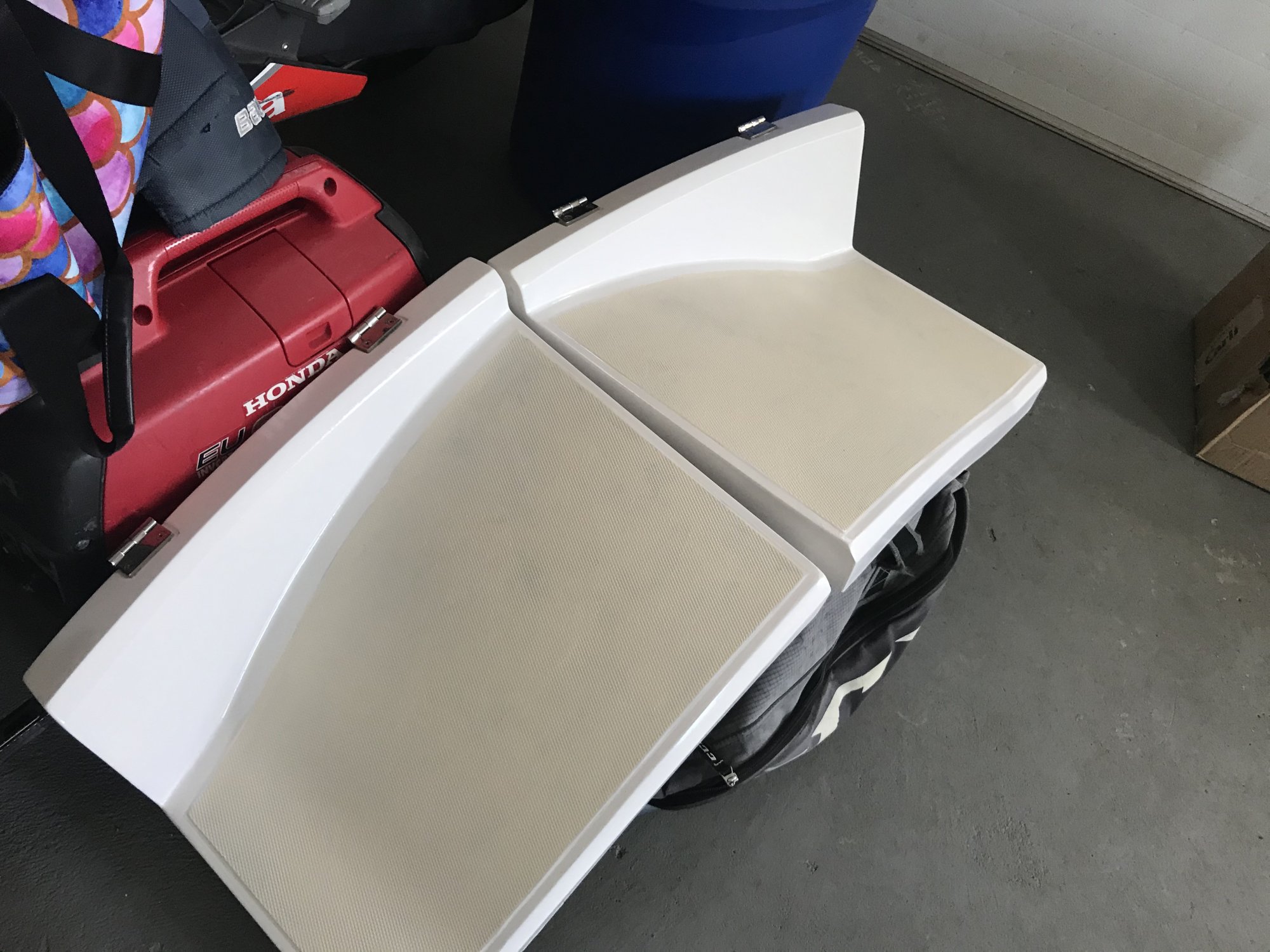

I cleaned, sanded, then acetoned for prep. Then applied Rustoleum marine primer followed by Rustoleum topsides marine..and total boat nonskid for nonskid areas...and am pleased with results, Should work well for a dinghy. Good luck.
