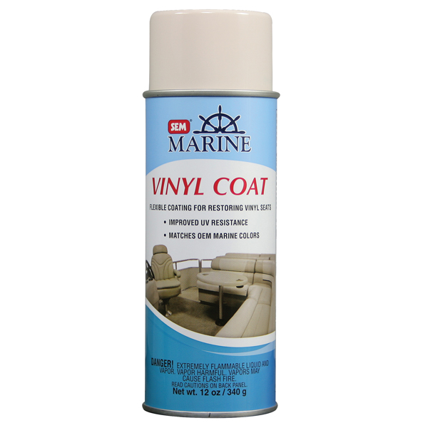

Go by most any automotive paint supply store and pick up an aerosol can of SEM flexible upholstery and trim paint, in the color and shade of your choice. not a bad idea to also get a can of the SEM plastic and leather prep spray for a really permanent bond. it's an excellent product. I've even done color changes on full auto interior plastic trim and been very happy with the results.
Thanks, Russ. Why didn't I think of that? :doh: I actually sell the stuff - just did not expect it would work well on something stiffer than flexible motorboat upholstery.
For those who don't know, there IS a 'marine' range of SEM Vinyl Coat. The colors are very good matches to major manufacturers' vinyl upholstery. They're even named for them - Ranger White, Chapparal Beige, etc. I've had customers come in very sceptical, sold them a can, then had them come back in asking for (much) more. Everyone has raved over the stuff. No-one has disliked it. So there's a testimonial for you. :dancing:
My initial thought was latex exterior paint - this is what I would have used about 5 years ago. But there are modern solutions now; and of these SEM is probably the best.

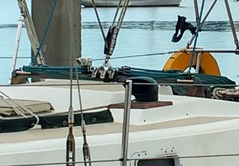

FYI - I found the other PVC cowl vent that I bought (and forgot about) as a 'spare' for the one that's gone bad. I hadn't thought it was that much of a difference till I compared them!
