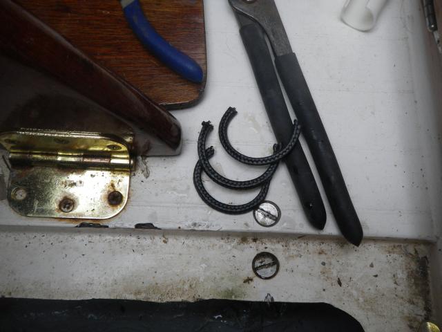

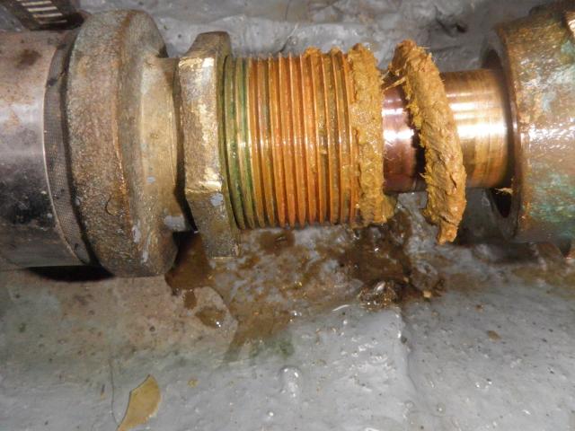

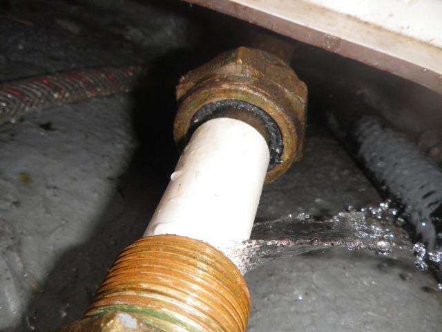

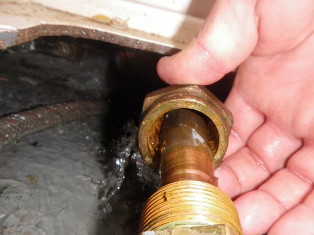

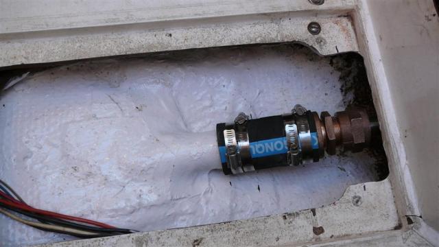

I did mine last summer in about 20 minutes. In the water and it was no big deal. I've included pictures, which are very similar to the above sites. His are in a steril bench top environment, mine are the real deal.
The white tube is a piece of pvc pipe that I cut to push the flax into the packing nut. Works great.
Good luck!

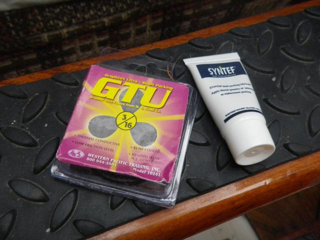

Like everyone else following Main's advise, I found the job easy except...
I bought 3/16 packing and made up 3 rings using a 1" pipe and it turned out my set up used 1/4 packing and only 2 rings. Go figure:cussing: another trip to West Marine.

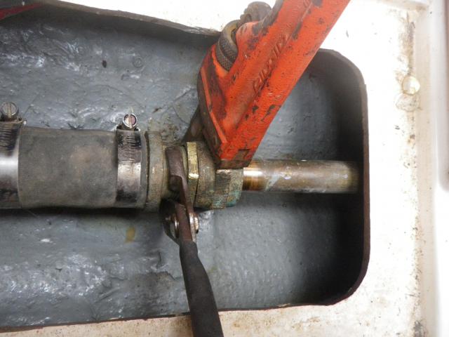

Catalina 30 Solomons, MD

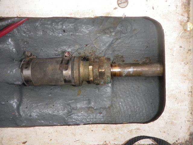

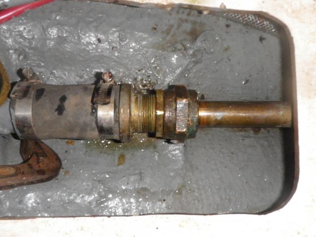

Bob, even boats only several apart seem to have different stuffing box configs..Team 118's, which is old like mine is different. Old Skool Neil and I have compared notes and ours are different as well..only 90 hulls apart!
here's mine. - hull #511..Notice I've 'improved' access slightly by cutting out the lip.
23,360
As long as you can move the box forward, you're OK. Many boats (too many, in fact) don't have that room. Calder included those "issues" in his Cruising Handbook.
