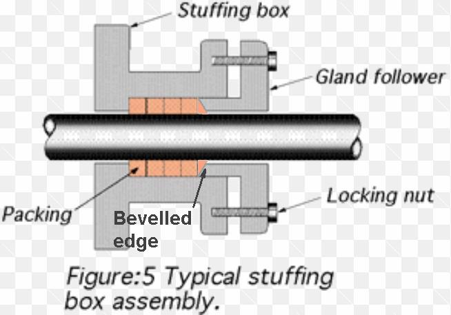

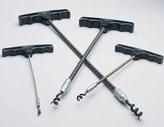

While we are talking about packing, there is a tool expressly made to remove the old packing from the gland. See below.
No need to go digging around in there with a pick. In an emergency, you might use this to open a bottle of wine, too.
23,087
Most of us here on sbo have 1" shafts. There is not a single one of those tools, even the smallest one, that work on 3/16" or 1/4" stuffing. There is simply not enough room for even the smallest one of those ever made to work.
That's why we use other means to get the old stuff out of the box. And is discussed in my article linked in Reply #15.
Please don't waste your money on one.
Those with BIGGER boats, like capta's (a 53 footer) could find one that would work.
