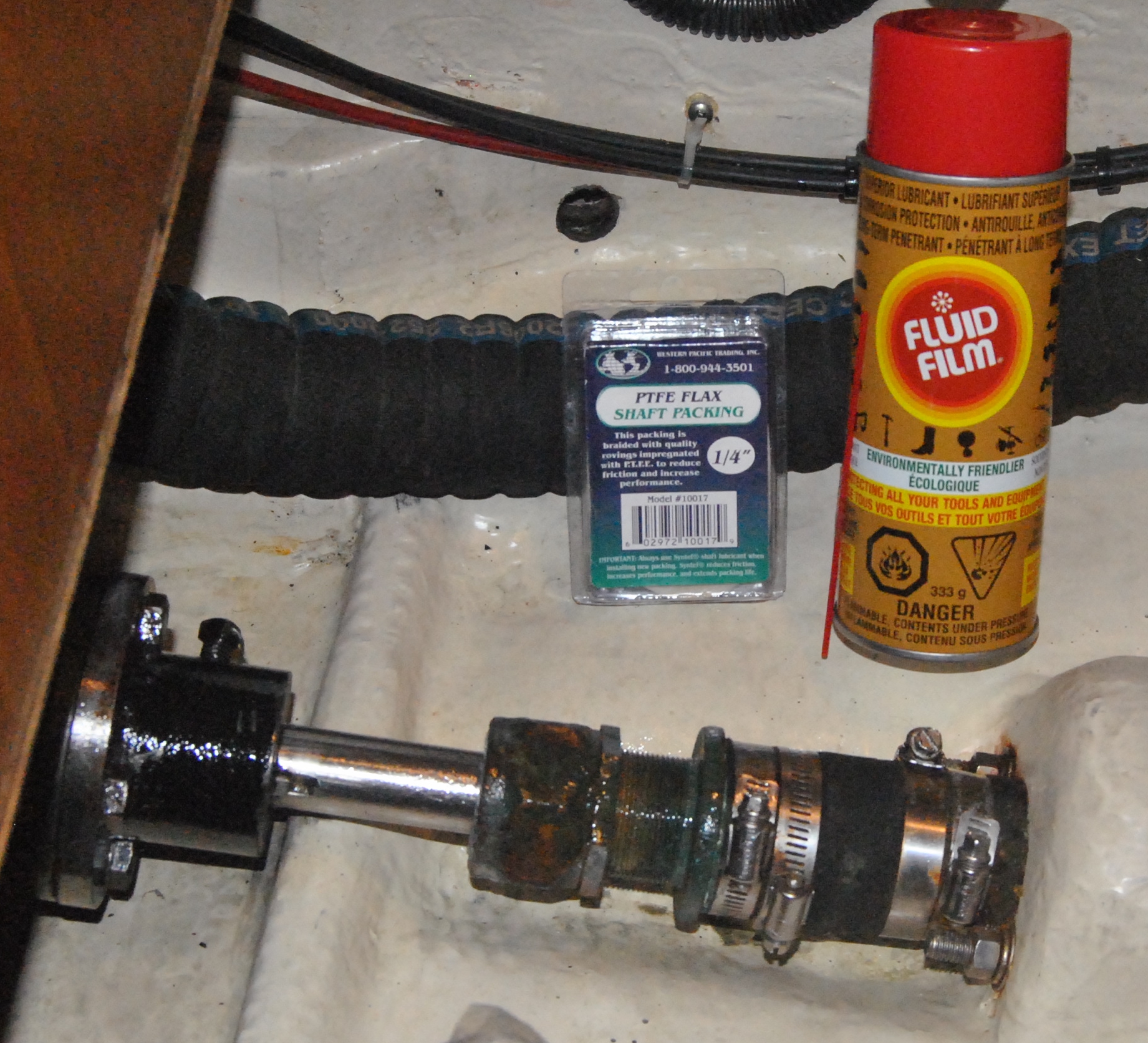

Here is a shot of my packing gland with the packing nut on the outside of the lock nut:
And hence, the nut closest to the engine is the packing nut.

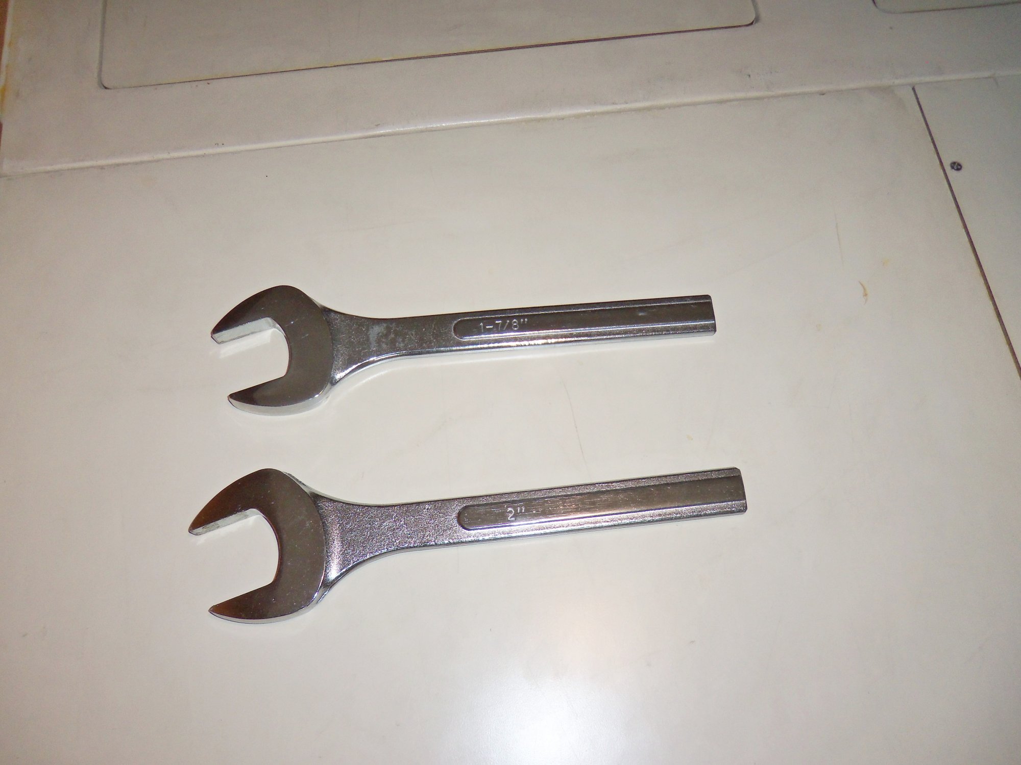

I knew I had a pic of it around here some place and it finally fell out of a loose page:
1-7/8" for the lock nut, and 2" for the packing nut as you had said.
