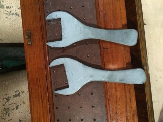

If your traditional stuffing box is close quarters standard wrenches may not fit. You can also make your own.

I bought a pair of short aluminum wrenches on EBay last year, and was happy. I got mine from Yorkfabs out of Middleton, OH. A search for "stuffing box wrench" on EBay will show you a variety of sizes from $30 - 50. Personally, I found the aluminum ones fine for the occasional use these things get. The short handle is great for the small space you will work in, and there is a square hole for adding some force with a ratchet wrench.
