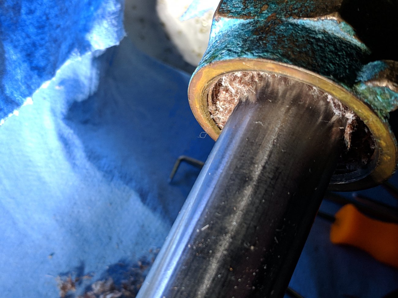

As others have said you can certainly replace while in the water but a word of caution. If you don’t have an idea of the state of your packing you may want to consider waiting till you’re out of the water. Not because of water ingress, but because it may be a time consuming effort to get the old out.
I just did this knowing I was overdue (my fault) and found a mess that took me about 8 hours to get out and cleaned up. I would work a couple hours, go home take Advil for my back and repeat.
Next time I won’t hesitate doing it the water, but glad I was on the hard in this case.
This is what I was up against:
14,193
The hardest part of the job is digging out the old packing, especially if you have poor access. The packing has been there a long time and has been compressed, so it is really packed in there. I did the job once on my Sabre 30 and the next time it got a shaft seal. To access the gland, it was necessary to fold myself up in the sail locker and work one-handed with only a couple of inches of room to dig it out.
