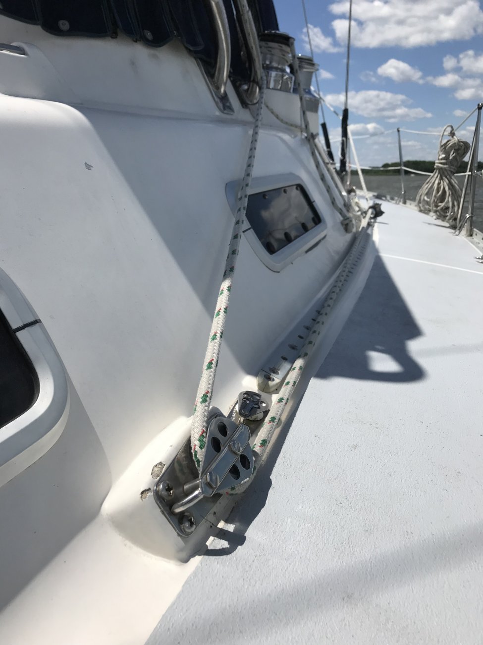

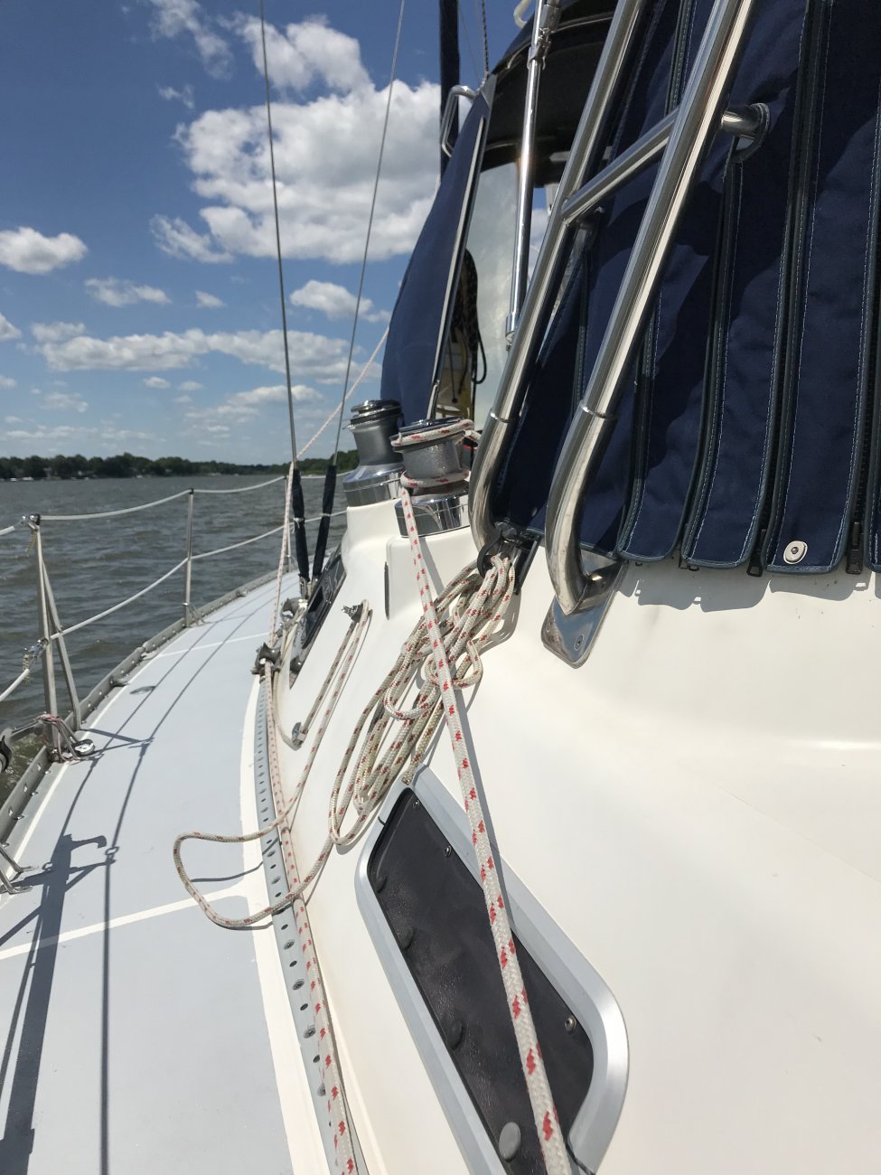

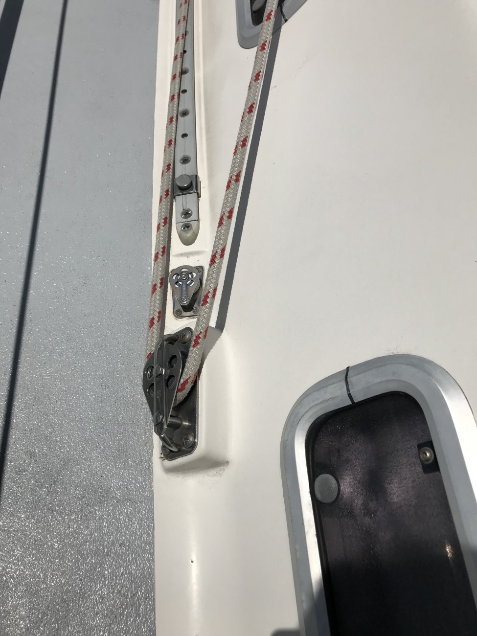

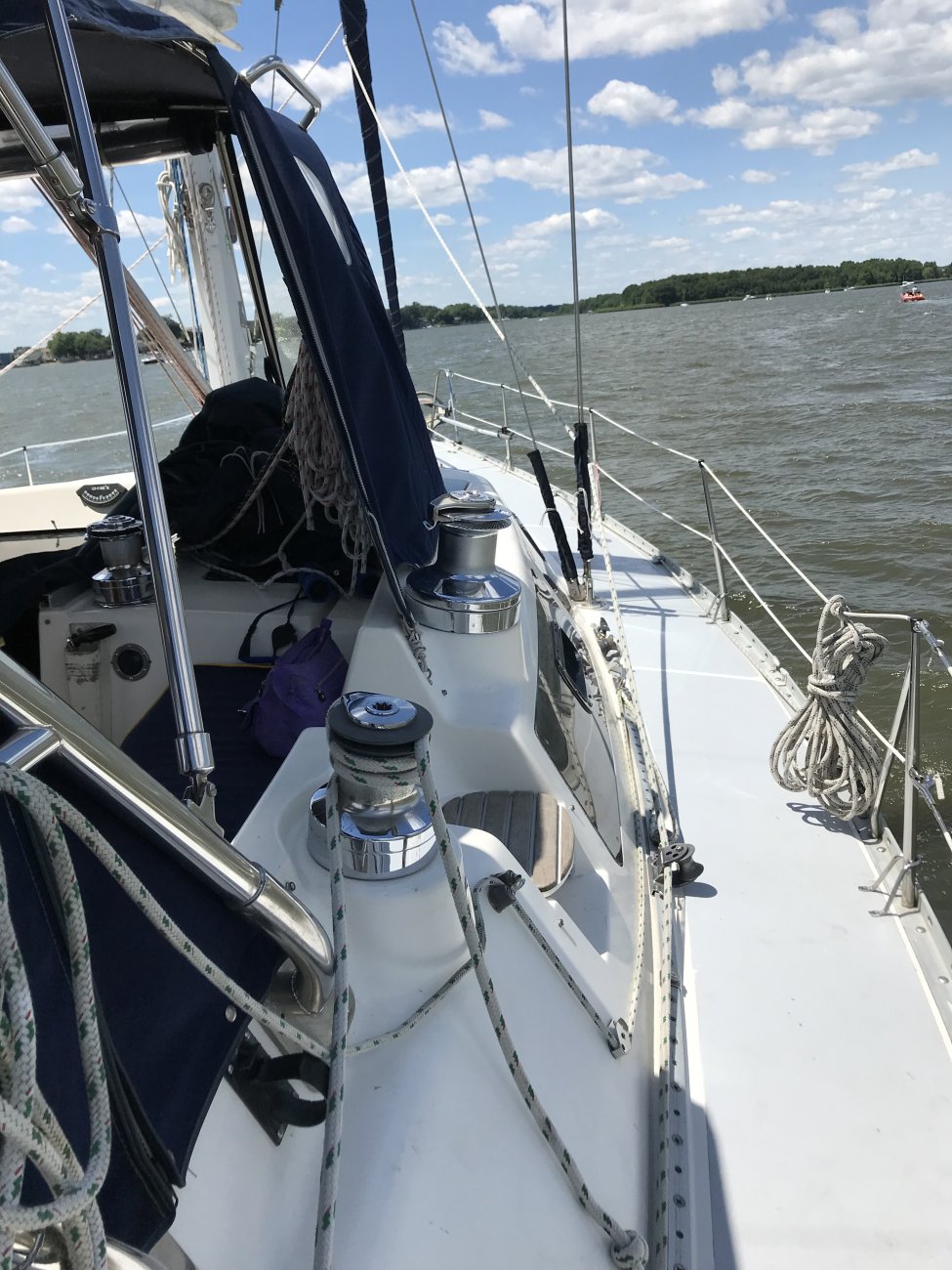

I have definitely taken advantage of the gusts to improve my line. I was going to put this out there as well ... how do you setup your jib sheets? Not happy with my current as sometimes the line falls below the winch when hauling when winds are 15+. Don’t have picture of my current setup will take one this weekend

Unsure of the nature of your situation. Our genoa sheet layout remains as they came from Hunter. I've made a few mods, such as a plastic shroud pipe to stop shroud sheet chafe. Each sheet extends from the genoa clew cringle, to the cheek turning block back by the aft cabin, then forward to each winch. Never had a problem with the sheet falling off the winch, even in apparent winds of 25+ close hauled, or in any angle of attack.
I'll try to remember to take pics of our setup as well, but I suspect they should be the same.

Has a led block along the track that adjusts. It runs to the aft bock and then up to an winch (aft side of cockpit) I have two very large winches in line with the hatch at the front of the cockpit. These are great winches but a pain to use with dodger setup. The aft winch has issues when more that a single wrap is around it when pulling in jib. The angle up to the winch from the aft block just doesn’t seem to be the best. I will contend that often user inexperience likely comes into to play as I have a large variety of people that go out with us and often the winds are 8-12 and really not an issue at this wind speed/tacking speed.

Your primary and secondary winches can be used in anyway you want. If the dodger prevents a clean entry of the sheet to the primary's drum, you might consider installing another turning or foot block to give the line the rear entry option. If the winch is too close to the dodger for you to get 360 deg grinding.... and you're forced to ratchet instead, you might consider moving the winch back far enough for the winch handle to clear. (On my smaller boat there is adequate clearance but I strip in the sheet by hand and ratchet the remaining line once it becomes tensioned because it's just easier on my body.)
If the secondary winch you're using for your genoa sheet now seems to have enough power but you want a better entry angle... I would suggest relocating the turning block somewhere in front of the winch. Your genoa track may be long enough to do this easily.
