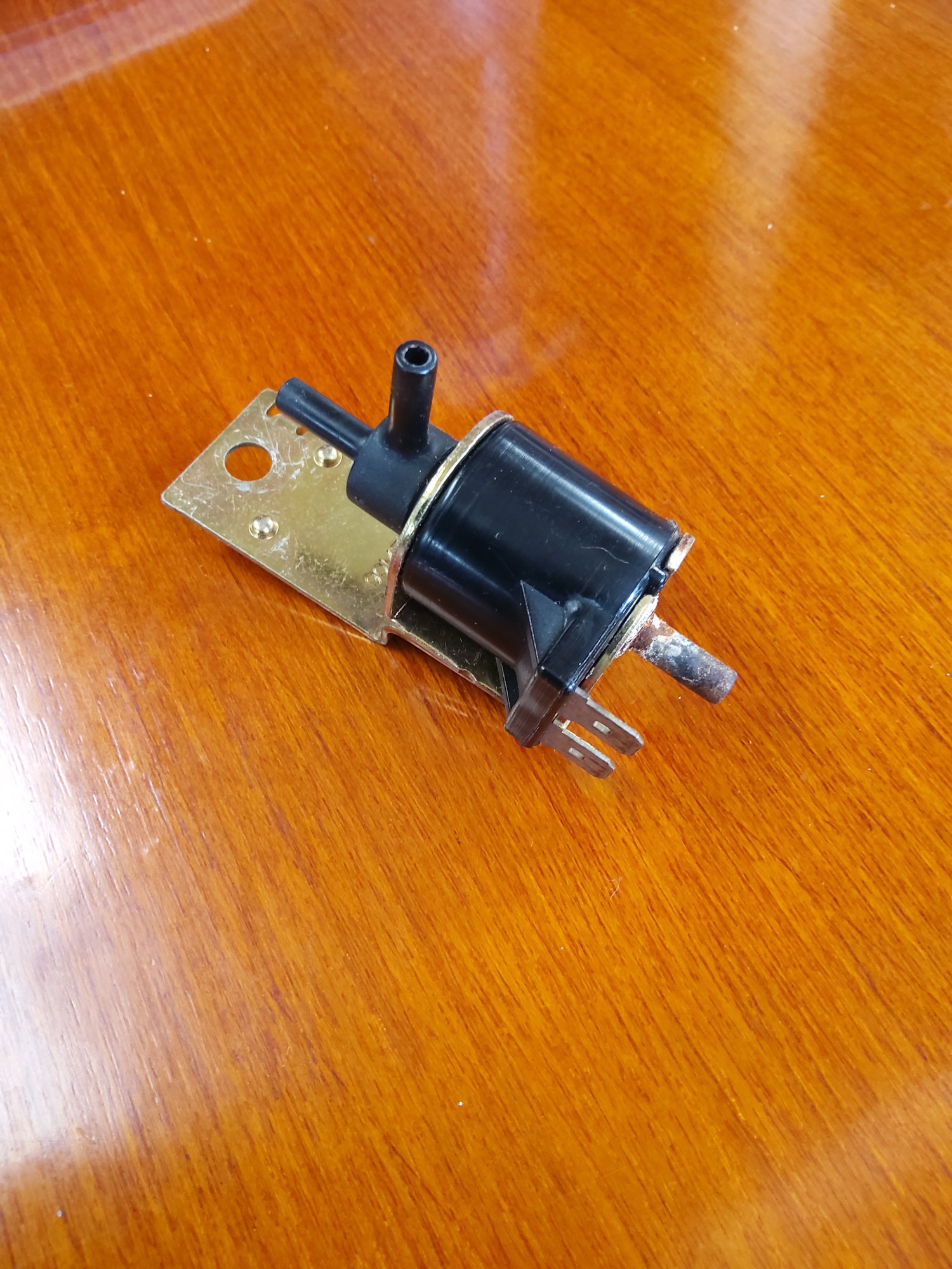

I need to replace the solenoid on my forward head system. After extensive searching I found it behind an access panel in the starboard, forward cabinet.
The only ID on the part is 2-27106. I've contacted Hunter and am waiting on a reply.

Jabsco 37038-1012 Solenoid Breaker 12V is the part # for the Jabsco solenoid valve...available from a number of retailers that have a wide range of prices for it. Can't help you to find it on your aft head except to say that if it's hidden behind a panel in one head, there's at least a 90% chance it's behind a panel somewhere in the other one. And if your boat was built before Hunter became Marlow Hunter, it's unlikely they'll reply because new owners rarely keep any of the previous ownership's files.

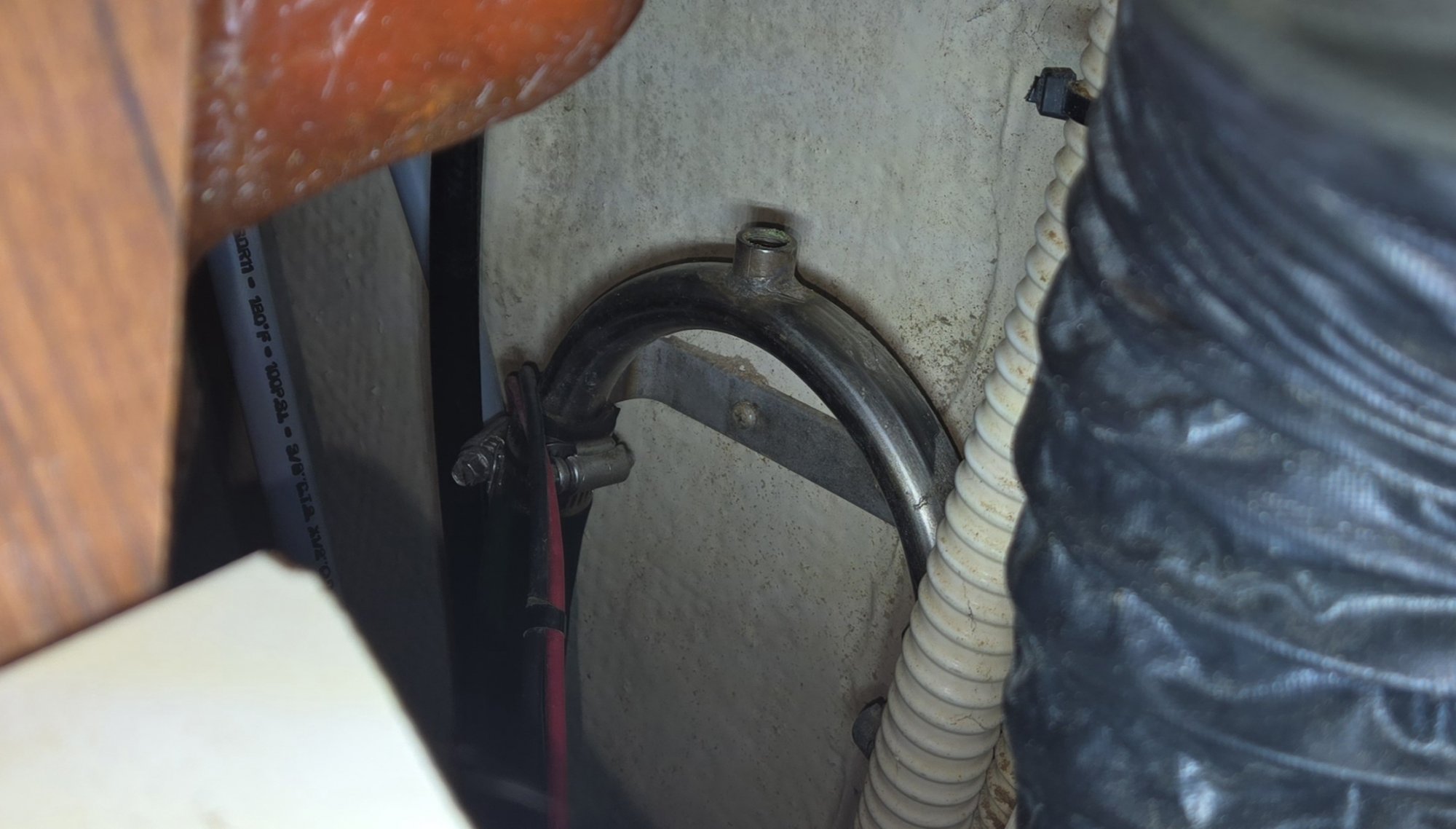

Our aft head solenoid is mounted on the starboard bulkhead engine compartment, right next to the vented loop.

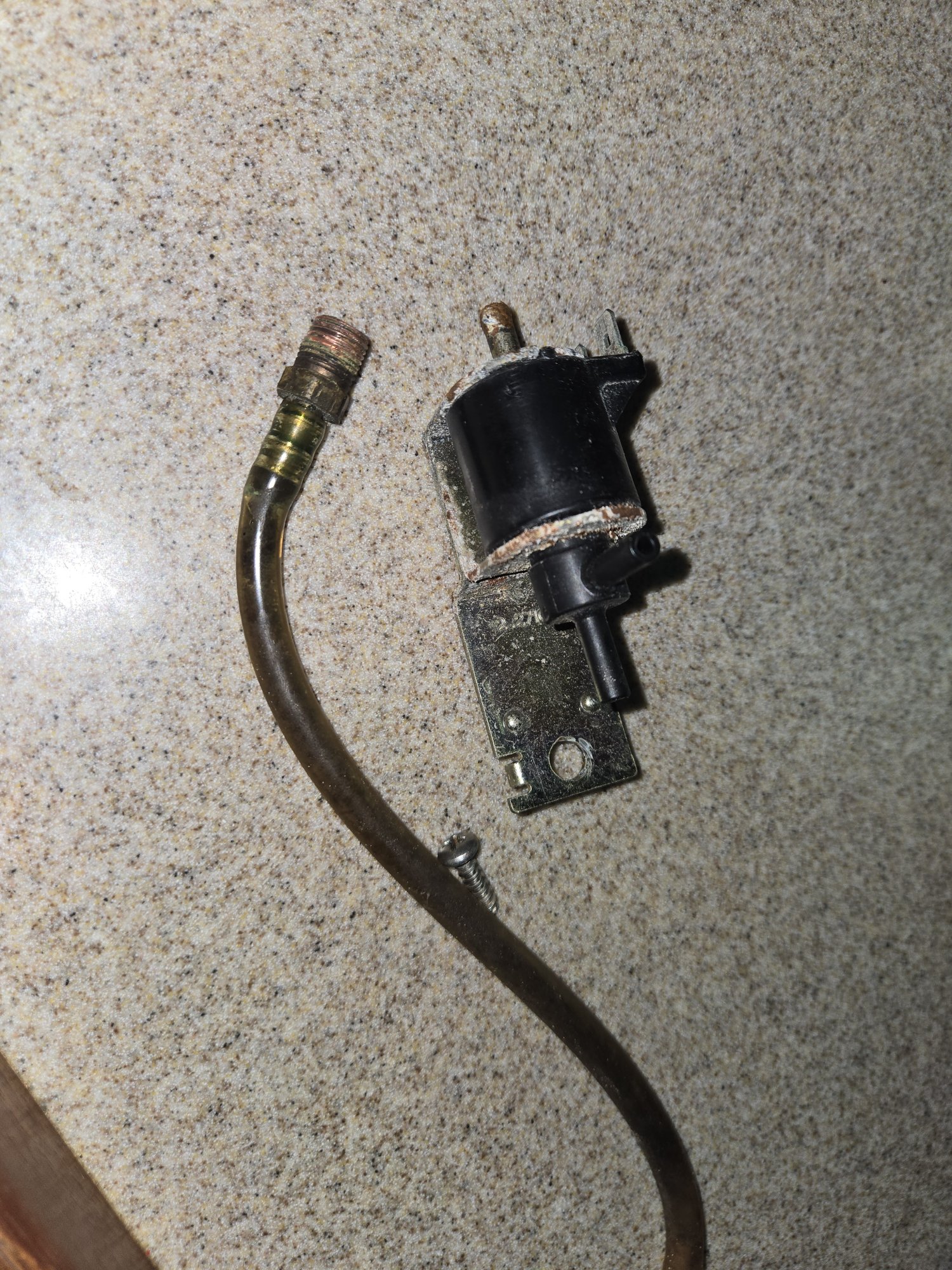

Your photo depicts one of the old style Jabsco solenoids which are no longer in production. Jabsco now makes the "updated" version of that solenoid. The new version includes a rotating valve that permits you to adjust for the amount of air that enters the line. Regardless of whether you consider it an upgrade or not, the old ones are no longer available. I don't know why, but I seem to go through solenoids on my aft toilet about once every three years or so and I always keep a couple on hand.
Peggy gave you the correct part number for the quiet flush Jabsco toilet, but I suspect you may have the same 37010 series toilet that I have on my Passage 42. The part number for that solenoid is 37068-2000. And you'll find the solenoid precisely where Terry said it is. (You may have to get your entire upper body in there with a flashlight to see it--it can hide behind the scupper hose or the angle-iron battery stand).

Thank you Peggie, Terry and Paul. Terry nailed the location. Found it mounted just beneath the vented loop. Paul is correct in that I have the 37010 series, so the solenoid is on the seawater intake side. The problem is the old and newer solenoids are directly connected to small diameter hoses, not to the vented loop as you can see in the attached photo. So the solenoid is neither of the two suggested. To access the aft, the upper 8D battery would need to be removed as it is beyond arms reach. What else is new....
Luckily the forward is accessible thru the cabinet I spoke of earlier. That being said, I still need to find the solenoid that is right for this application.

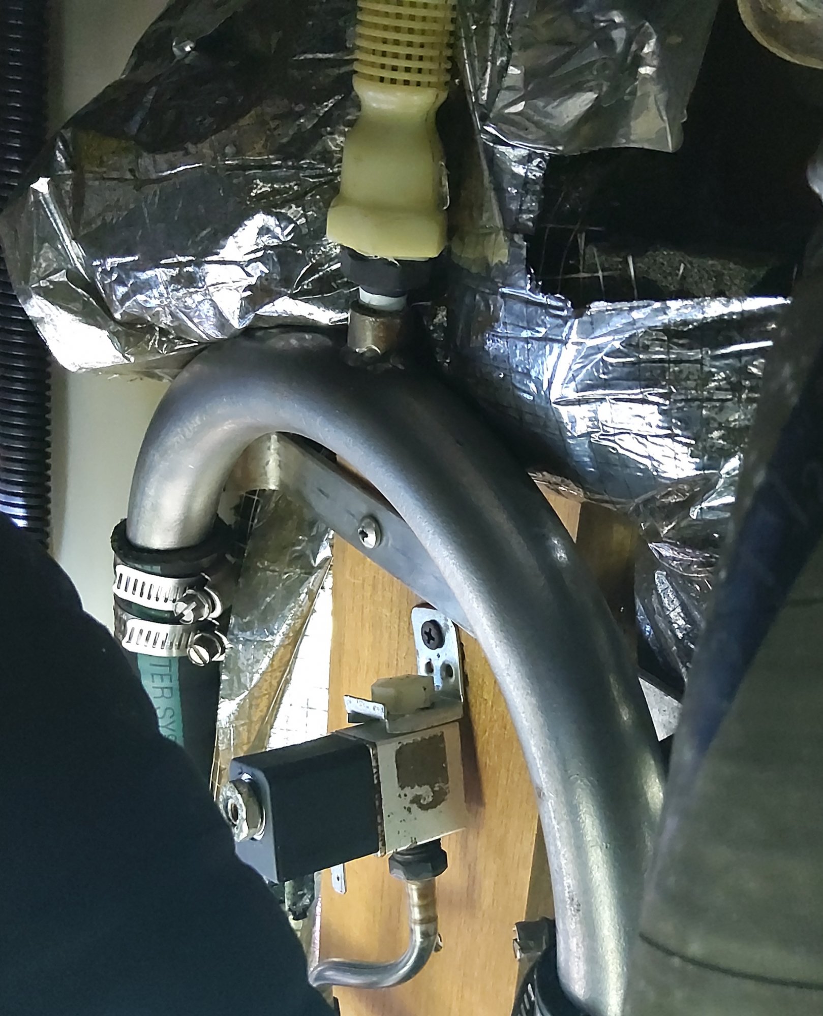

Did we ever establish what PN for the solenoid valve? PN 37068-2000 appears to connect directly to the top of the vented loop and not sure it will fit mine. 1000007620.jpg1000007619.jpg
