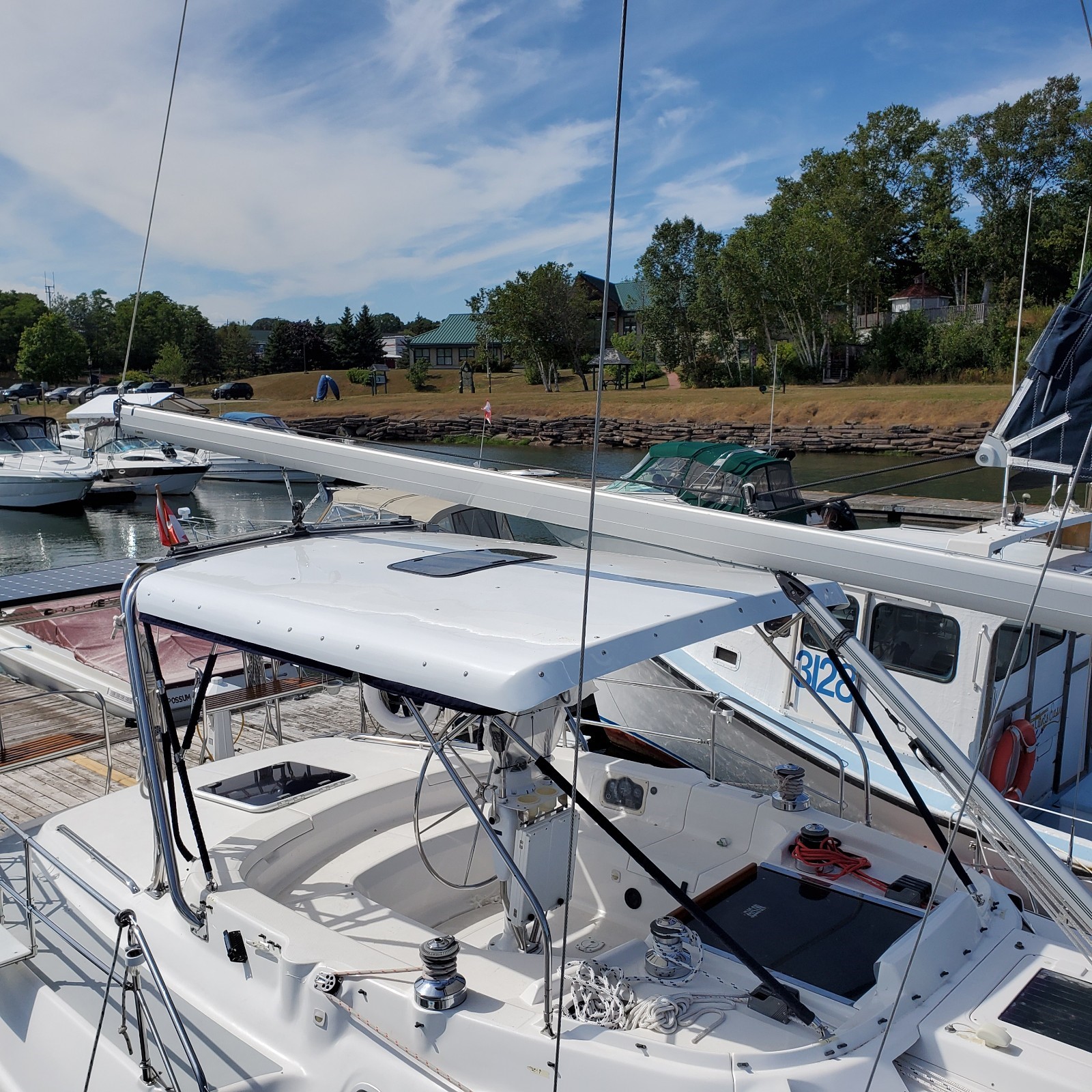

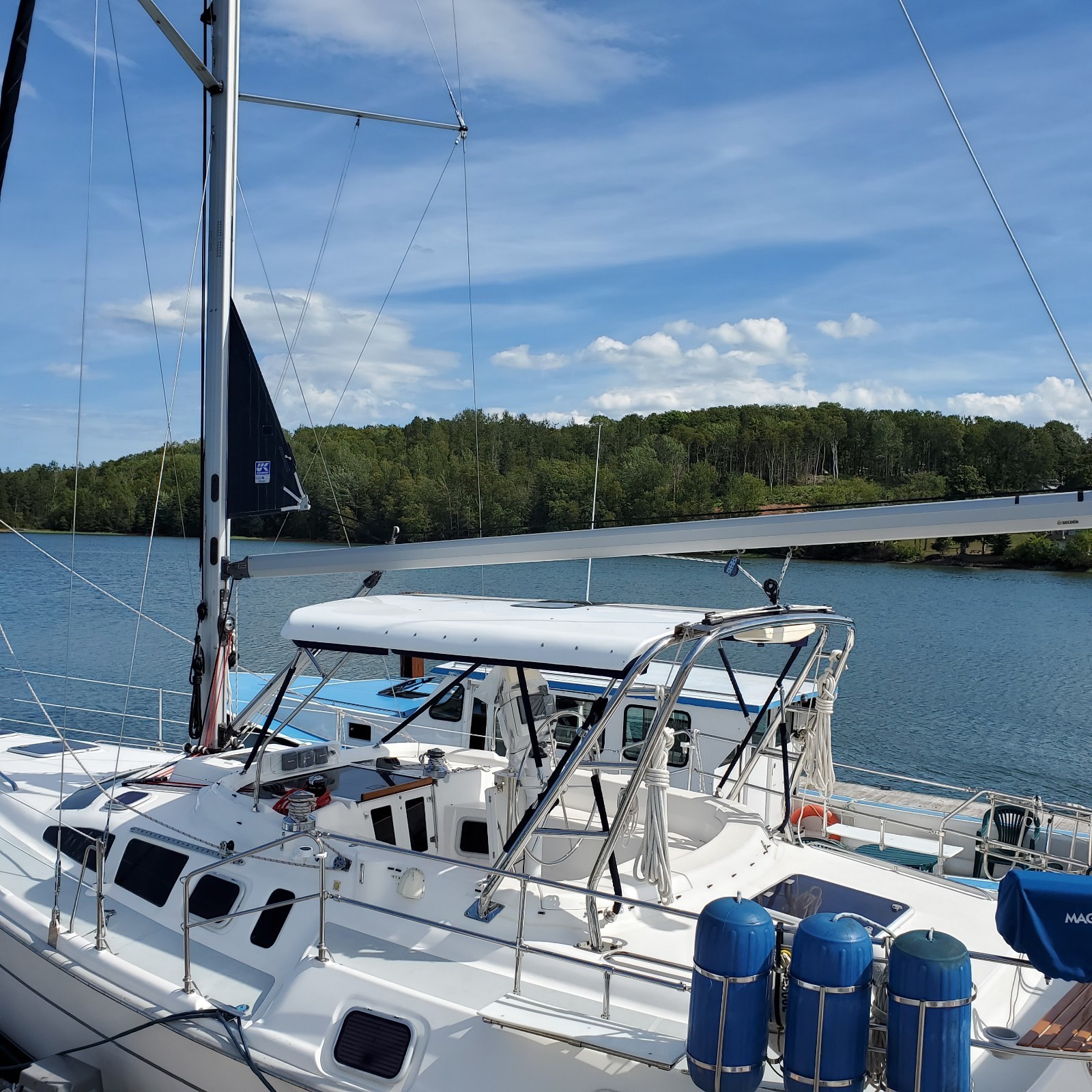

I made a mould and the hardtop myself and used the current canopy supports (4 of them) as the mounts. The black rods are actually stainless steel rods with a fabric covering to protect the clear plastic glass. The tubes are 1" diameter. PM me and I can provide more photos on how I connected the fibreglass top to the tubes with truss head bolts and stainless steel clips. I plan to install flexible solar panels to the top at some point. Here is a link to a post I made on the project.

Is it an optical illusion or is the boom "canted up" much more than normal? I"m not familiar with the Passage 42 set up. Since the roller furling is a loose footed main maybe it doesn't make any difference.
Aug 29, 2018
57
Hunter 420 Passage Sv
The boom is "Canted up" more then normal. I added a gas strut inside the rigid boom vang this past winter and when the boom vang is relaxed, the boom is higher.

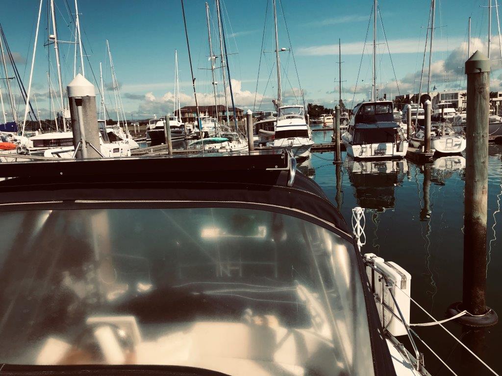

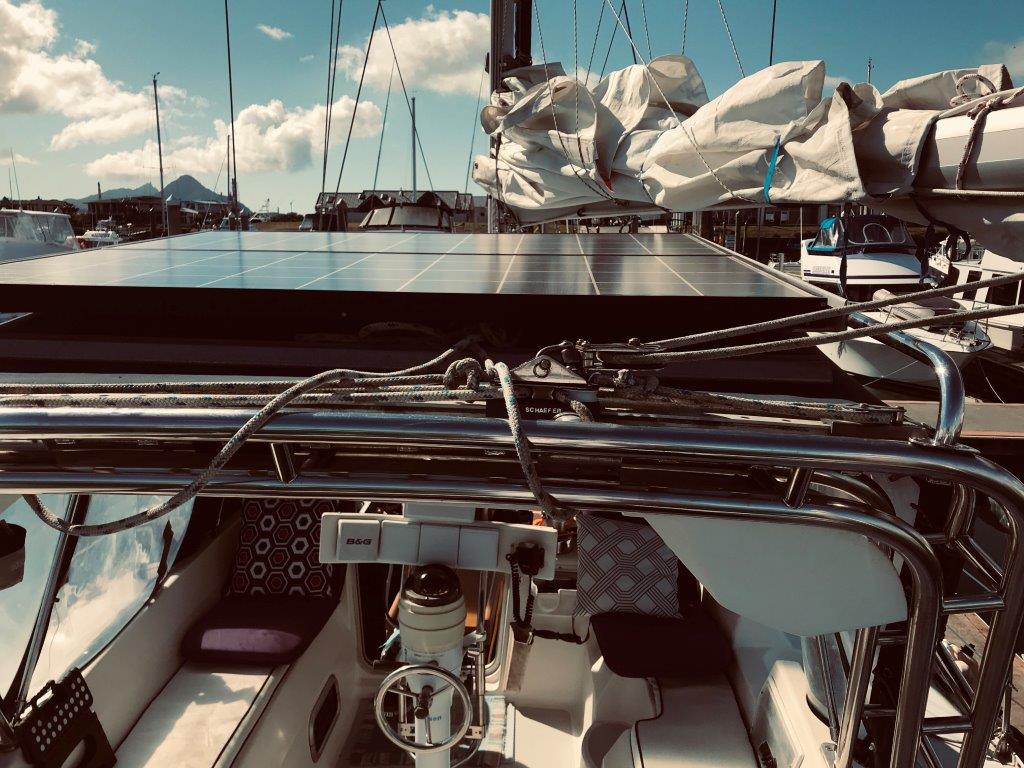

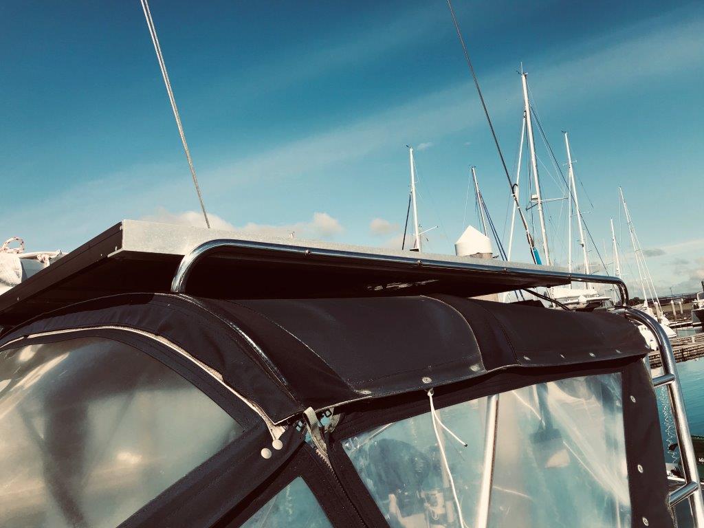

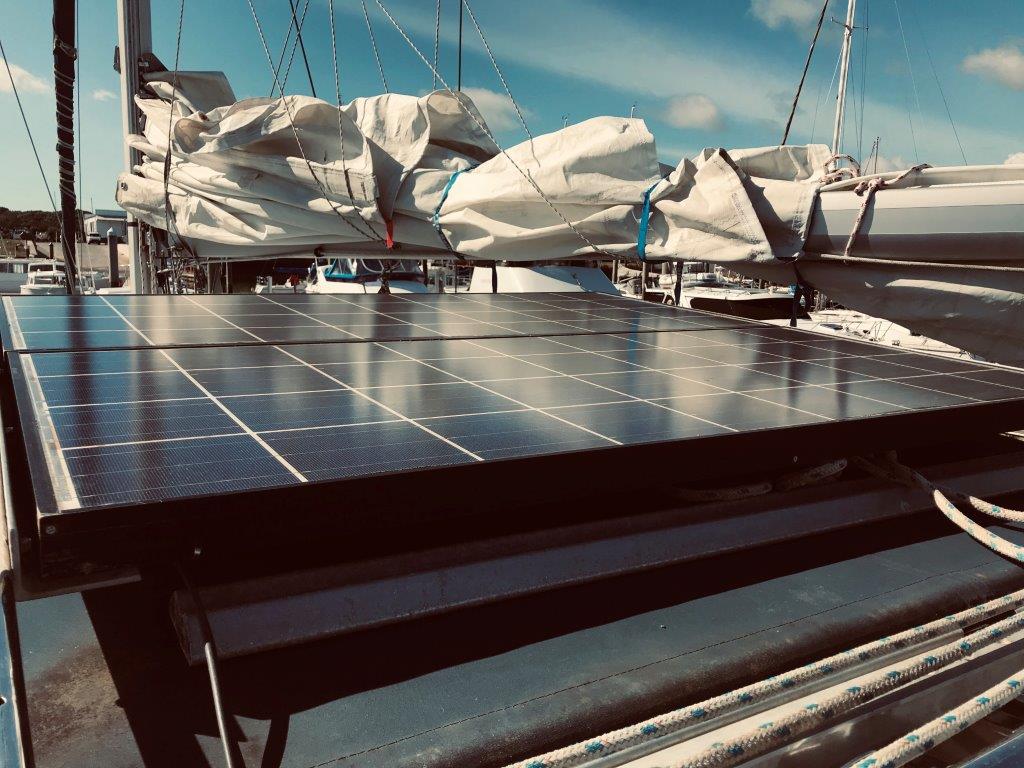

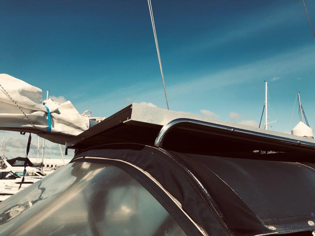

Hi HandsOn, I figured I'd just shoot you some quick pictures of what we did on our P42 for solar panel mounts. We mounted them to the top of the bimini. I had some stainless steel tubes configured and then drilled and bolted onto the sides of those tubes some angle aluminum. Plenty strong enough, and it provides some handholds going forward and aft along the outboard sides of the cockpit. We just pull the boom off to one side or the other and we get sunlight on the panels most all day long. Our energy needs are rather meager, so we get pretty much all the power we want from our panels; in fact, so much so that I removed the wind generator, and very rarely have to run our generator (a 5 HP Kubota diesel with a high output alternator attached to it). I've been extremely happy with this setup. And it was quite easy to do.
Cheers,
Paul

Thank you Paul. Exactly the kind of ideas I am looking for. I entered this project with zero bimini building experience, driven by the objective of mounting four solar panels over the cockpit. What hampered the exercise was my design attempt to mount the panels to the existing bimini/dodger structure. Mine was the compact ‘sports model’ and was just not suited to creating a large, flat roof.
I am reminded of a comedy skit from decades ago where the objective was to turn a VW Beetle into a Porsche. The gist was that they examined each part (wheels, seats, etc.), determined that it did not look anything like the Porsche part and tossed it. The result was that they ended up with nothing left and started building a Porsche out of Porsche parts. It took a while, mostly due to my lack of experience working with tubing, but i finally came to the same realization. I pulled all ten pins, removed the existing bimini and dodger structures, and started from scratch.
I expect to mount the panels tomorrow and will post photos.

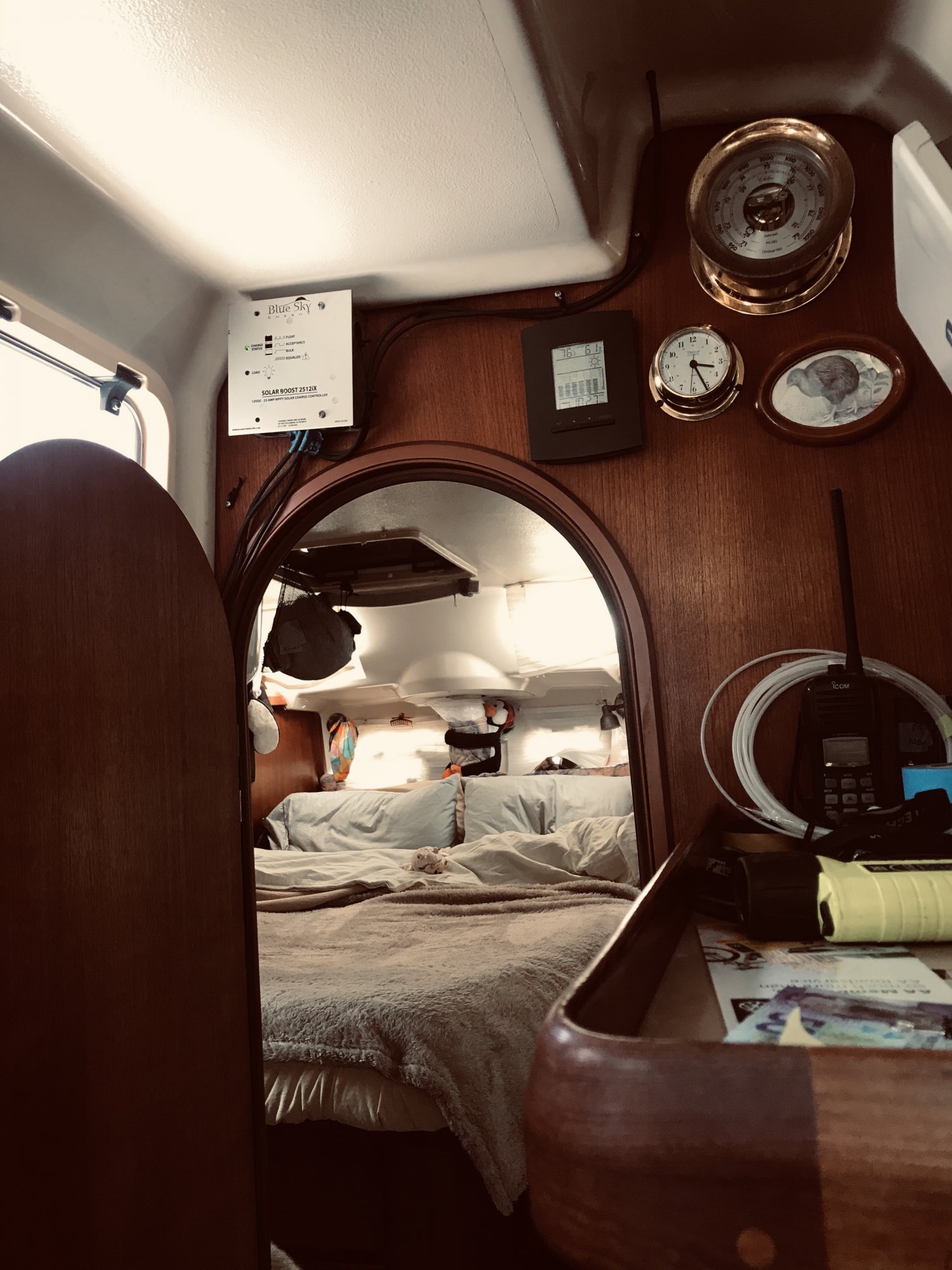

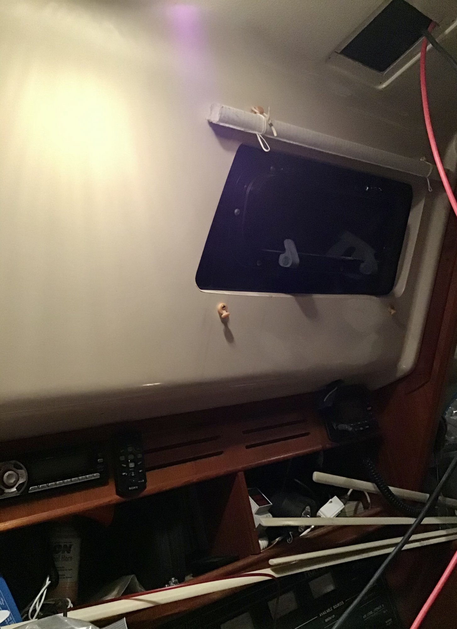

I plan to run the pair of 8 gauge wires down the forward, port support post and in through the air scoop. So far i have the wires through the scoop and appearing at the nearest access port in the ceiling. This is probably a P42 specific question, but I am running into some difficulty fishing the wires from that port (above the right side of the nav station) to the shelf above the electrical breaker panel. It is only a two foot run, but the path is eluding me. Ideas here would be appreciated, as with any other component of this project.
The objective is to get the cables at the top right to the Victron controller at bottom left.

Paul, I see your panels are mounted laterally. I assume they are wired in parallel to reduce the effect of a shaded panel on the overall system output. My thinking is that if they are mounted longitudinally, the mast or boom will shade one side or the other, leaving 300 of the 600 watts fully exposed. Comments? Experience?
How many watts are your panels rated at and what is your experience with actual wattage delivered?

I've never run any wires through the spot you are looking at, so unfortunately I'm of no help there. I ran all of my solar panel wires through the already existing wire feed that starts up at the port side stereo speaker (on the arch) and runs down through that arch pipe. It terminates at the access hole that is forward-most on the port side of the aft cabin. I then ran the wires from there (between the deck and the headliner with other wires) to a hole I drilled, and then on to the Blue Sky solar controller that I mounted right on the bulkhead. I STILL plan to clean up those wires and make it all pretty (someday). I would have loved to put the controller in the engine compartment, but I know they don't like heat.
Good luck with your project!!
Yes, they are wired in parallel. I have found over time that the boom rarely shades the panels at all. When I'm at my berth I pull the boom to the side and there is no shading. At anchor I just adjust accordingly and we do fine. It generally puts out all the power we need. (I ought to include here that our average electrical needs are about 125 amp-hours per 24 hour period. The panels regularly provide all we need over a three-to-five-day anchoring period until we motor out of the anchorage to a new place.
I really don't remember the ratings for the panels, but I can probably find that info somewhere. Right now we're provisioning and preparing for a 50 mile passage tomorrow (to Great Barrier Island), so I'm a bit too busy to look that up right now. But soon. And I also don't know what wattage is actually delivered other than what I noted above. But for long periods of the day when it's sunny we'll get 15-16 amps coming into the battery bank. I couldn't be happier with the setup.
Like you, I originally wanted a third panel. But after I ran with the double panel setup for a bit I realized I had no need for it. As it is my generator is (figuratively) mothballed. My experience was the same when cruising the tropics (Tonga/Fiji/Vanuatu) or cruising New Zealand.

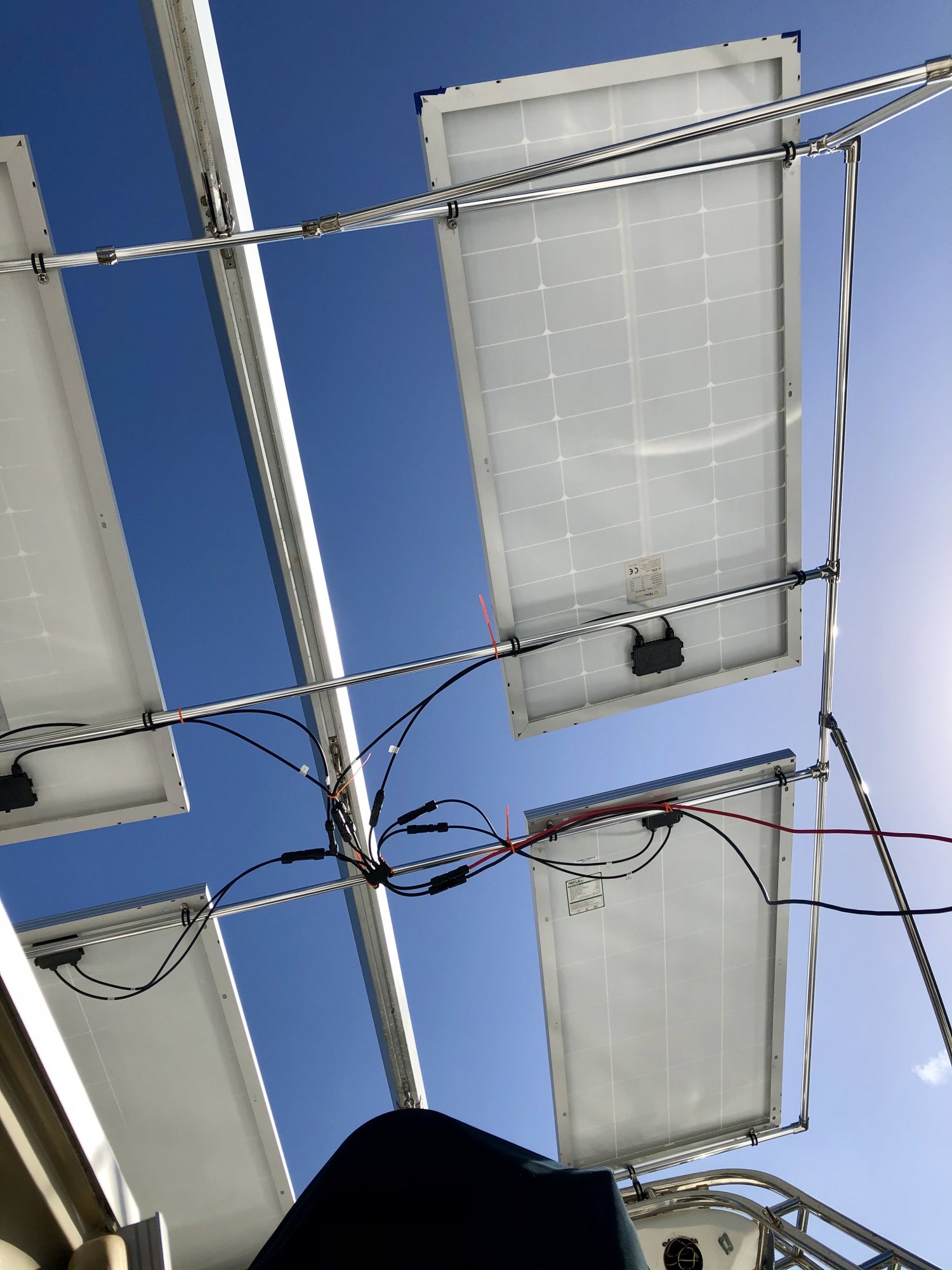

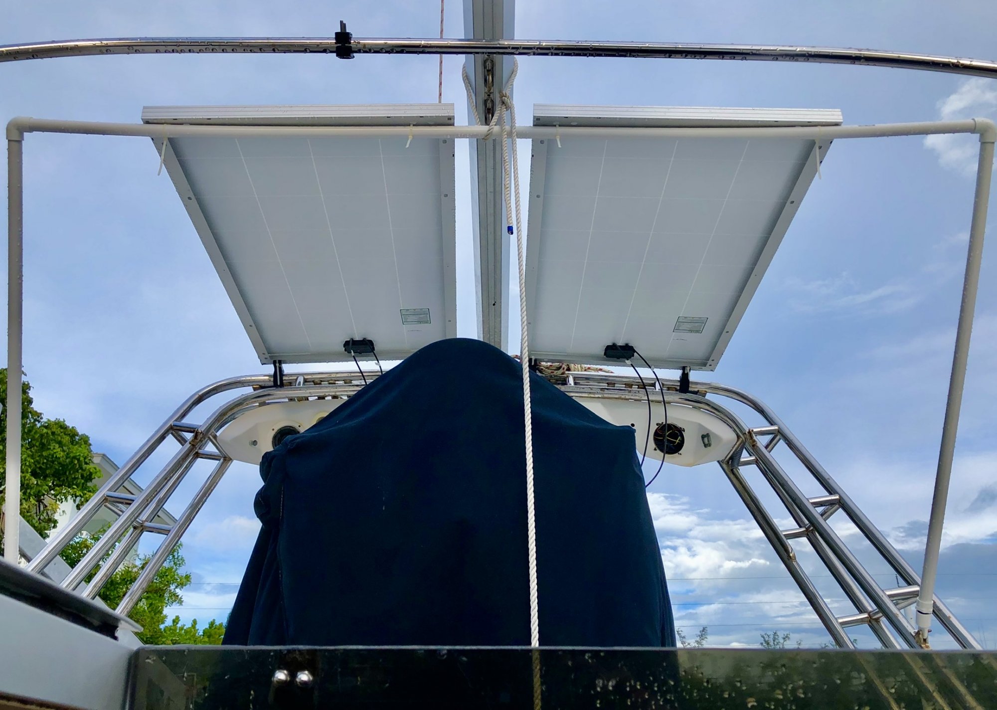

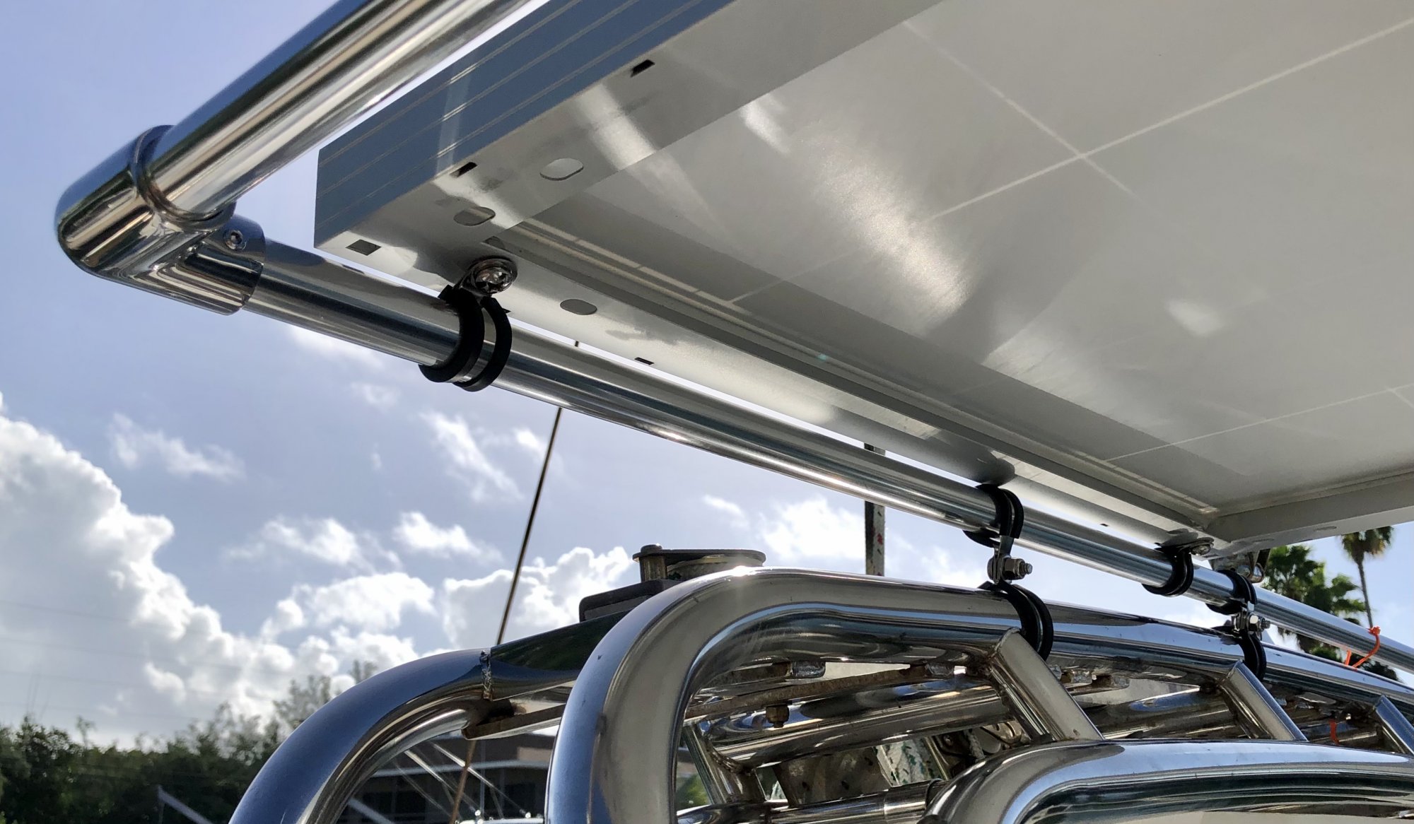

As promised, here is the second prototype. The two forward panels are Newpowa mono 150w and the aft panels are HQST 150w poly. Price was equal, and I wanted to see if there was any difference. So far the biggest difference is the number of mounting holes. I will have to drill the Newpowa because it only has three holes on each long side and none on the short edges.
There is some sag in the middle and I am thinking that a slight upward curve in the lateral tubes should help.
Just got the electrical patched together last night. At an hour and a half after sunrise this morning I was getting over 100 watts and charging at 7 amps for “free”. Yes, I know, many of you are thinking, “Next he’ll discover indoor plumbing”. It’s still a kick to see it in real life (i.e. our life) for the first time.
