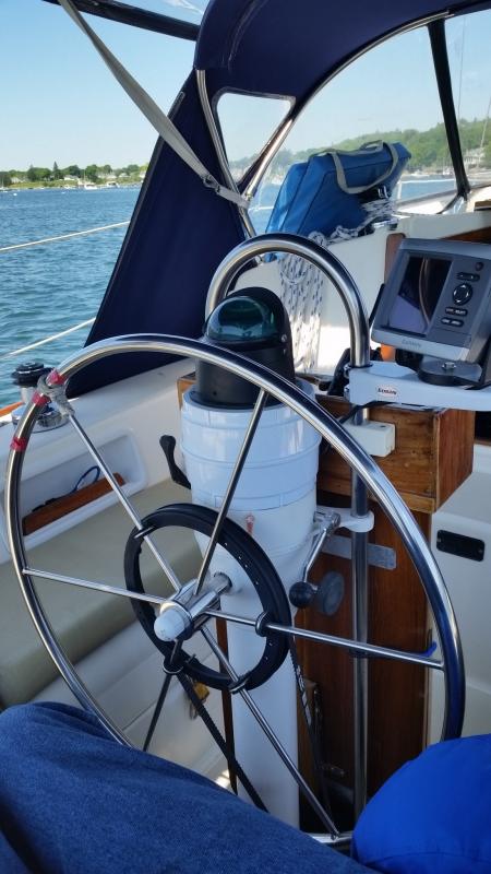

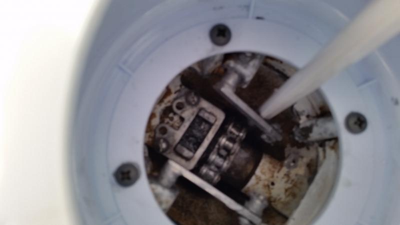

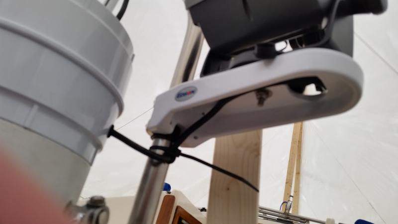

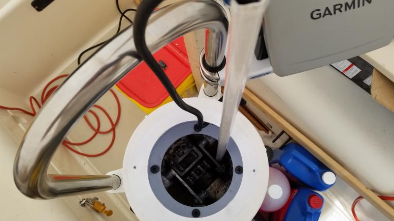

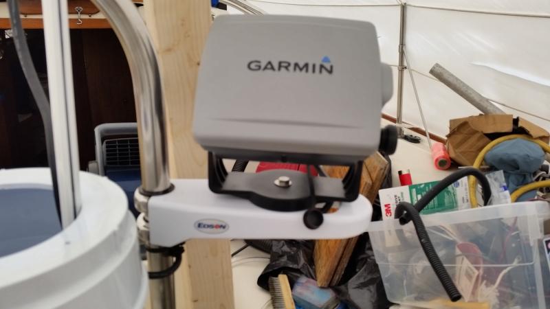

Just installed my new GPS Garmin 441S on my Edson Pedestal. The problem I had was what to do with the cable wiring! Do I drill a hole into my railing and fight the snake? So after taking my compass off I could see room in there but needed a clean protected shot down the side along the chain to make sure the cable didn't rub on the chain. To do this I used cheap plastic(PVC) pipe the diameter of my cable and it fit great! Put one hole in the side for the barrel to go into the pedestal and piped down below for a clean wiring to power. Here's some pictures..
