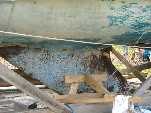

I'm rehabbing a 1971 p-26 from the ground up. First project at hand was to remove bottom paint and see what i have and to look at the seal joint between keel and fiberglass bottom. Looking at the rust build up on keel bolts it time to replace them. Any ideal on located the bolts?

Looks like the keel bolts need replacement on our 76 p26. Rust is weeping from thin crack line on side of keel/hull joint. Can the bolts be cut off and driven through one at a time. Seen mention of it, but not from anyone who as actually had it done. Thanks in advance,

I remove one of the bolts and found thread showing, nuts are almost rusted off. I needed to replace all bolts, and to replace my lighting/Electrical ground plane to the keel. I'm in search for the bolts. Do any one know were to find stainless taper head 5/8" x 3" bolts?

I just remove one, on the keel side they are cover up with body filler and the bolts are bury under there. I clean the filler out and ground of the nut nut and drove the bolt out. Now in search for new one

Thank you ShadyLady! Appreciate the pictures. You said you need to replace all bolts, but have replaced one so far? You gouged out the filler on the keel covering the bolt head and after removing the nut, drove it through? Any more info appreciated.

Thank you Shadylady. Mission Accomplished! Pounded out 4 bolts and replaced them with the new McMaster-Carr replacements. The other 4 bolts were OK and replaced the rusted nuts. Pounding out the bolts was a huge pain except for the front bolt, which turned out to be fairly loose once we got it started and may be the root cause of the problem. The front bolt was rusted tight to the nut, but after a few shoves, the whole thing spun.
