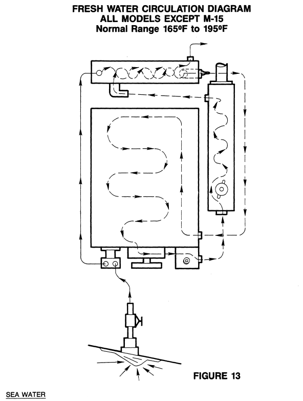

I don't think the raw water is affected by the thermostat. Only the coolant.
FRESH WATER CIRCULATION DIAGRAM
ALL MODELS EXCEPT M-15
Normal Range 165F to 195F
Sorry, I can't get the diagram to print here. Attached is a PDF.
FIGURE 13
1. Sea water enters through sea water inlet,
2. Through sea water valve when open,
3. Through sea water pump into heat exchanger to cool fresh water system,
4. From heat exchanger to sea water overboard through exhaust port.
FRESH WATER
1. Coolant (fresh water with antifreeze) is introduced into the system from the coolant section of
exhaust manifold by removing pressure cap and filling manifold tank to within one inch of
lower rim of fill port.
2. Fresh water engine driven circulating pump moves coolant from heat exchanger through
engine block circulating pump and thermostat back through exhaust manifold into heat exchanger
to be cooled.
The manifold serves as the engine expansion tank to allow for expansion of coolant as it is
heated. You also fill the system at this point. In some cases when hot water heaters are installed
an expansion or surge tank may be required to prevent air from entering the system.
Should your engine overheat, first check coolant level to make sure it is not low which would
cause air locks to develop. If air does enter the system, it may require a couple of fillings to
remove the air pocket. A momentary increase of engine R.P.M. to approximately 2800 to
3000 R.P.M. may aid in moving the air from the system. In some cases it may require doing
this 2 or 3 times. Do this just as you notice the temperature starting to rise above normal.
Here is that pic;

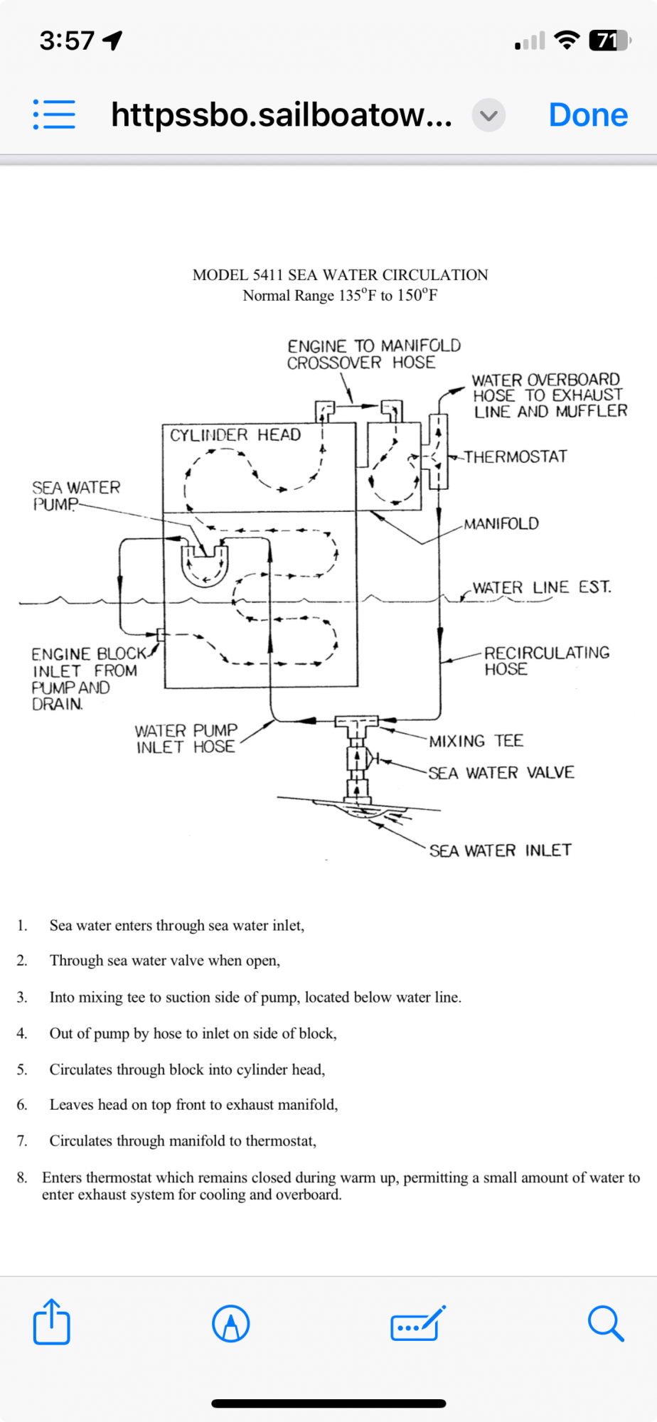

I have a rebuilt universal diesel 5411 in 1983 Catalina C30 mk1.
When my ignition key is off and the engine is running the temperature gauge is off and will show the temperature about 190 to 200 degrees.
I don’t know why I turned the key off that day. Must’ve been a short between the headphones.
There is a small hole in the thermostat housing that allows a small amount of water to flow through the exhaust outlet until the engine reaches 135 and opens the thermostat. Until then, the water flows through and back into the cooling water pump and not out the exhaust system.
I know you said you have an M12 and I don’t really know the difference so I don’t know if this really helps.
