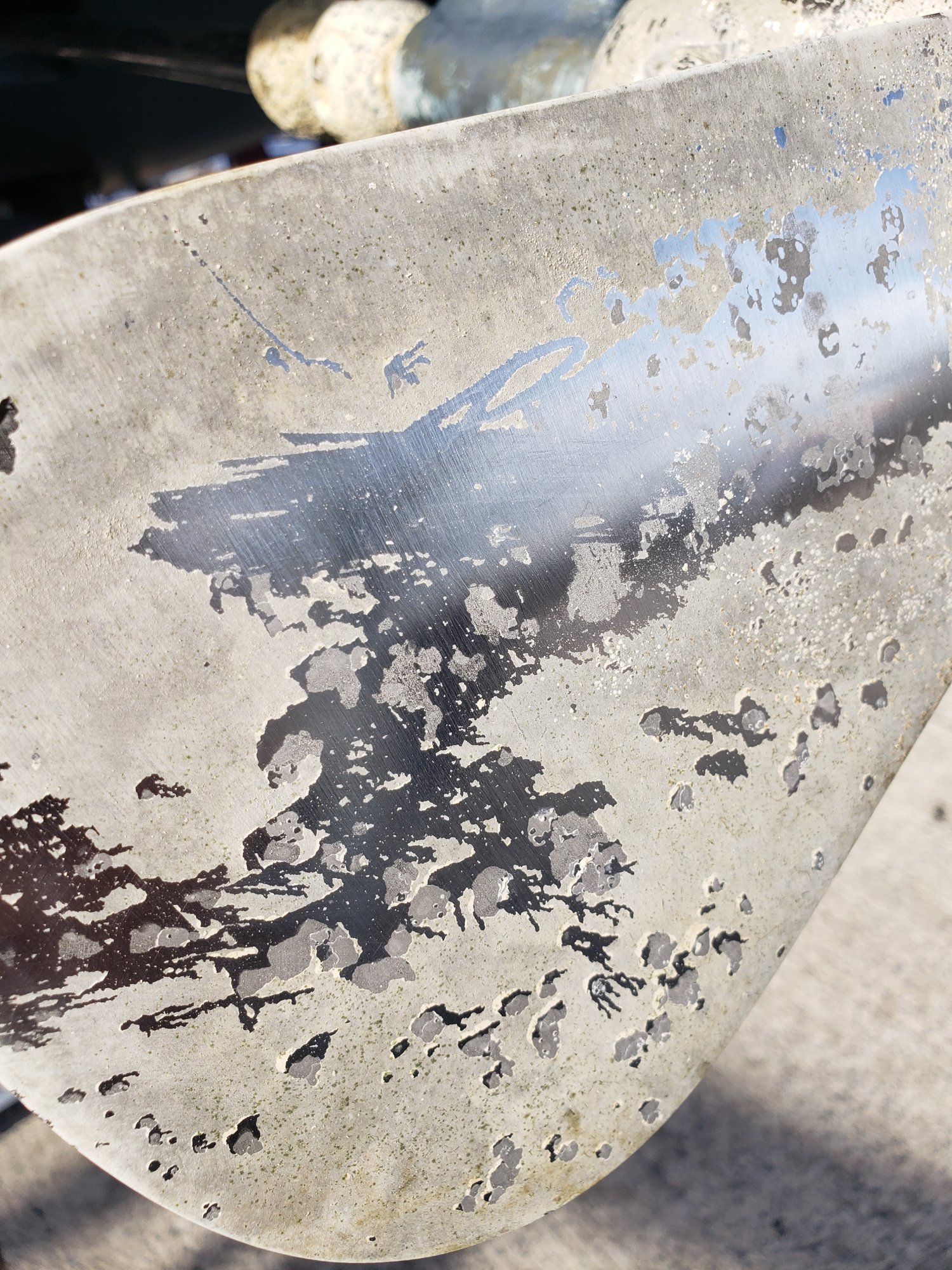

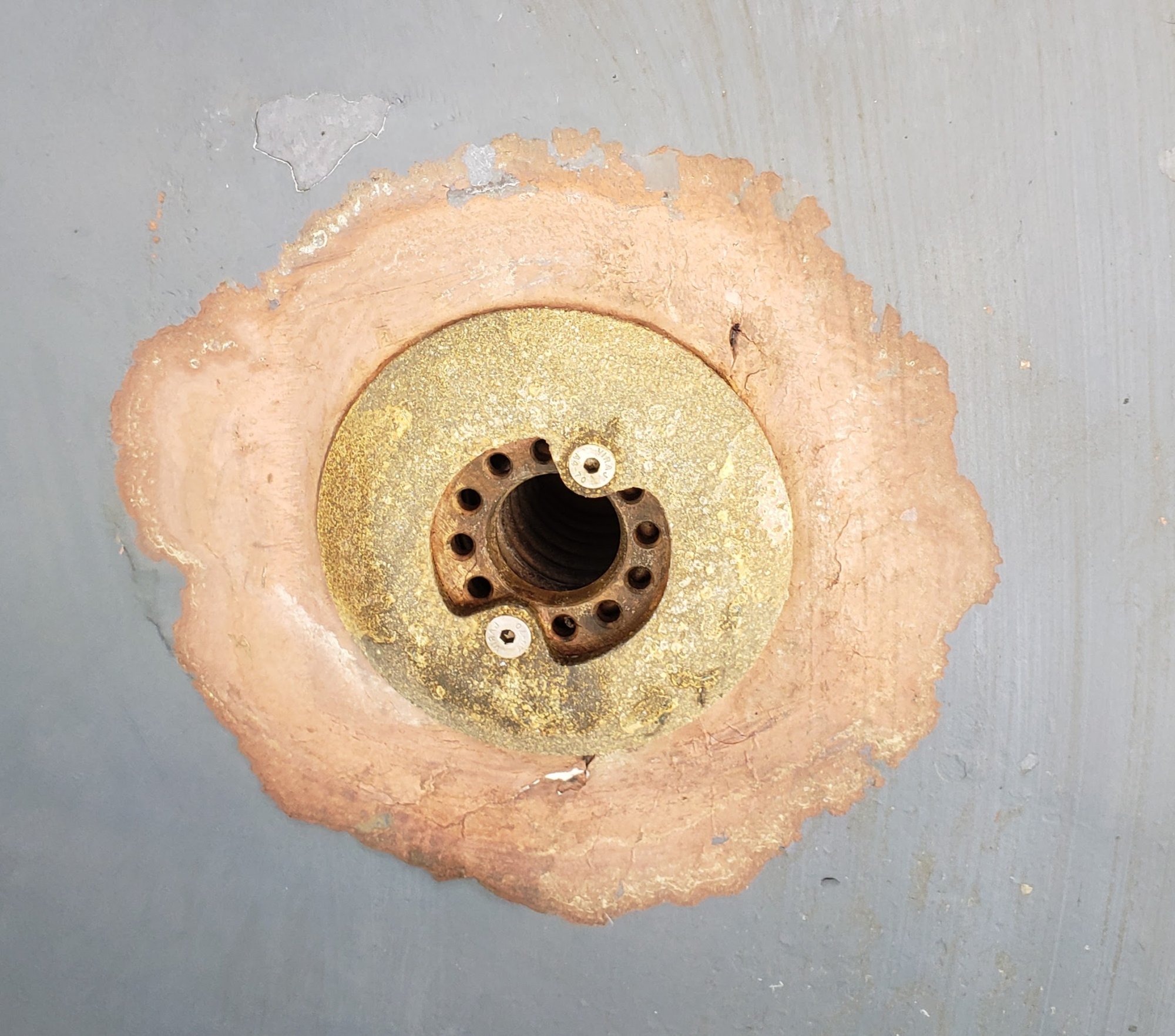

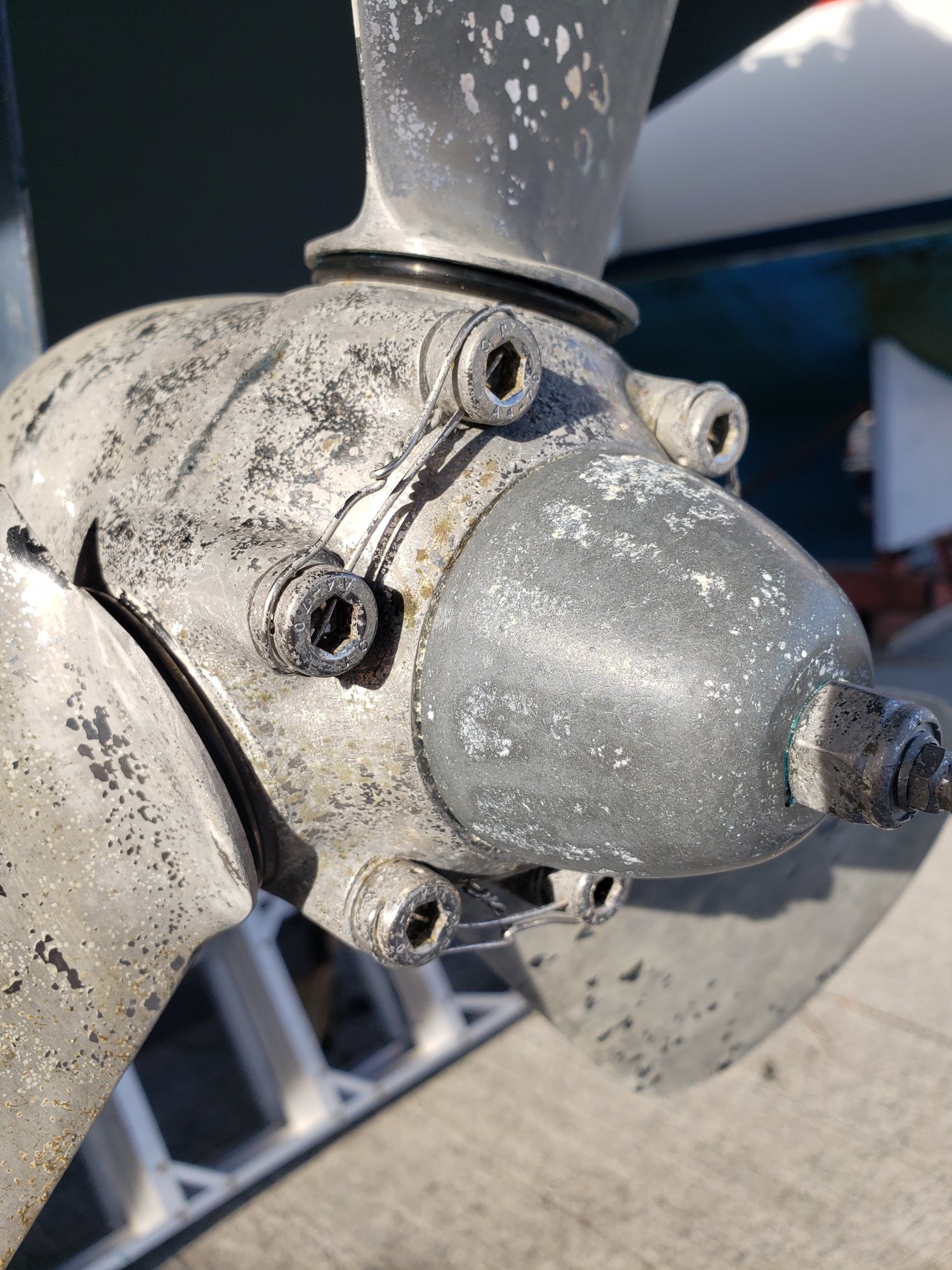

Attached is a picture on the only bronze through-hull on my boat that shows a "halo". Also some picture of my propeller showing the "scale" that builds up.

  • This only bronze thru-hull comes with a zinc (in the picture). It's an Isotherm SP heat exchanger thru-hull where they provide a custom zinc
  • It may be electrically connected to the re-frigeration system by the refrigerant piping (I've haven't tested)

  • On the propeller shaft I have two magensium anodes and the propeller comes with a nose cone zinc.

  • Halo on the one thru-hull (I saw a lesser version last year, but not sure about previous years as the Isothem thru-hull is relatively new.
  • Some mild erosion of the zinc on this thru-hull

  • virtually no erosion of the propeller zinc (still smooth and dark grey)
  • BUT, the propeller and shaft are covered with a matt scale/coating. It's a little blotchy, but that seems due to places where there has been a little bit of marine growth preventing the scale build up.
  • This has happened for multiple years (but I've had two magnesiums on the shaft for a number of years too)
  • This coating can be removed by mild scraping with a metal paint scraper, or with use of scotch-brite and some elbow grease.

Yes, that halo is caused by excessive over-voltage, but the cause could be either stray current or over reactive anodes.

The white coating on the shaft and prop is magnesium oxide. Not an issue it is the sacrificial magnesium anode doing its job.
If the anode on the thru hull is indeed zinc, it is worthless. In freshwater zinc forms a hard coating that electrically isolates it from the water.
The anode on the prop looks too good, is it magnesium or zinc? If it is aluminum or magnesium there should be some erosion.
I just saw an article on "Haloing" I think it was by Steve D'Antonio, just can't remember where I saw it. That is what you have around the thru hull. You might try searching for the article.
  • Magnesium Oxide: check - this is what I was assuming
  • thru-hull and prop anode: both are zinc (shaft anodes are magnesium), The prop anode has NO degradation, but the thru-hull anode does have some, comensurate to the Magnesiums on the prop shaft
  • I'm seeing about getting 3rd party non-zinc anodes for the prop (Aluminum seems to be the only other alternative)
