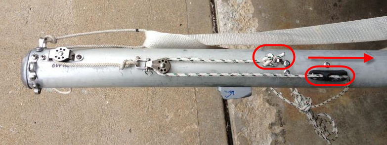

Can anyone help with routing my Outhaul? First time setting up my '81 C22. Not sure what previous own had set up, but I'm a rookie and it easy to confuse me. I'll try to attach pictures of both sides of my boom (having trouble adding two pictures, but I'll keep trying)

The outhaul on the C-22 from the factory is pretty weak. The eye straps and the cheek block in your photos is part of the reefing system. There is some good information on outhauls the racers have developed in the C-22 Tech Manual. My out haul is another design inspired by someone else. It actually uses a gooseneck fitting on the rear of the boom and a couple turning blocks. Anyway, got off course as usual, but there should be a cleat on the port side of the boom maybe 3' or so from the rear. The outhaul line simply goes from the clew of the sail through the little pulley on the top rear of the boom, and back to the cleat to secure it.

Thanks for the input. I noticed in your photo that you had a strap that led from the clew to the boom slot. I don't have any such device, just loose footed to the Outhaul. Should I install one? What would I call it?
Don, why not just run the outhaul line through the SS eye at the clew, and loose all the stainless? Less weight, less to go wrong, and basically the same amount of friction.

Here were a couple ideas I saved a while back:

That's not what I have. The images I posted were of outhauls I was thinking about using, just pics I found in the past and saved.

My mainsail is a full batten, loose footed sail. No boltrope along the foot, the sail only attaches on the bottom at the gooseneck and at the outhaul you see. The slug keeps it in place and prevents it from raising up. The loose footed main gives you much more adjustment potential, and the full battens give a nice sail shape, and the sail doesn't whip like a flag. Plus, the full battens make it so easy to roll the sail up when I'm done for the day, which is a better way to store the sail.

You could go simple and just use the block on the top with line from sail through it and back to one of the cleats you have , can get fancy later after you get wet a few times and figure out what you want.

Gene - wow, what a pleasant surprise it was to see a picture of my old boom/outhaul! It worked great except if I did it again, I would move the cleat and fixed attachment farther down the boom with longer lines for more adjustment potential.
Ah, so you're the genius behind that pic! :biggrin:
What I have now is basically the outboard half, with the solid white line running straight from the cheek block to the clam cleat.
