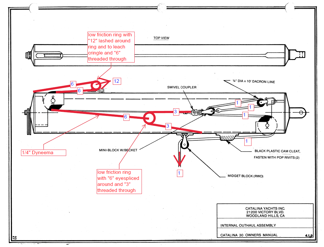

On my Catalina 30 I increased the purchase from the pothetic 3:1 to 12:1 by using two single blocks as cascades. One was at the end of the internal 3:1 tackle and the other was on the outhaul car. Works great and make trimming the foot effortless.

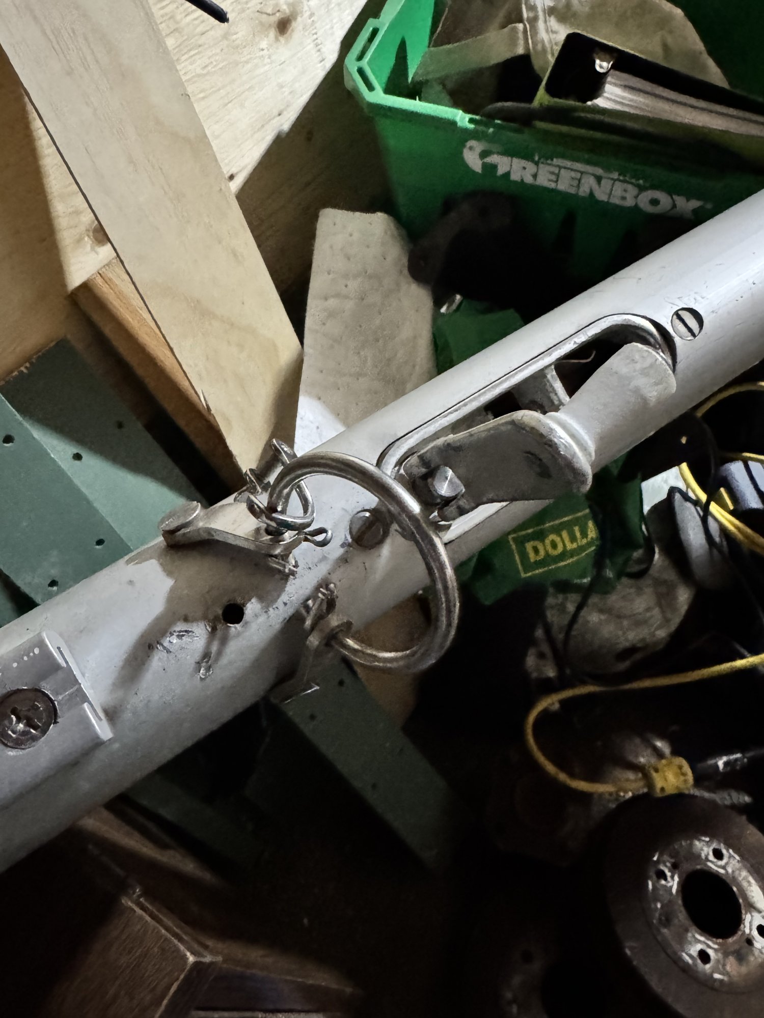

I can’t seem to upload my pictures, all taken with my iPhone, the system says they are too big any ideas how to do it?
May 1, 2011
5,262
Pearson 37 Lusby MD
Text the photos to yourself - that will reduce the resolution. Then save the images with a new filename and try uploading those.
