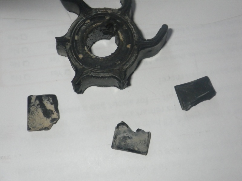

A good stream out of the pee hole is not always a reliable indication. I had a quite good stream, but when I disassembled the lower unit, this is what the impeller looked like. Luckily all the pieces were in the housing.
I'm beginning to maintain a hour log, and will change after a year first time, then decide.
