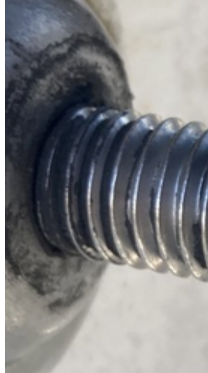

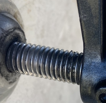

It looks like theres some dirt on those threads which could be the reason why you're having issues. Try Kroil or acetone/ATF as a penetrating oil once a day over the course of a week
Also, is modifying the mount it's bolted to an option? An oscilating tool might be able shave away enough plastic to get it off

Don't forget to try lubricating the joint between the "bolt" and the "foot"
The threads near the handle definitely look warped. I would also suggest having someone push and pull forward and back on the lower end as you try to turn the handles as this might relieve some pressure. I'm guessing this is hanging off of a stern rail and not a boat? If so, I'd look at getting a saw blade between the plastic of the mount and that foot or heat up the foot to soften the plastic (the outboard will push into the plastic and thus relieving pressure). It's easier and cheaper to replace the mount than parts on the outboard
Excellent point. That large diameter pad requires a large turning moment to rotate it if it's frozen at that point.
Got to wonder if it's more the effect of the camera. Even if a little warped, I'd expect sooooooome turning of the threaded bolt. I'd still say it's galled, but good.
