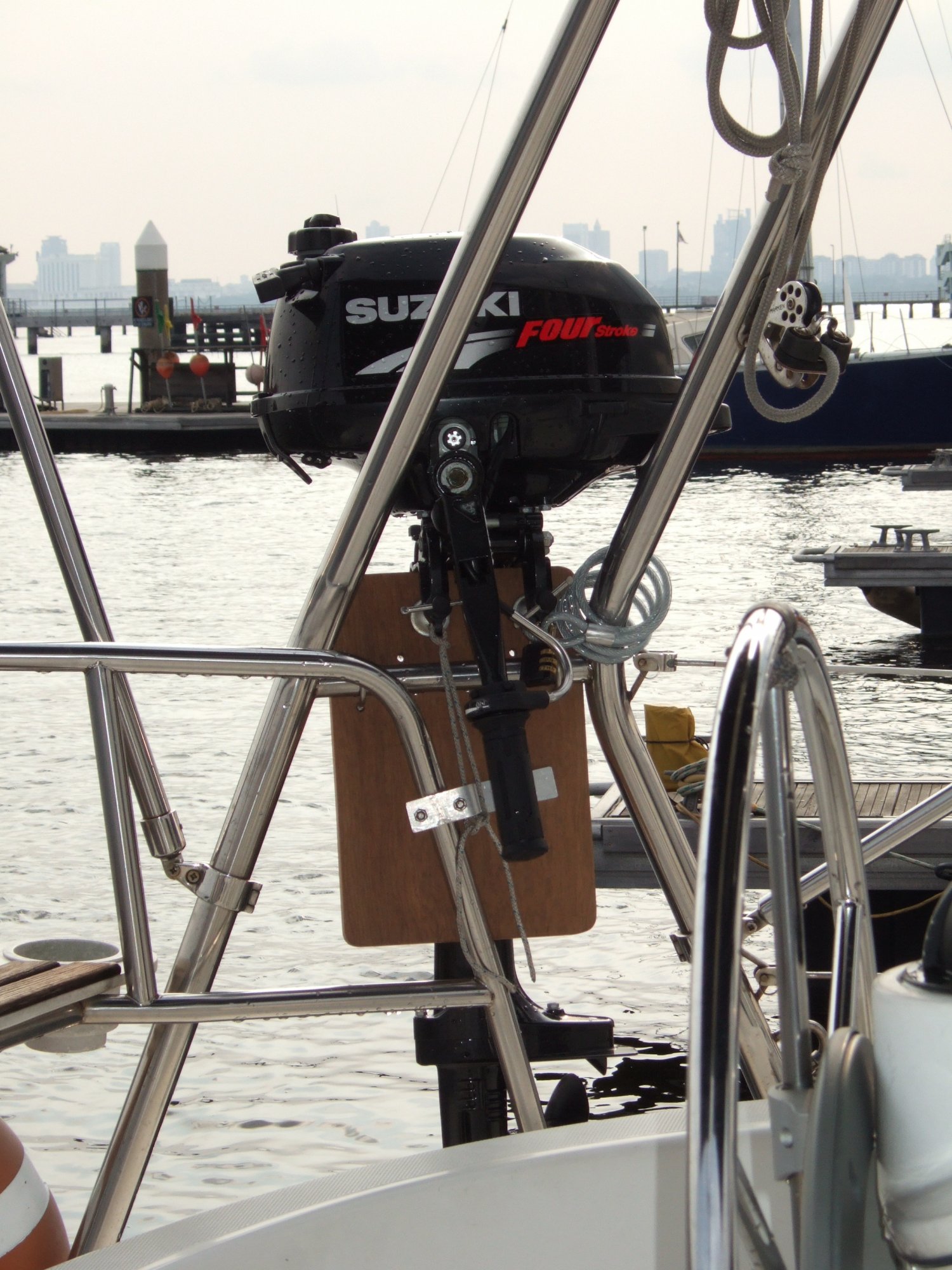

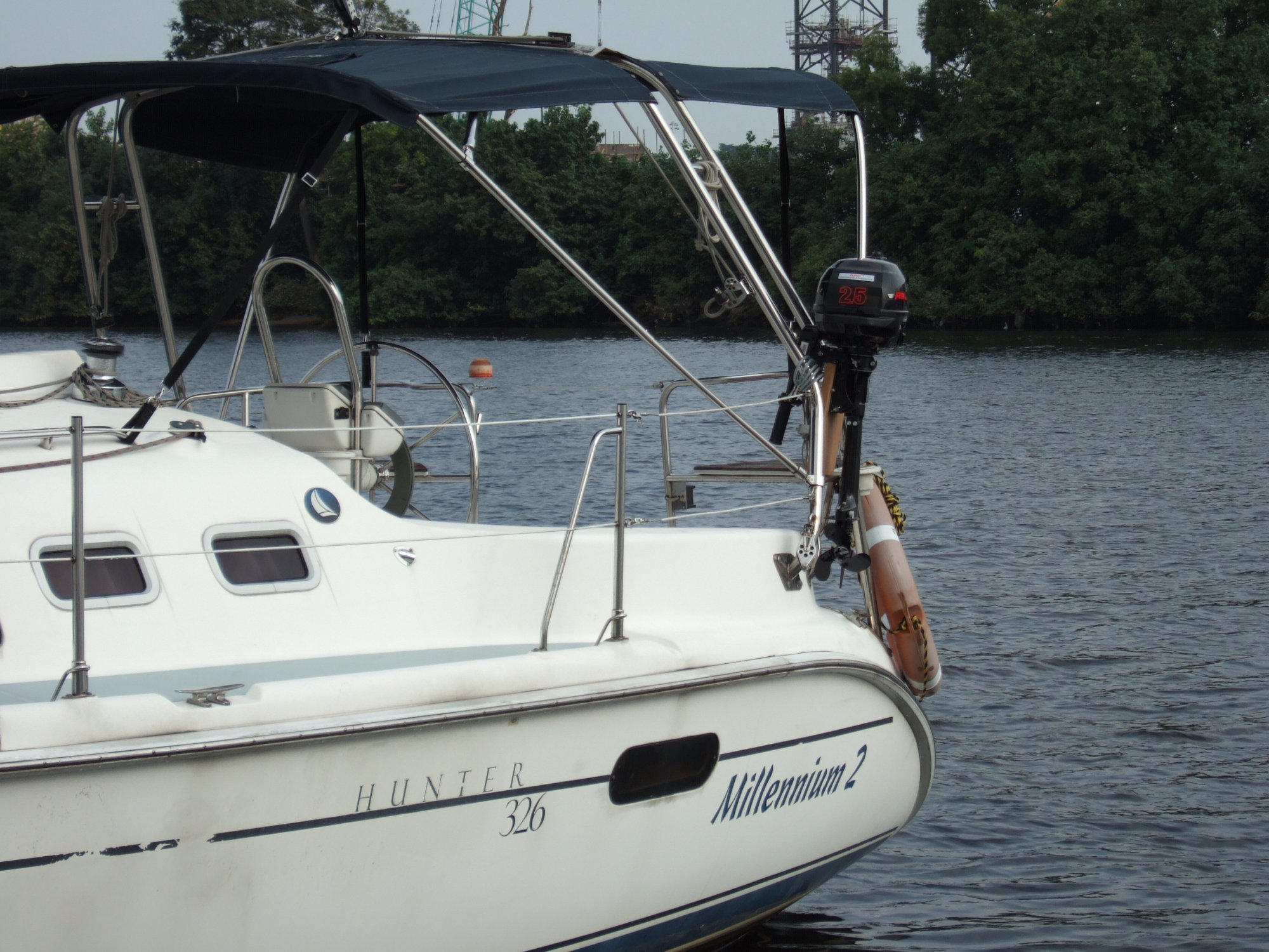

I have a 15hp on my arch it where I've kept the engine for years. leave the lift connected most of the time. Oak or teak board with 3 u bolts .

I use a suitable sized wooden kitchen chopping board and mount with U-bolts and an aluminum strip as stand-off bracket.
