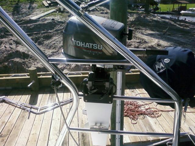

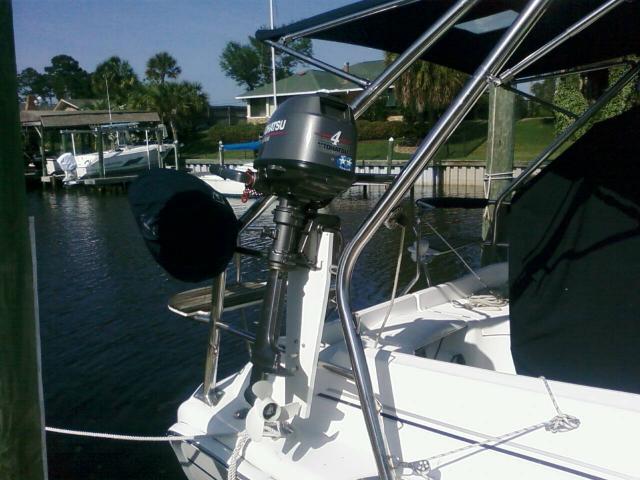

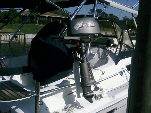

I used the 1 1/4 Edson on my 04 33. I'll get some pictures tonight and post them for you. Works great, have a Tohatsu 4HP 4 Stroke.

I used the Edson mount as well. Required a small notch cut in the rail seat but this was really not a big deal. The new 4-stroke outboards really are heavy and I felt that the Edson connecting to two spots on the rail provided a measure of security.
