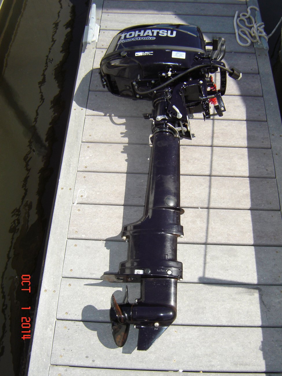

Tohatsu 4 stroke
sail pro 6 hp with long shaft and remote tank, has alternator for charging and shifter is on front. Literally sips gas too.
Get it fitted with the engine flush connector on front too, just attach garden hose and flush without those annoying flapper clips.

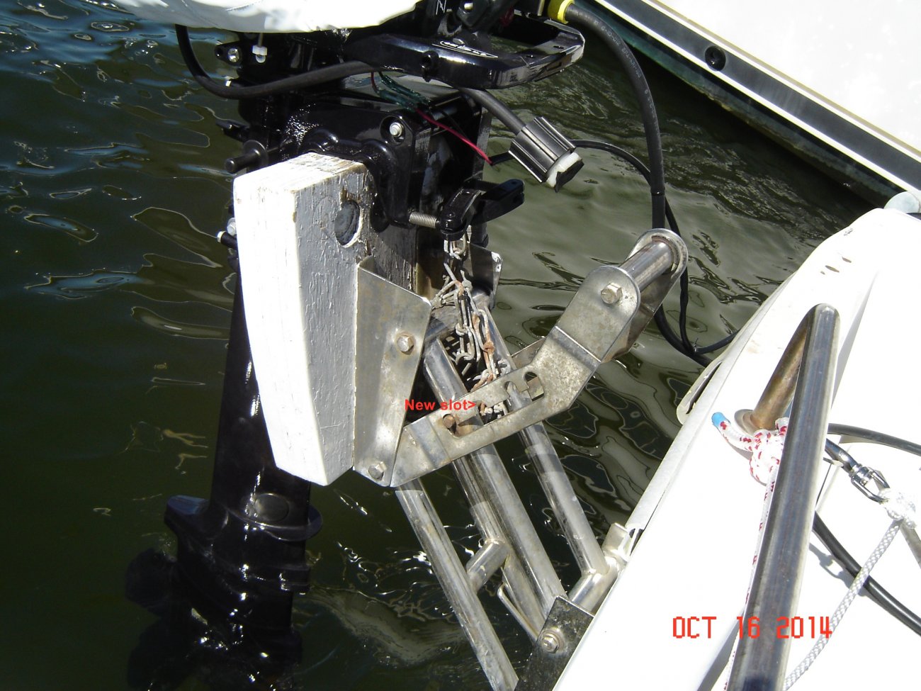

@Jacktar do you remember what brand the motor mount is and do you like it? I’d like to remount my merc 9.9 on one, but those rated for the four stroke jump the price from < $100 to over $300. At that much money it goes way down on the priority list.
In the picture it looks like you added a setting. What was the basis for that?
Thanks in advance.
Thanks in advance.
Jacktar & others, similar question, moving from 2 stroke 4.5hp to the Tohatsu 6hp sailpro....the original mount (84 model) is fine but concerned of the added weight. Mine has 2 springs, dockmate has same mount but with 4 springs (89 model), so my question is what I have sufficient?, can springs be added?, etc. Also plan on reinforcement inside transom, only bolts and washers there now....thoughts?

My motor mount was the original garelick on the boat when I got it from the PO. He had a 85 mercury on it which was the original outboard on the 83. It was 2 stroke and I had no problem putting the sail pro on it. The reason for the intermediate notch I created was that in the upper notch the 25" sits just in the water enough to operate and pump cooling water through it but the lowest notch actually put the bottom edge of the motor mount board at water level which caused drag and prop was way too low at that position. Rather than remount the whole motor mount to accommodate the longer shaft engine I just cut a pair of intermediate notches to put the engine in with prop far enough down not to cavitate when I went forward or when waves or wakes were excessive. No racing and surging then when operating in even extraordinary conditions.

How hard was it cutting those new notches in the motor mount Jacktar? I was thinking of the same thing - thinking I'd try to drill a small pilot hole, then about a 1/2" bit, then open up half of the hole to form the "U." It looks like it might be a pretty tough job though that way... you deserve a lot of credit for getting it done.
