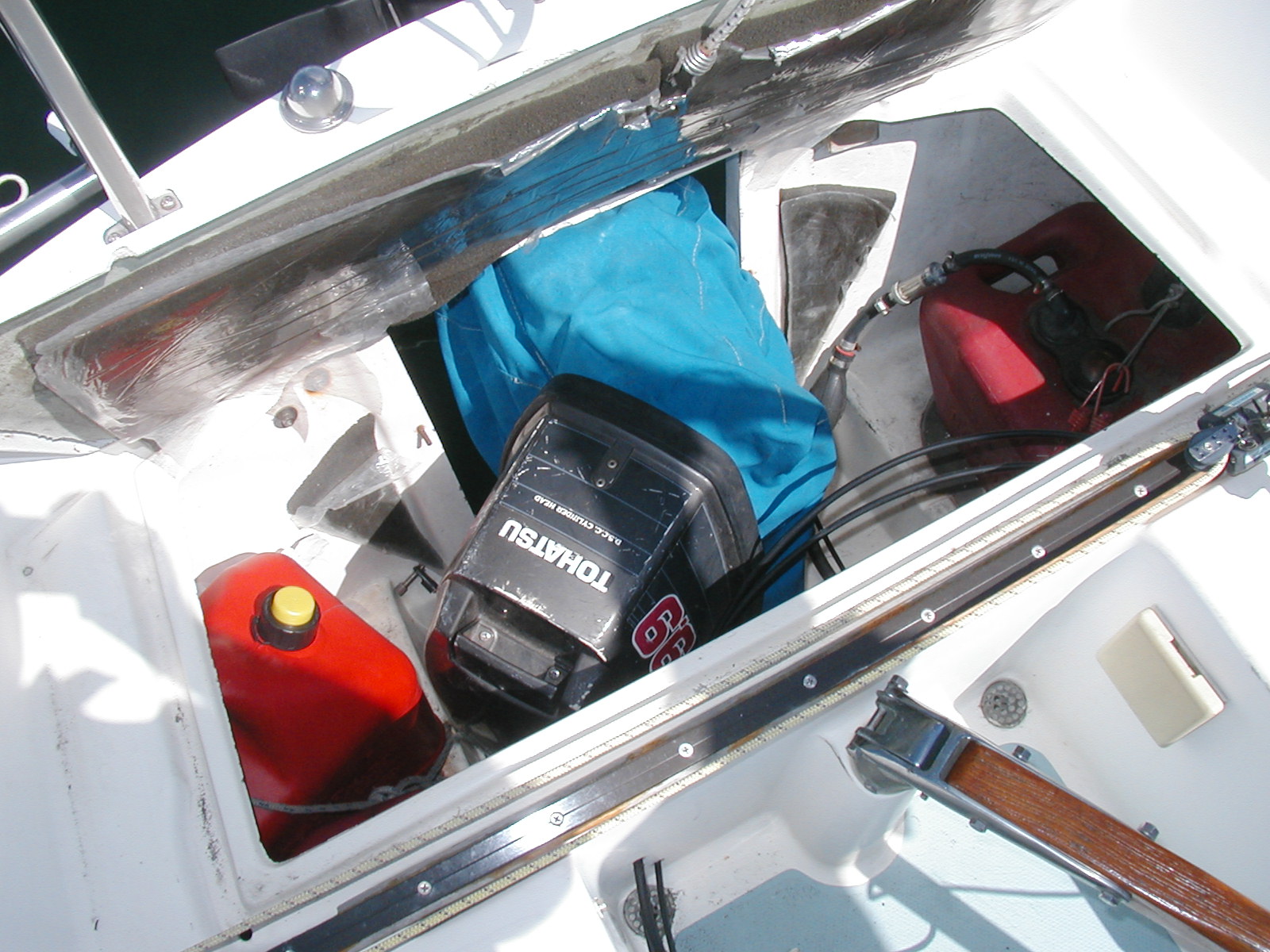

Years ago I had that mod on my project list... because I thought it was important to lift up the motor while sailing. Not so, I found out. Just treat the motor like it's an inboard. On this boat it's more important to have an electric start and remote box.... because its design makes a tiller arm very inconvenient. I have maximum tension on the shaft brake so it won't turn, and steer Impulse aug 04 008.jpg with the boat's rudder.
I sail with it down, in the water, in neutral. No issues. When I store it....I disconnect the fuel line and shift cable. run the gas out, remove the cowling and tilt the motor up... it fits neatly inside the transom... then cover it with a canvas hood.... which you can buy ready made for around $40.

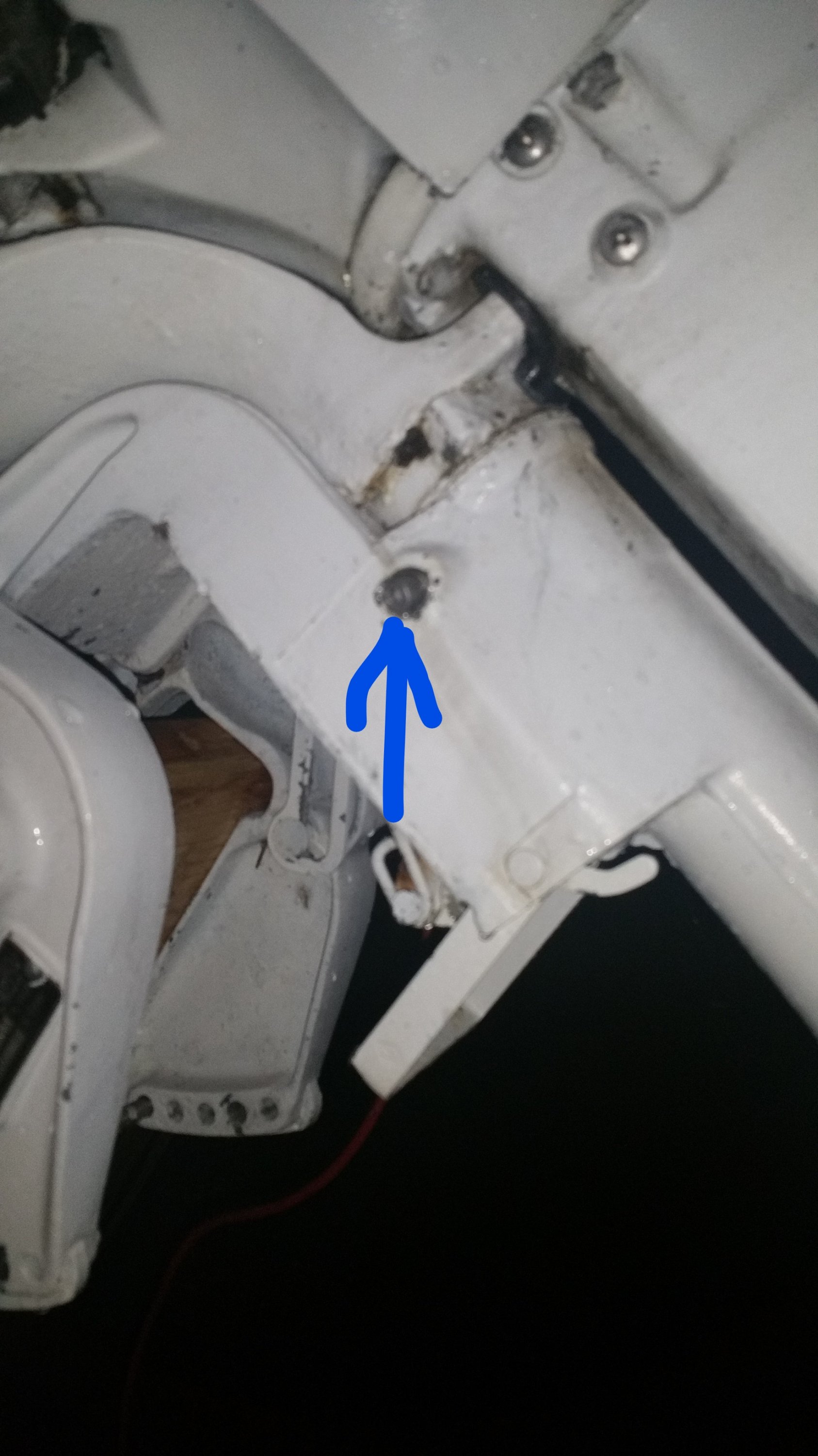

Well I got a chance to look at my 9.9 Evinrude and I couldn't find anything obvious for motor steering tension. I found this article online.
http://www.leeroysramblings.com/Johnson 9.9_15.htm
Way down at the bottom he mentions how to adjust the "Motor pivot tension" but he doesn't show a picture of which screw to adjust. I think he means this one on the left hand side of the lower unit.
