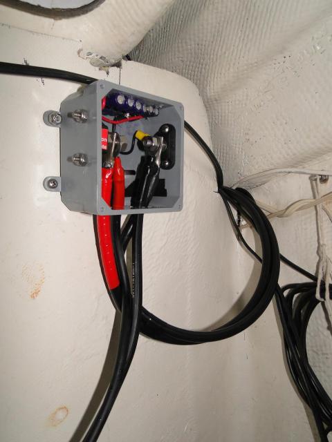

One comment regarding the 55 to 58 amp starter current I measured.
This web site http://www.bcae1.com/wire.htm shows a MAX fuse sizes per wire gauge. This fuse is sized to keep the wire from getting too hot and in our case, would be the fuse placed very close to the battery (specifically in the V berth in my case). This fuse should blow if there is a short to keep the wires from starting on fire.
From the web site, it lists 50 amp max fuse for 8 gauge and 125 amp for 4 gauge. But.. if I had a 50 amp fuse, I could have blown it starting the outboard (I saw peak of 58 amps).
While 8 gauge wire may start the outboard fine even with the long wire run (assuming the batteries are forward in the boat), the issue would seem to be the fuse to protect the wire from fire. I think four gauge wire and at least an 80 amp is better. I may go higher than 80 amp on the fuse.. blowing the fuse at a bad time - like drifting towards some rocks in high winds - would not be good.
Although.. you do have the backup option of starting the outboard the old fashion way - using the pull start..

I'm just going to wait and see what happens in our case. I don't have a fuse, but a breaker. It is easy to reset. I'll have to see if it trips or not and how the outboard sounds starting. I'll run a battery closer as a test. I might just move up to the #4 as now the generator along with the 120 watts of solar might start to be a problem also.
Thanks for checking the amps during starting. I appreciate that,
