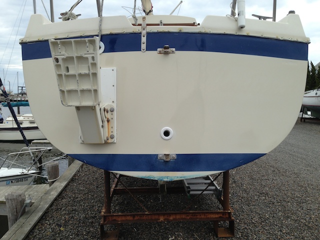

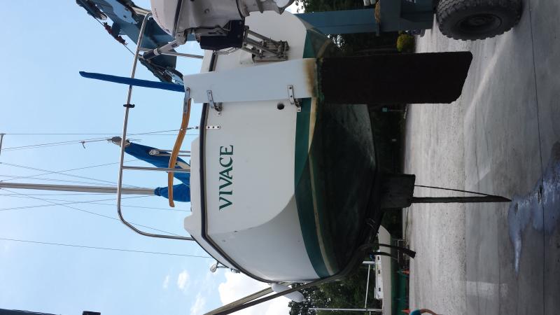

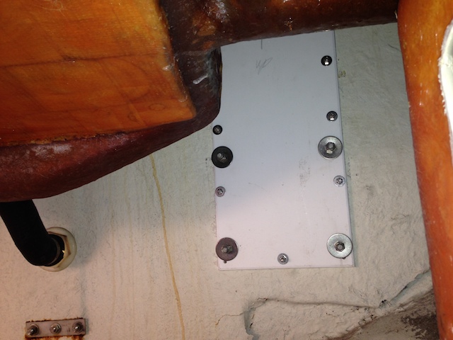

How did you mount the bracket to the transom?
Ward H
Nov 7, 2011
3,843
My 25 came with a 2001 T9.9 so I am guessing the mount was added at the same time. I have seen at least one other 25 with the same bracket, a OMC bracket, installed the same way.
The backing plates, both in and out, look to be 1/2" or 5/8" starboard. Adjustments in the bracket and OB allow the motor to be trimmed properly. The lack of any gel coat checking or cracking around the area indicates to me that there is no flexing and the mount is holding up well.
As a side note, the 2001 T9.9 had an electric choke which was a PIA so when it began having problems we replaced it. I looked at some other OBs but went with another Yamaha T9.9 which now has a manual choke.
Attached are a couple of photos.

My 1983 O'Day 25 has the motor mount on the other side. There is a wedge between the transom and the bracket. Were you able to match the wedge bolt holes with the bracket?
Jul 7, 2013
8
Oday 25 Severna park
It has a wedge, but it was like that when I bought it. So I'm assuming it's original or close to it.
