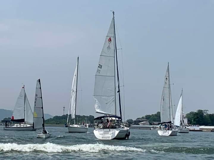

Out for 2nd race of the year. This is the 1st Mayor's Cup Race for Lake Guntersville. Start is tomorrow with 19 adult boats and unknown number of youth class. We took RoseLeigh over for meet and social hour, should be fun tomorrow
JRT
Feb 14, 2017
2,059
We survived the event. It was a very lite wind day and they ran both adult and youth class and same time. Was a bit tight as they also set a course in front of the city dock dining and entertainment area for more exposure. RoseLeigh did her thing and brought us home safe. They only announced top 3 in each class so not sure how we did but I think we were OK given the conditions. I believe it was 19 adult entry and 10 youth.

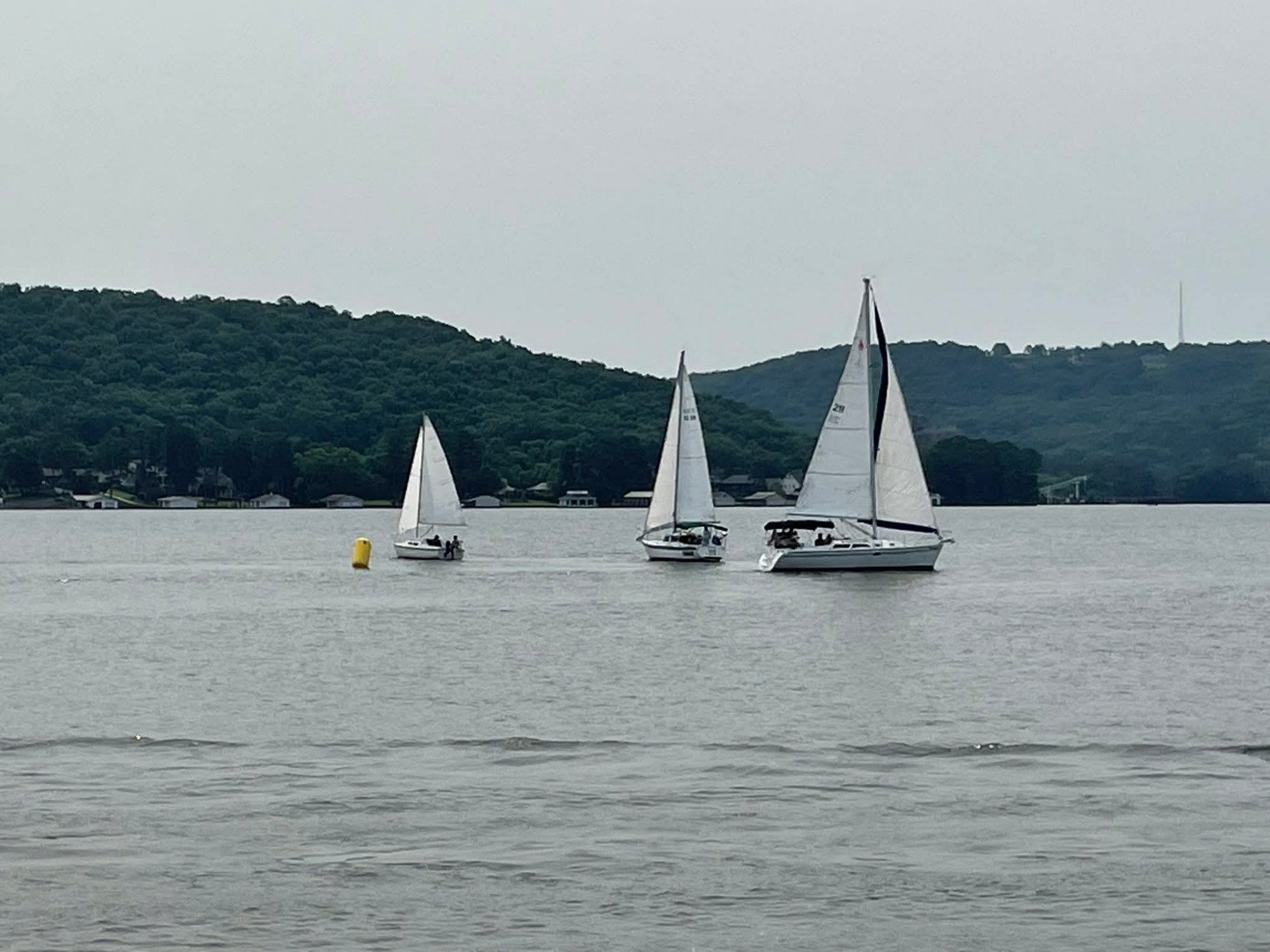

Final count was 23 adult boats in 1 class and 10 youth boats in one class. They only published the top 12 for some reason. Honestly it was a very big challenge that many boats in a relatively small area and a lot of us cruisers were just not able to do well because the area is amazingly squirrelly wind shifts. My friend, also a 310, who finished 11th, said he wasn't happy about the extreme mixing and hopes they make a cruiser group if they want the big boats to show up next year. I will probably do it anyway as I just like the challenge and practice. That said I had to avoid the opti kids several times and was genuinely worried about their safety
The course was basically in this area, designed to keep is in view of the harbor dining area, we had one marker in the river but 2 in the area between the 2 sides. Maybe I'm just not use to close sailing and small areas but sure felt very small.

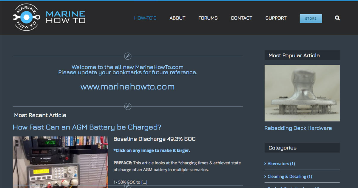

Why? Read Maine Sail's reasons:
AGM Batteries - Making The Choice (from Maine Sail)
AGM Battery Issues and the Blue Seas Dual Circuit Switch (from Maine Sail) "DARN AGM Batteries"
Darn AGM Batteries
Additional Observations on the Limits of AGMs Electrical Systems 101 - Page 3
