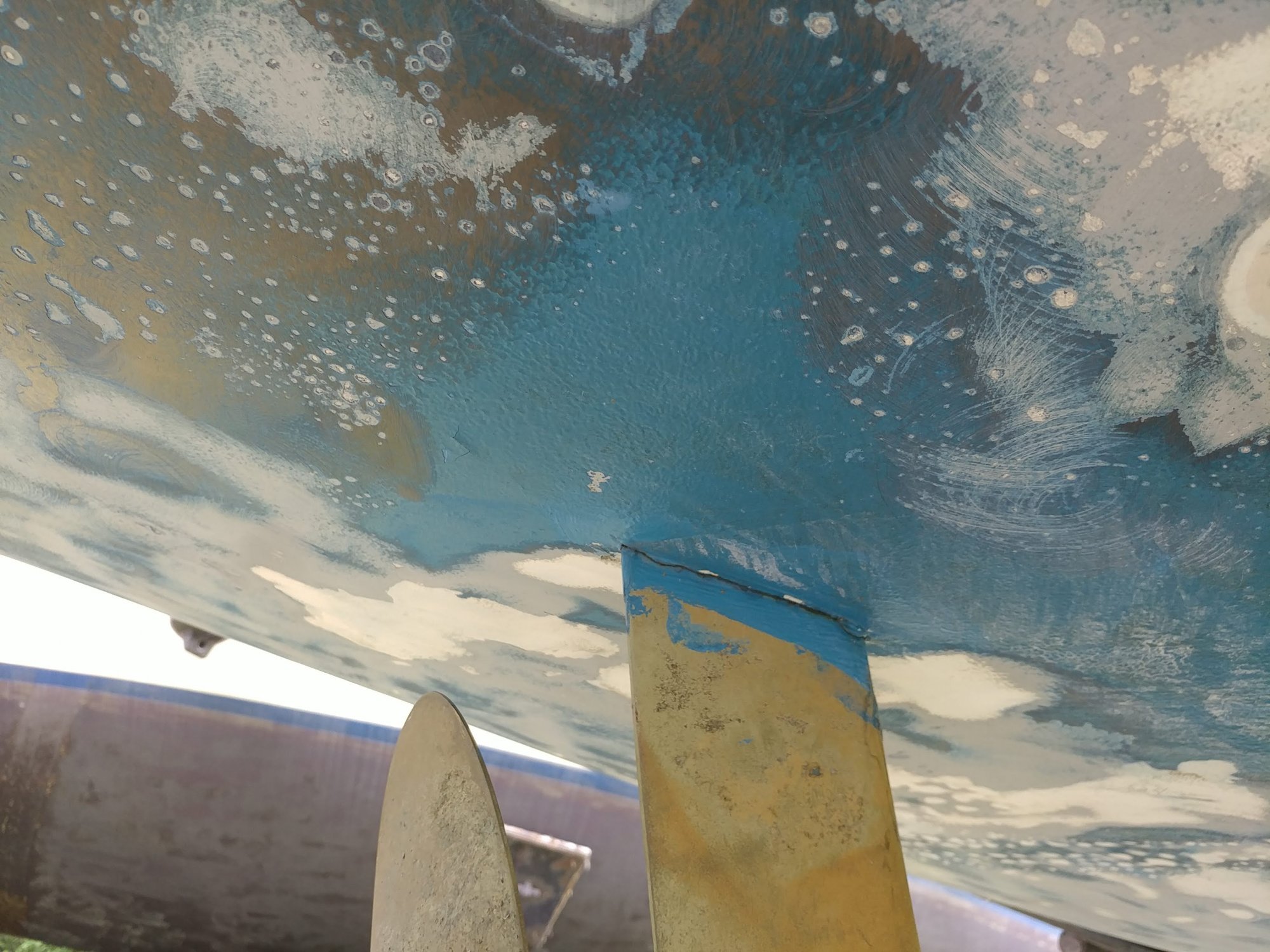

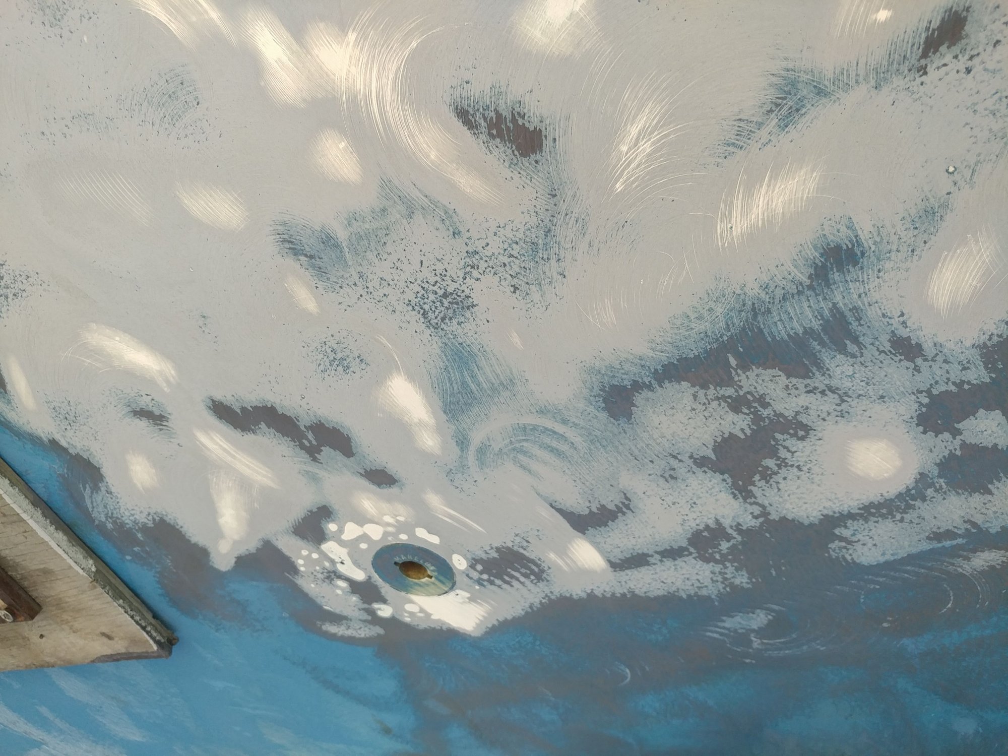

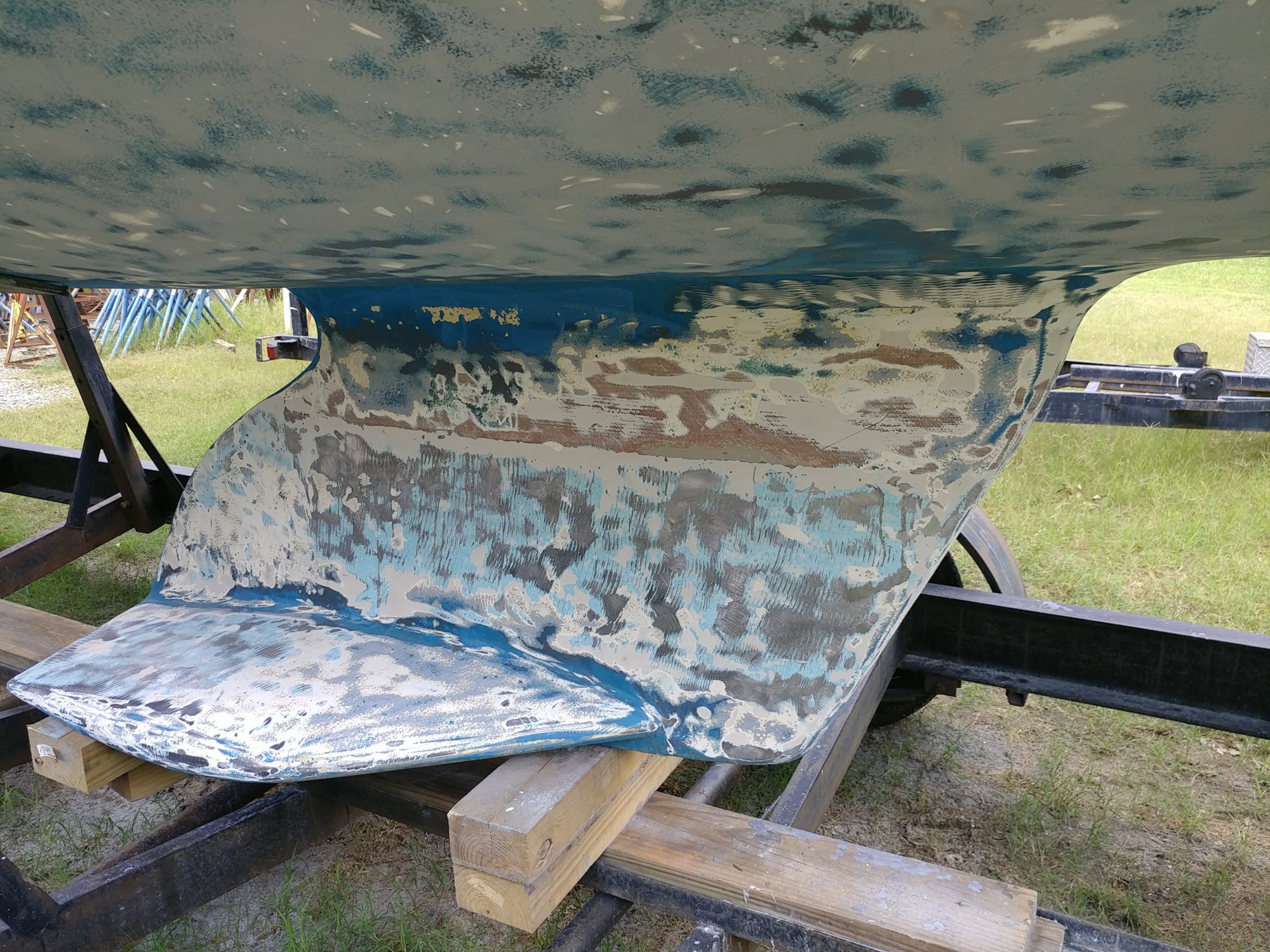

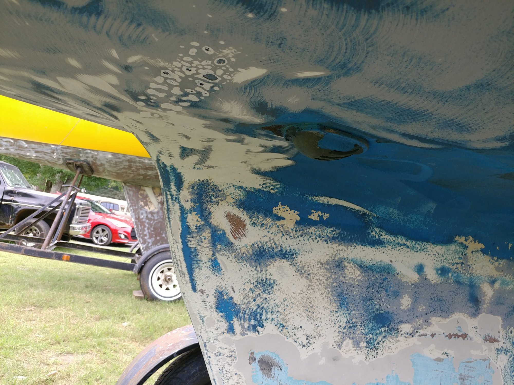

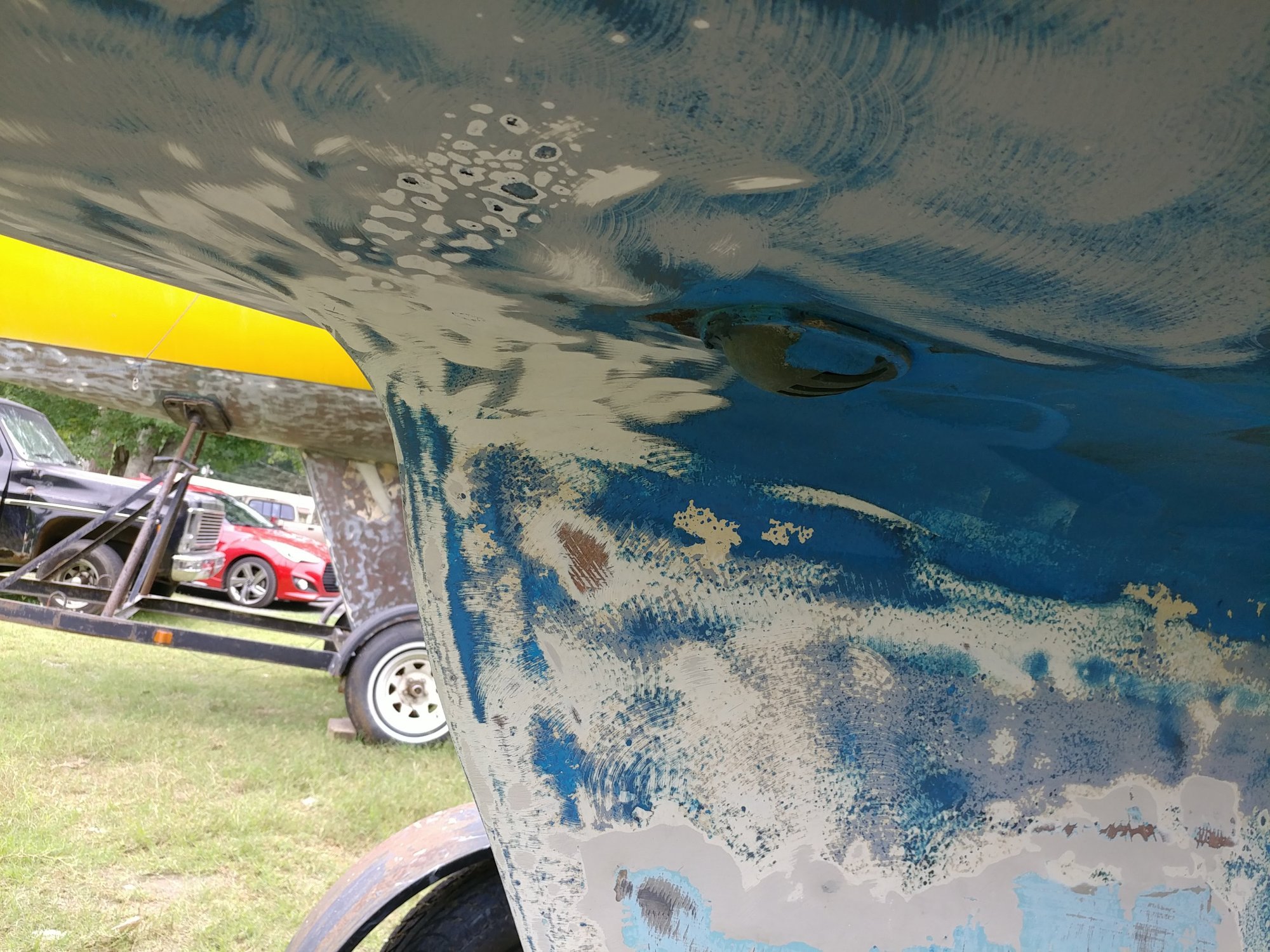

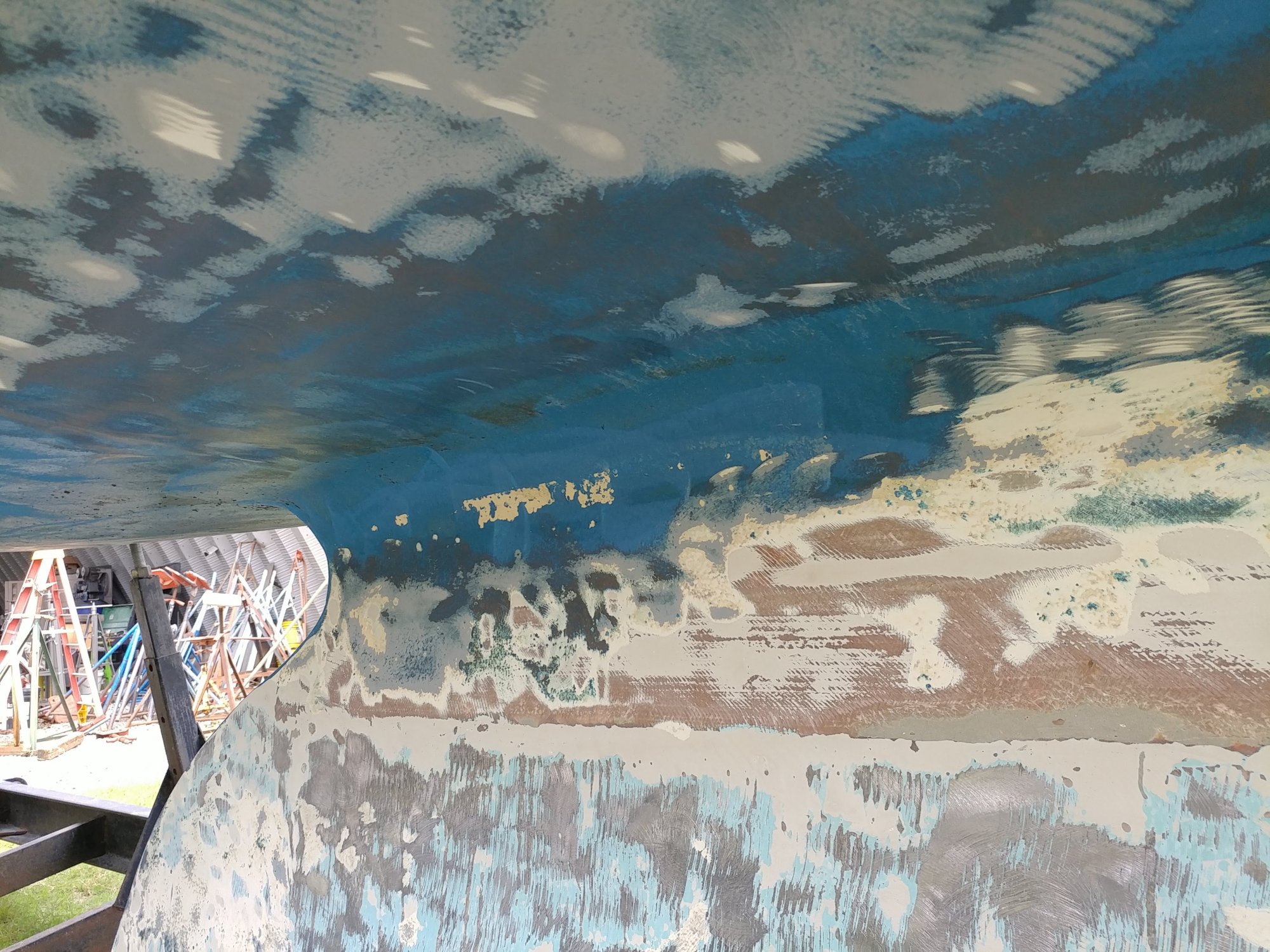

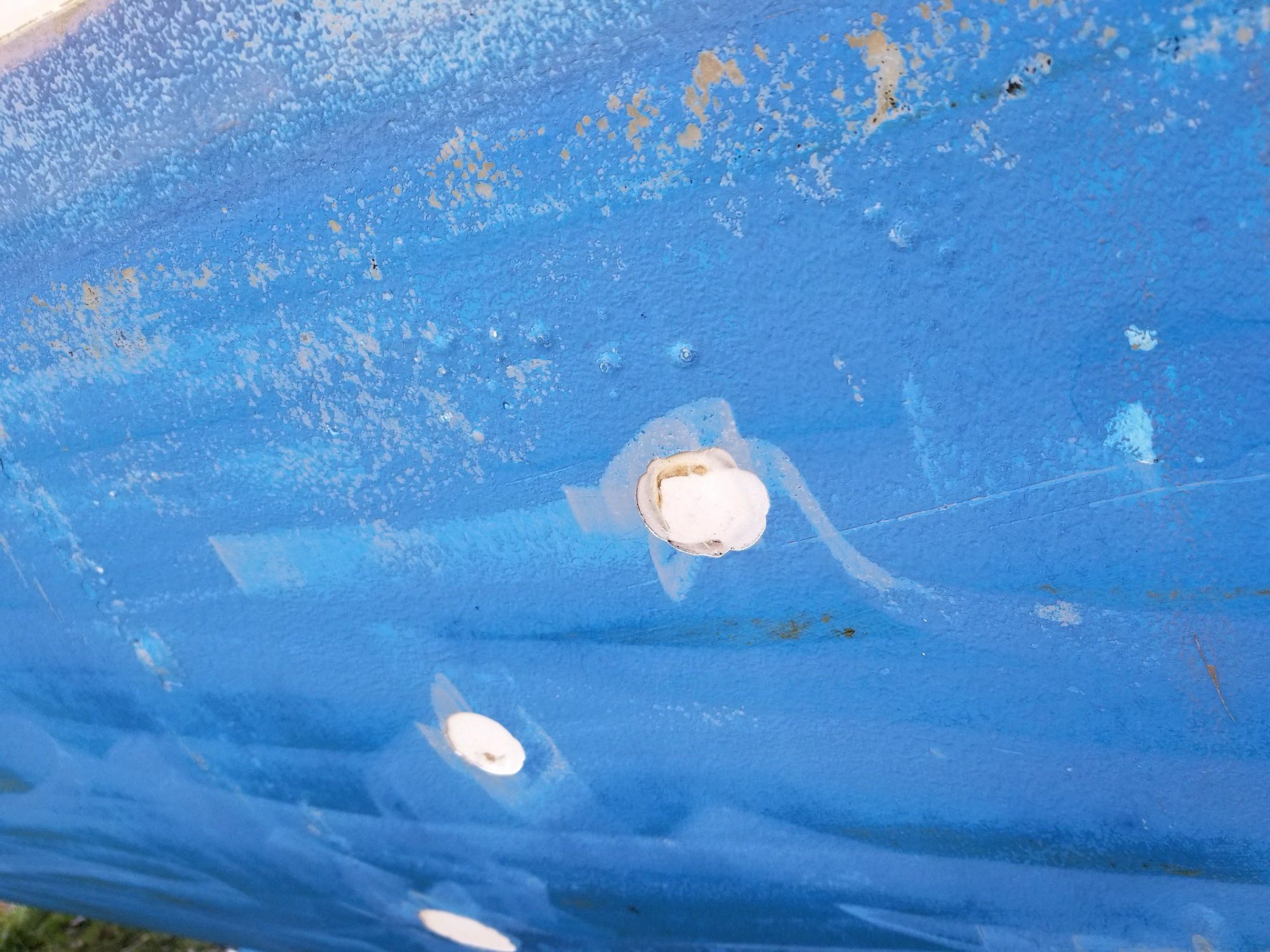

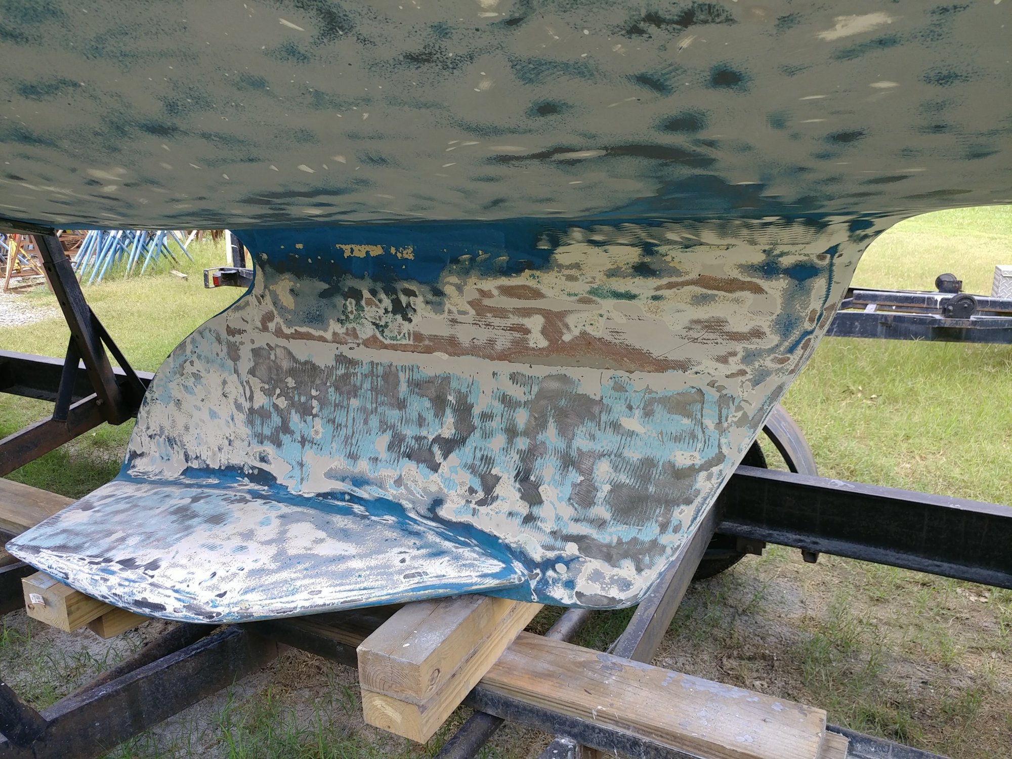

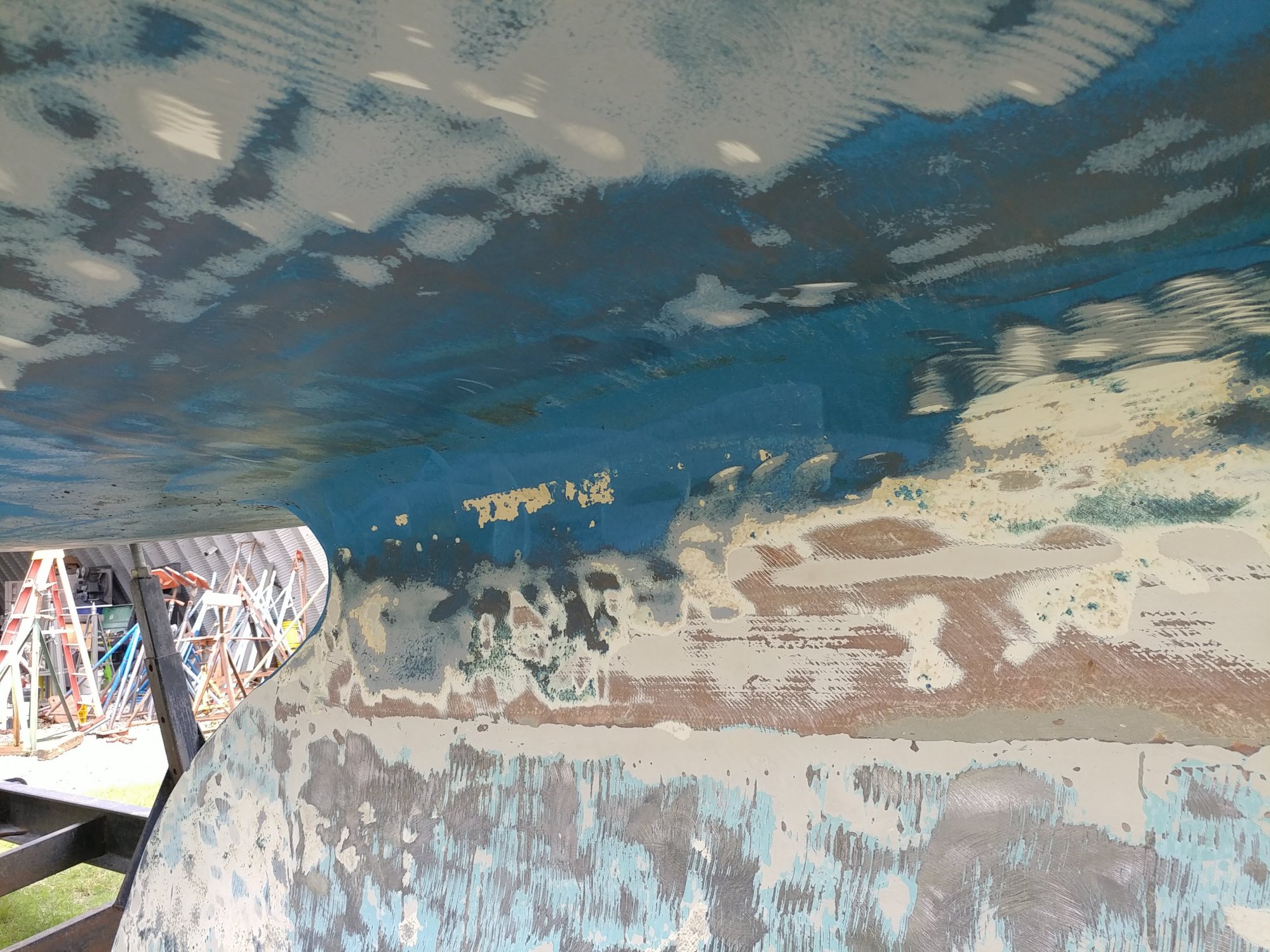

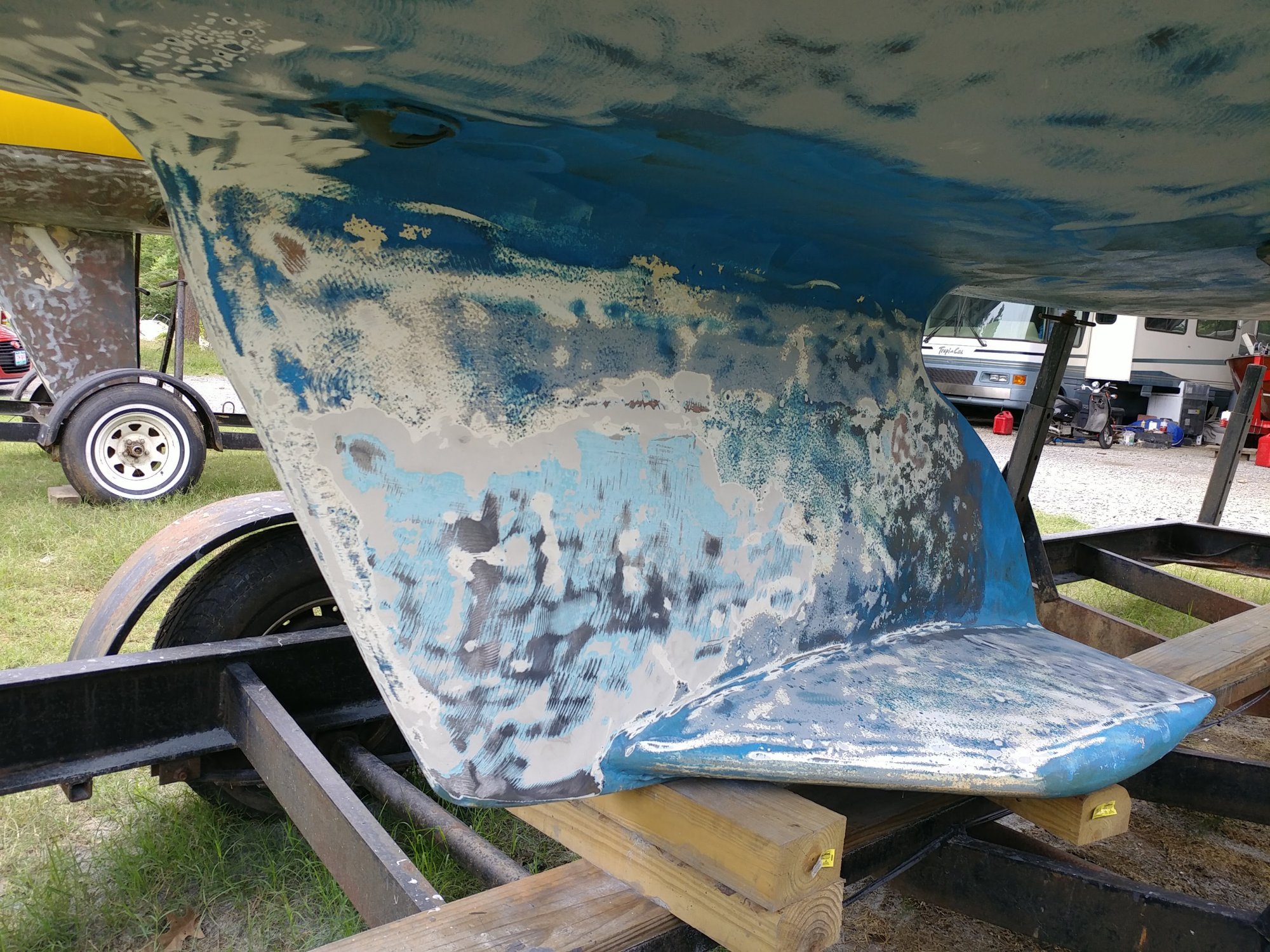

Just got back from my marina and they had to sand down the entire bottom due to the paint coating delaminating in several spots, which I noticed last year while cleaning the bottom. Not surprised as the previous owner had never took her out in 5+ years of ownership. What was odd was that there are several spots with blisters which I thought was rare in the 310 hulls. The yard says it is because the paint pulled away and water got behind it for all these years. I knew going into this boat that the hull bottom was an issue and just budgeted and planned for it.
They are also doing a fresh hull buff and polish and replacing my stuffing box flax since they have it out of the water already and it is one less thing for me to worry about. So glad to get it fixed right now and help our local yard with the work during this crazy time we are in. I'll post pics in a bit of the progress.

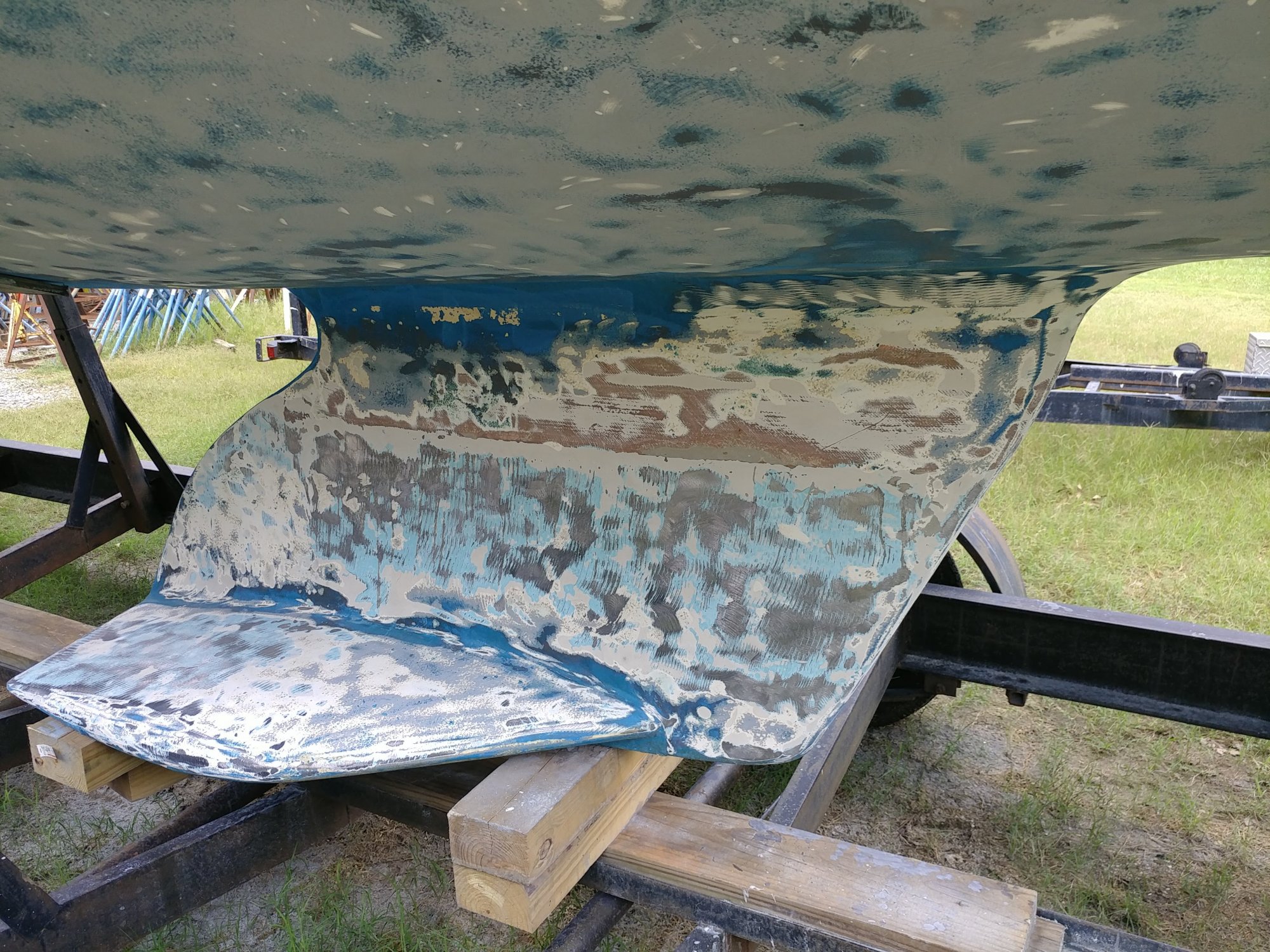

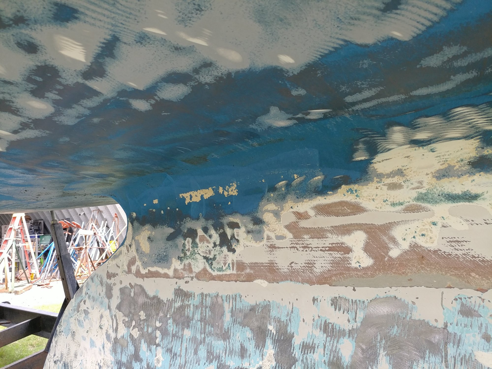

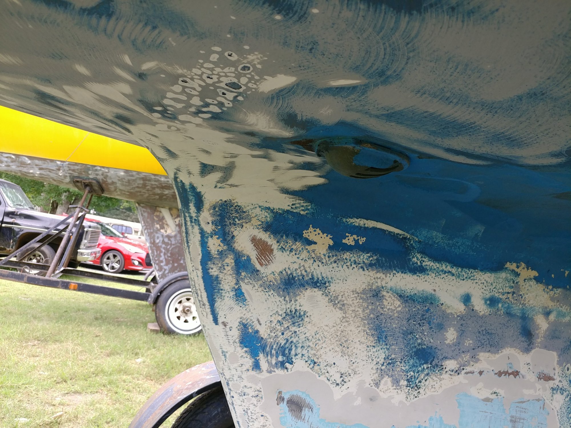

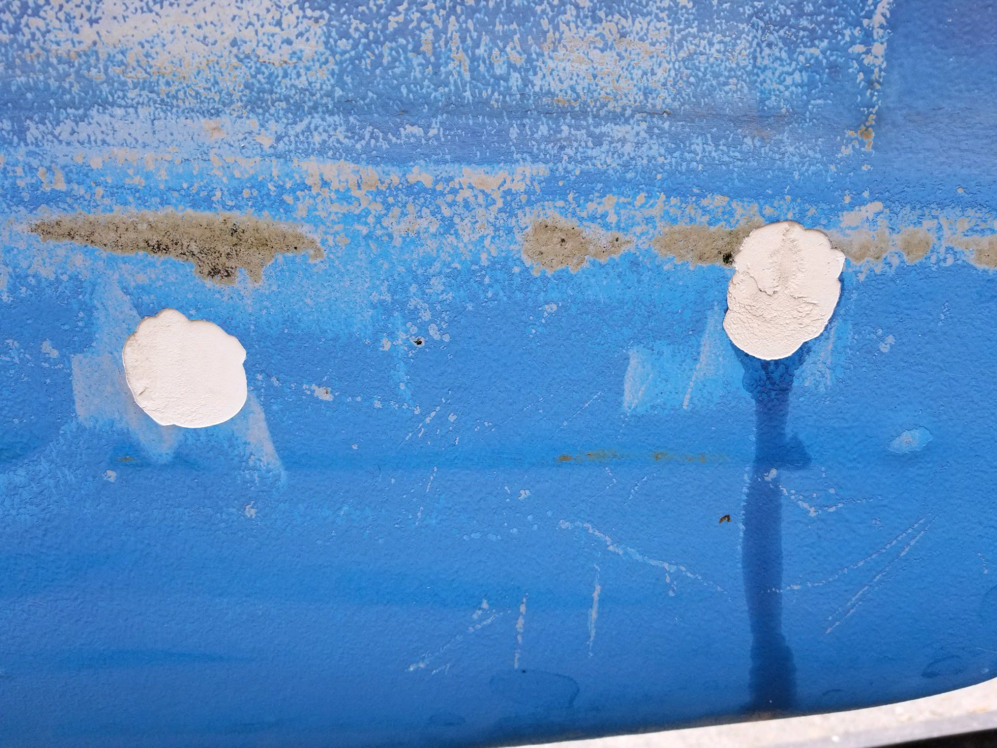

The issue I saw was that the barrier coat was pealing away and caused bumps under. They had to stand all the way down and new barrier and paint that is best for our lake. This boat came from KY Lake originally and looks like it was painted every few years according to log from the first owner. 2nd owner moved to AL and never did any hull work or haul out in 5 years. I elected to skip this last year as I knew it would be fine and I wanted to correct the few comfort issues for family enjoyment. The yard agreed an extra year wasn't going to make a difference and they also kept me at the same price from a year ago even though they were increasing this July. I'm happy and the full sanding and coating removal and repairs look good to me.

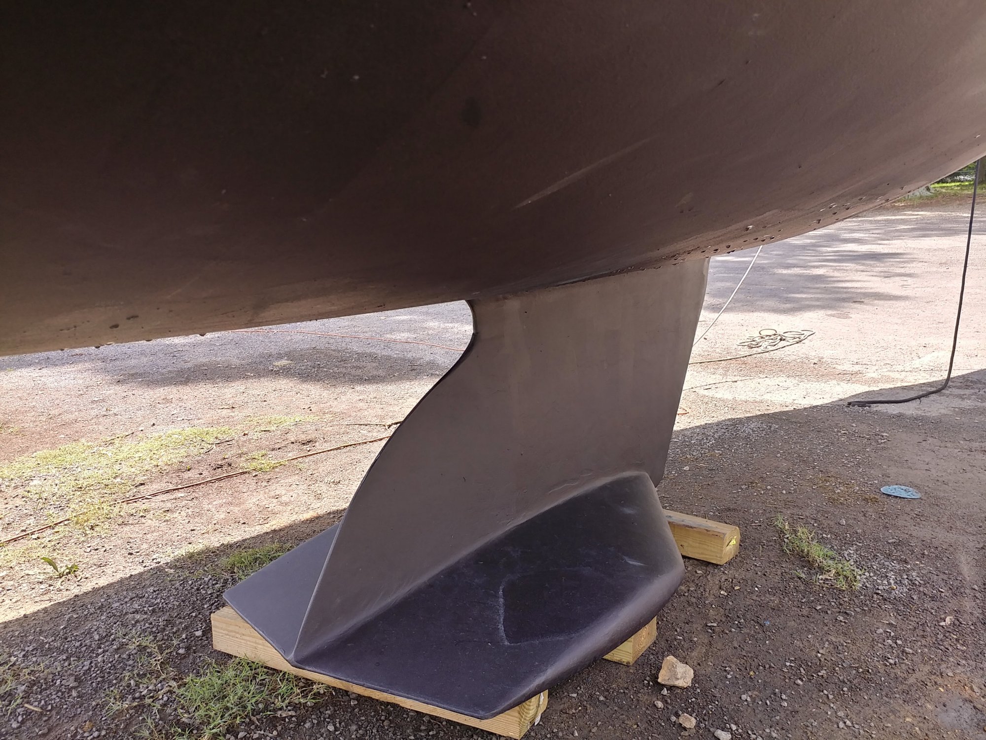

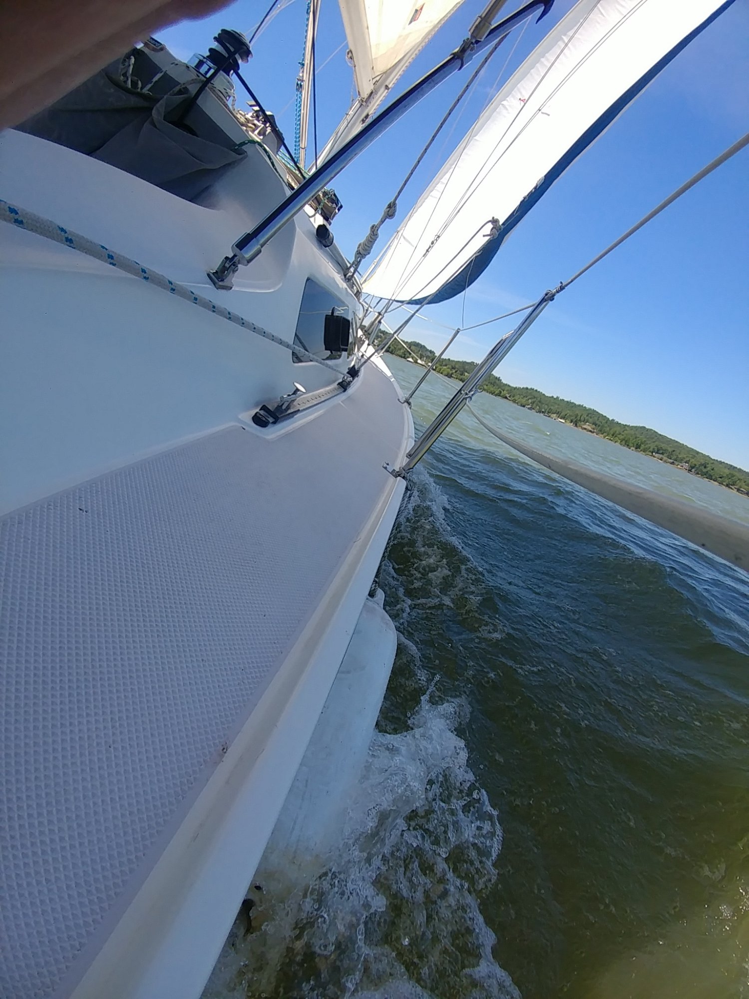

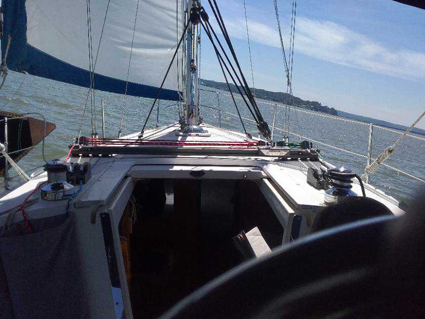

New bottom came out great and results today out in 15 gusting 18-20 had us 5-6 knts on jib alone.
Didn't have a lot of time to take pics, we had tons of wind for a change and were really moving very well with just the 135 Jib, saw 6knts by GPS a lot over water, in water varied based on currents a few time 7.8 knts.

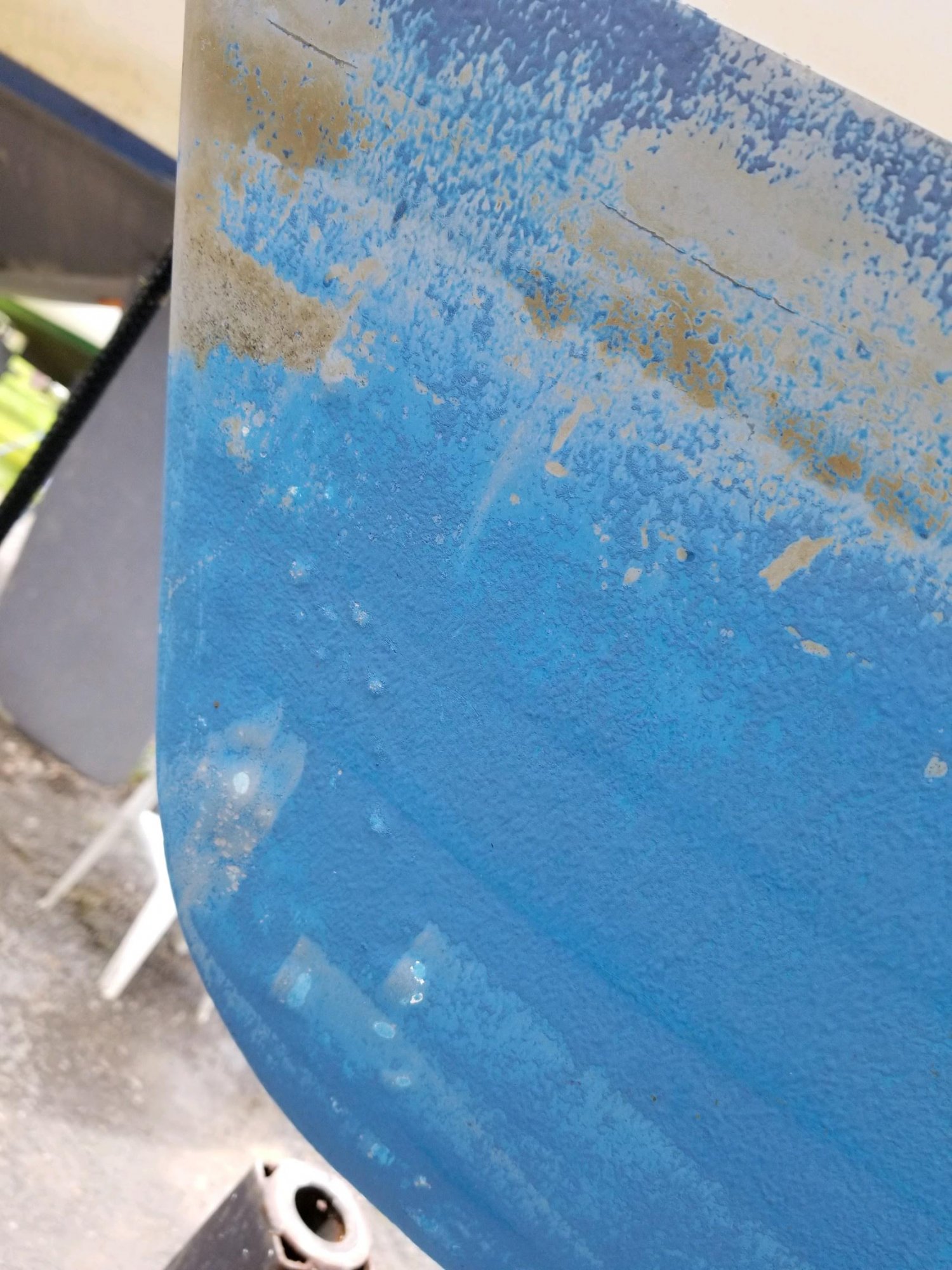

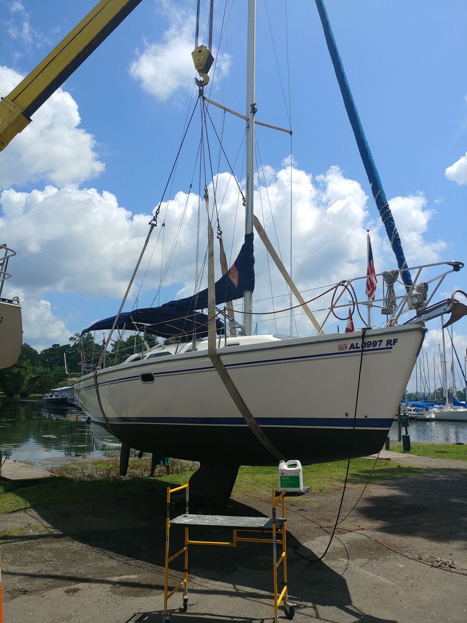

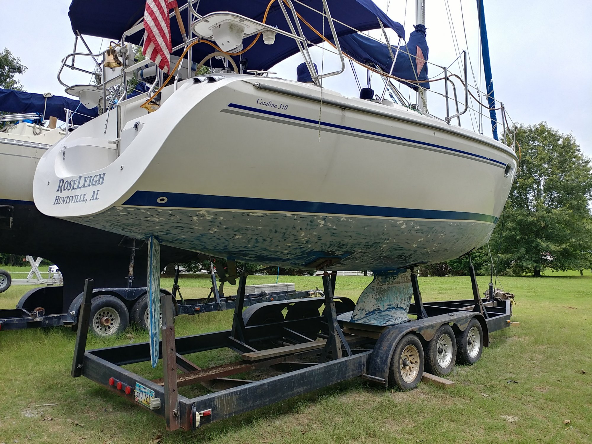

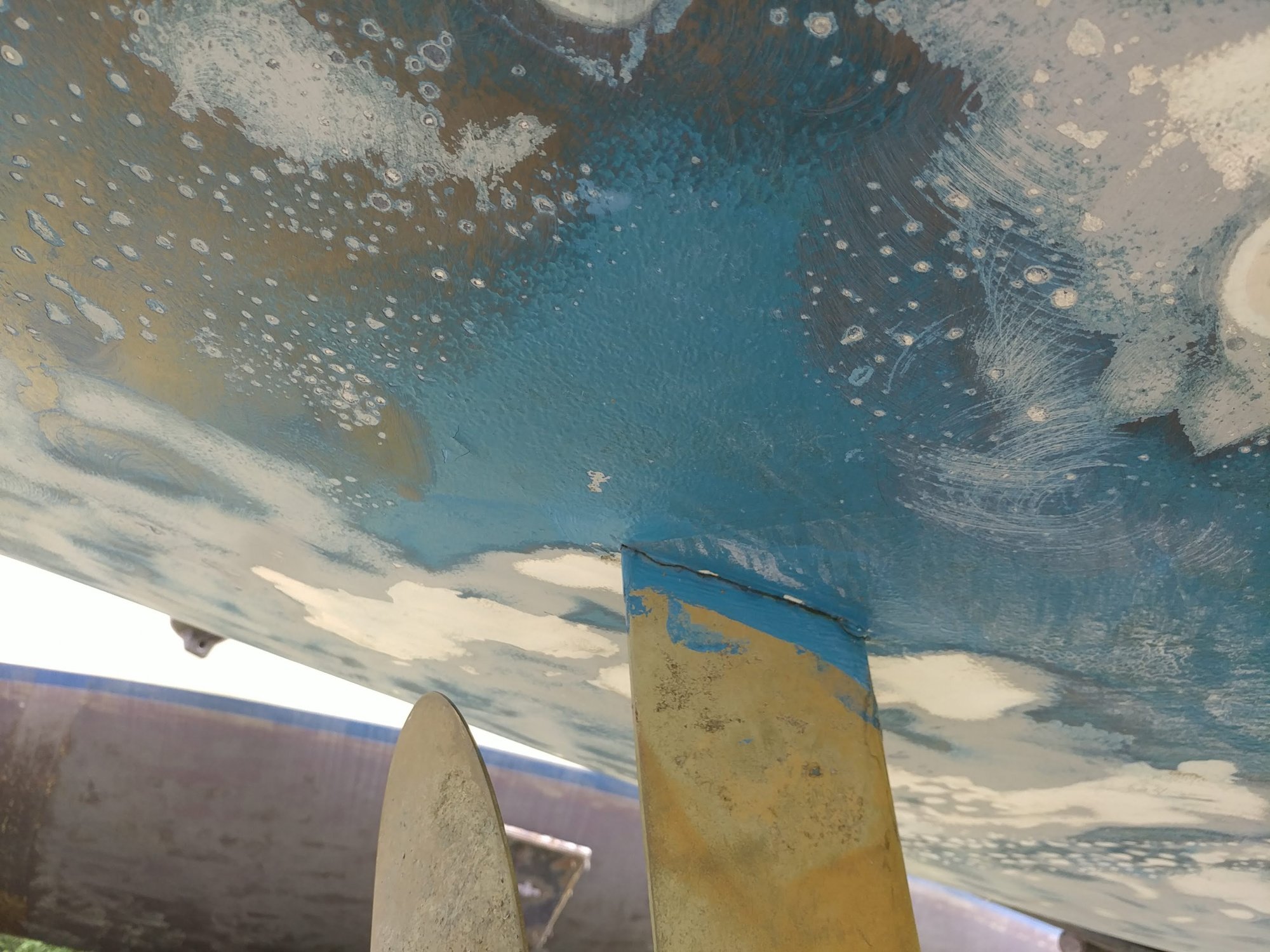

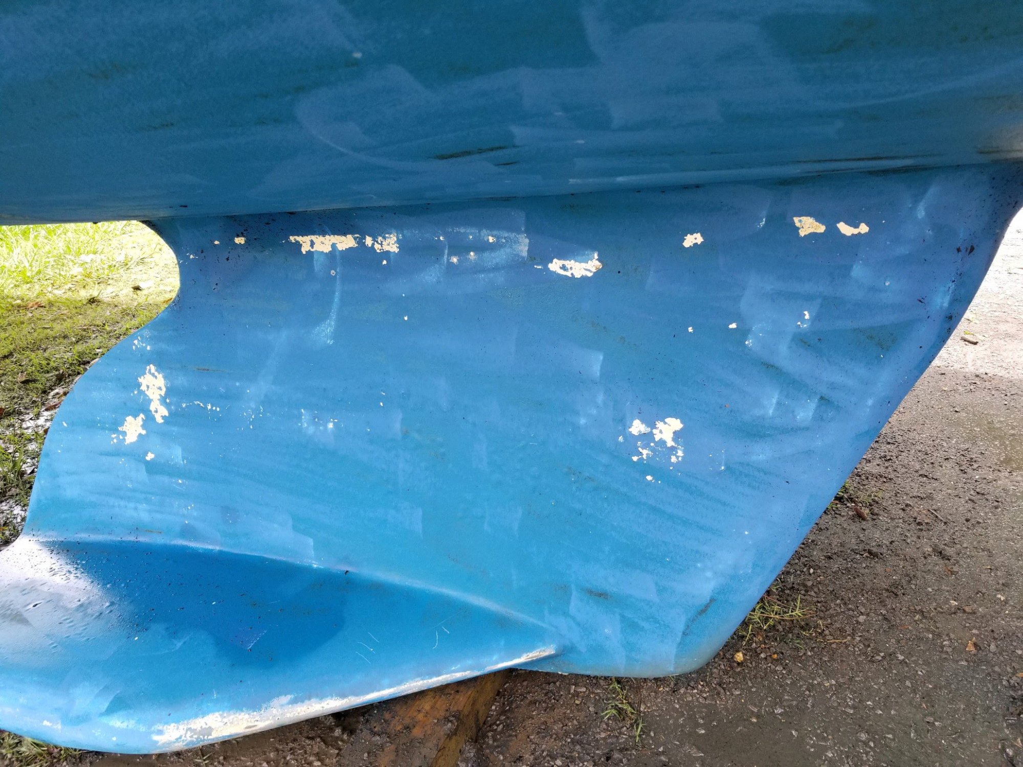

These are the pics the Yard took as they cleaned the bottom and told me they wanted to sand everything down.

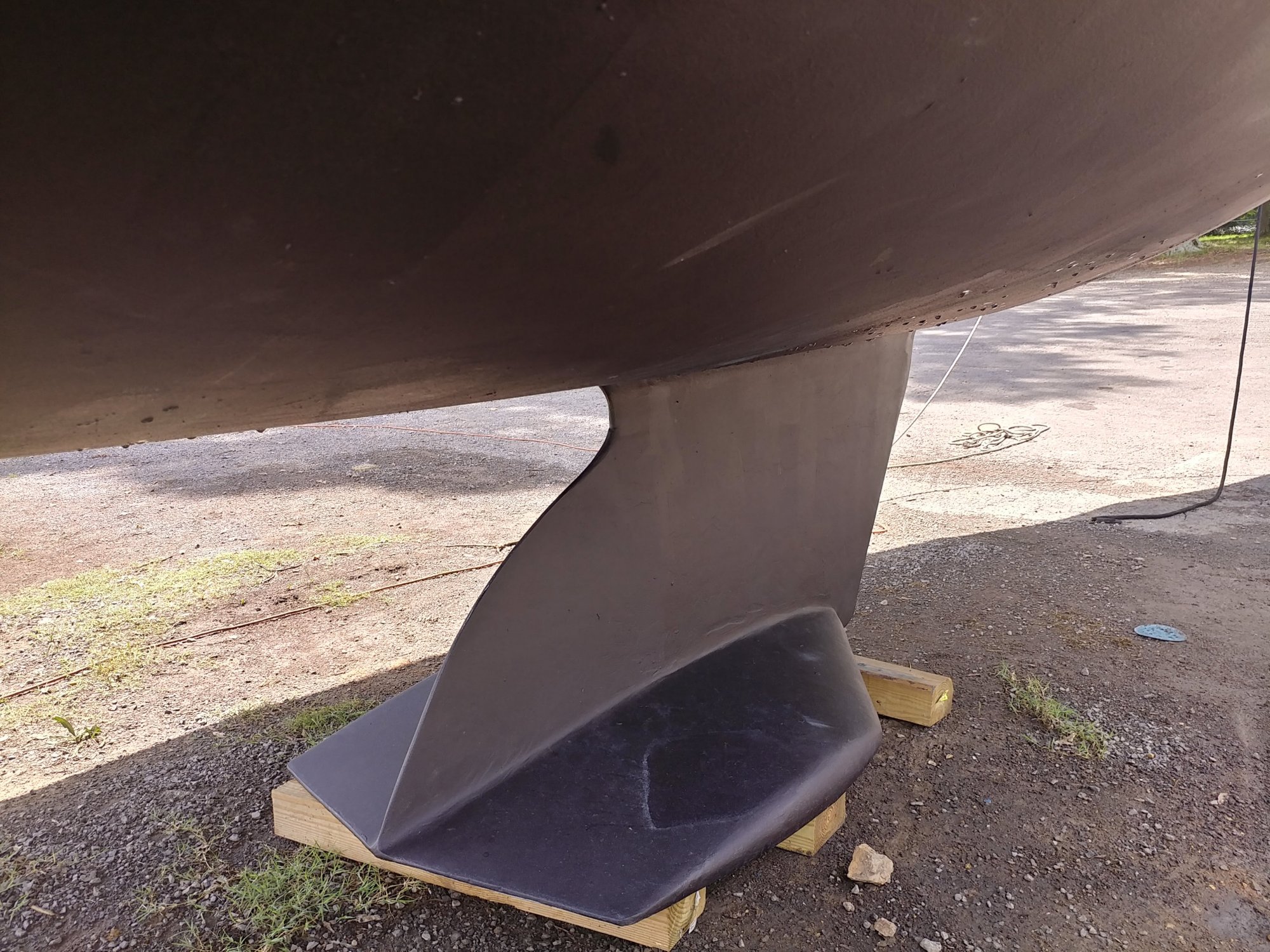

I'm out of order due to computer issues but these are few hours before launch that I took on my wat to work, a few blue spots still needed work and they were still buffing the hull, it came out nice. Several people comment that my boat came out great that were also planning the same work so I know I helped them generate some more work too.

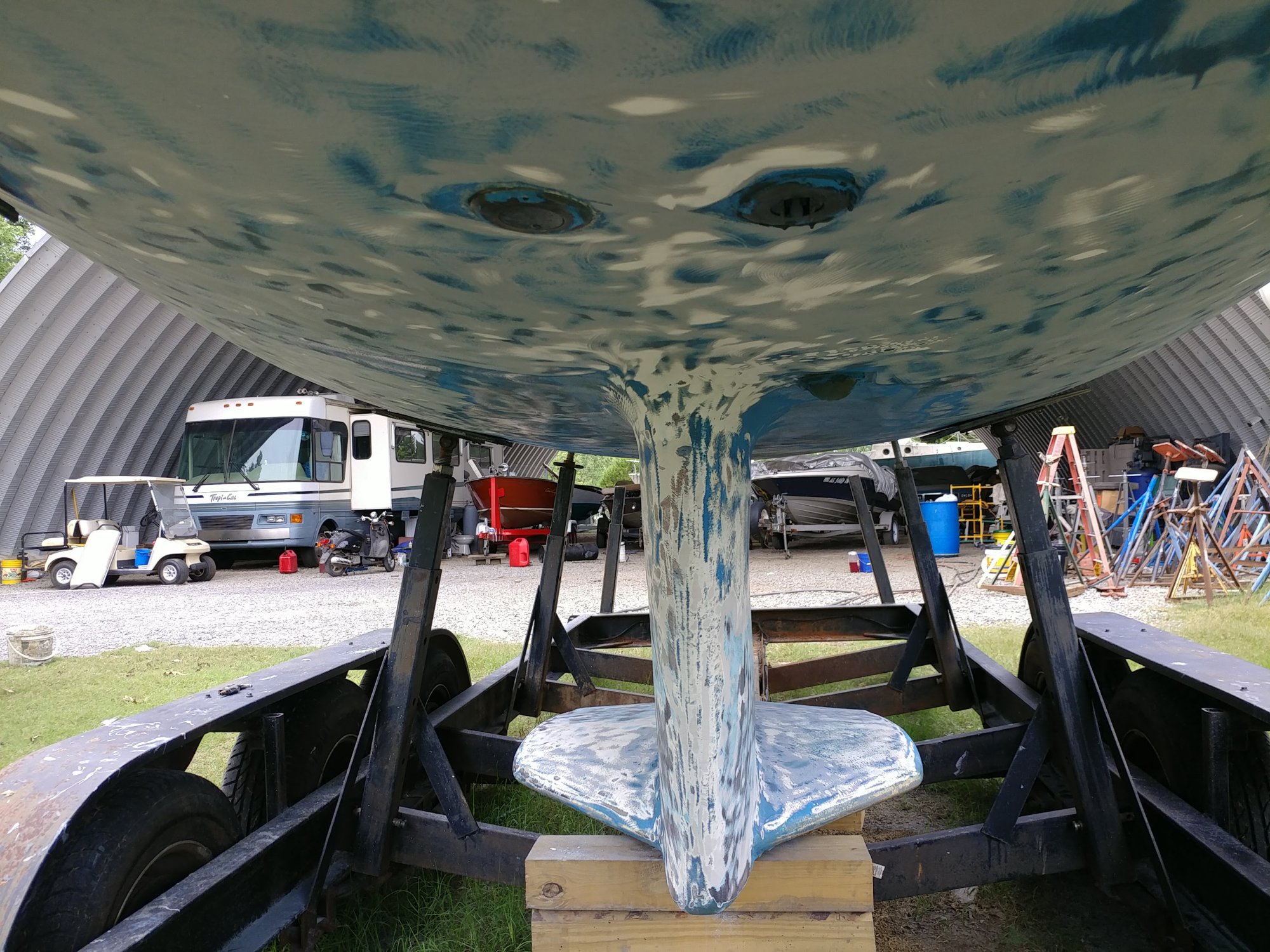

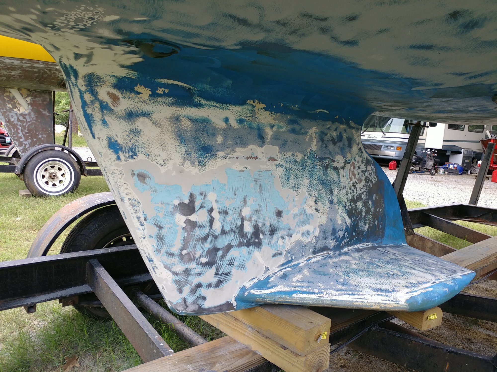

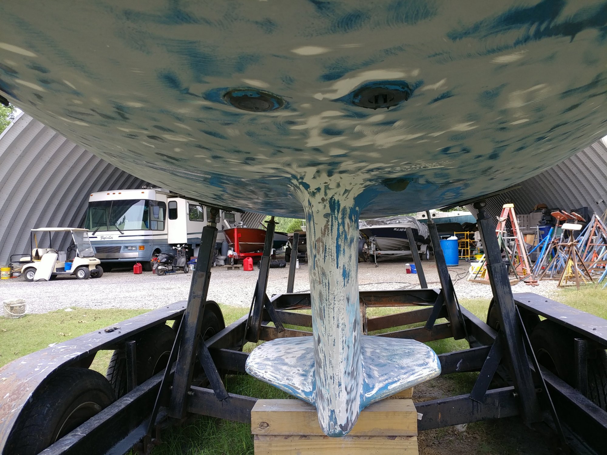

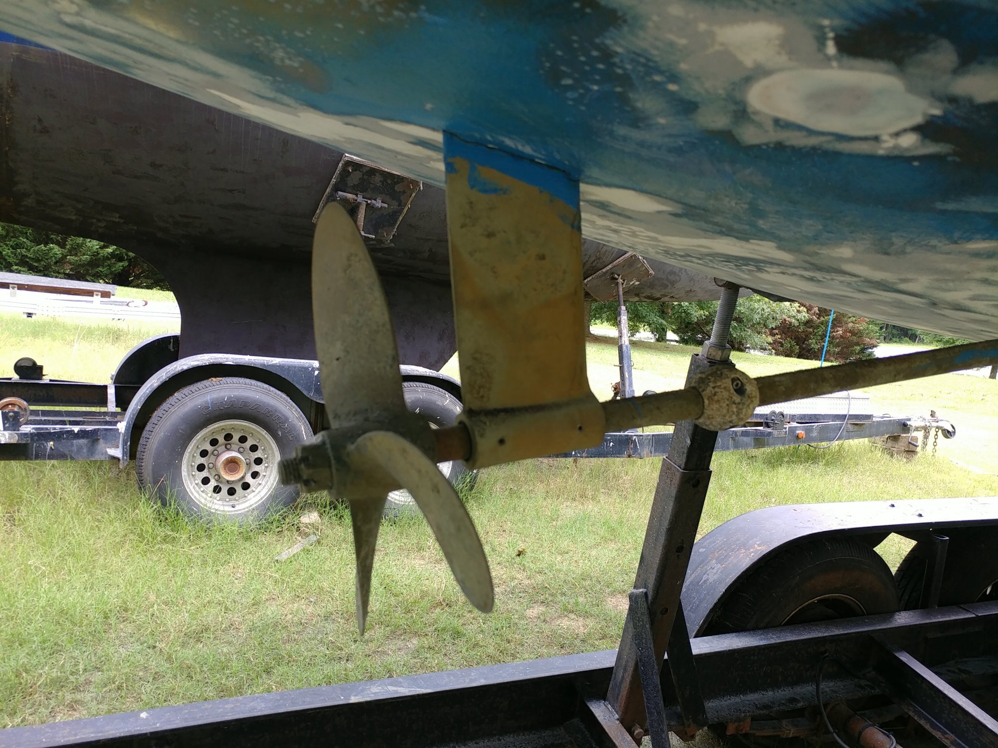

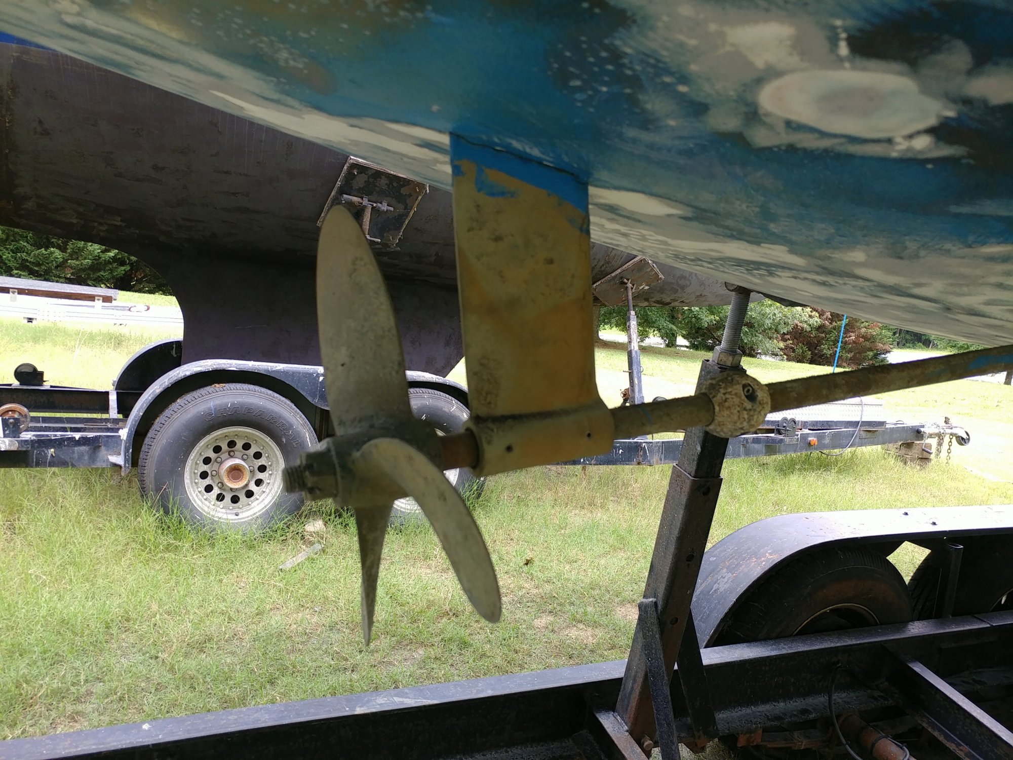

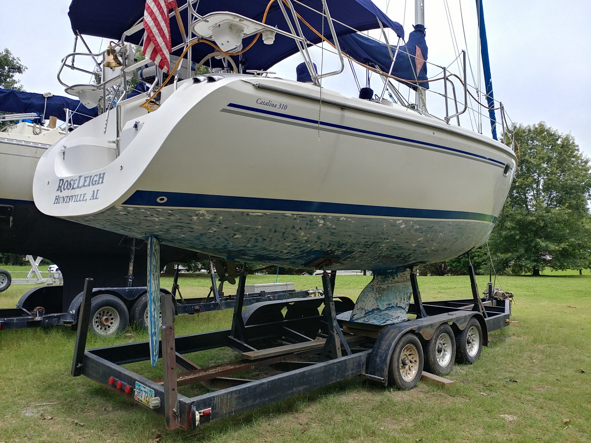

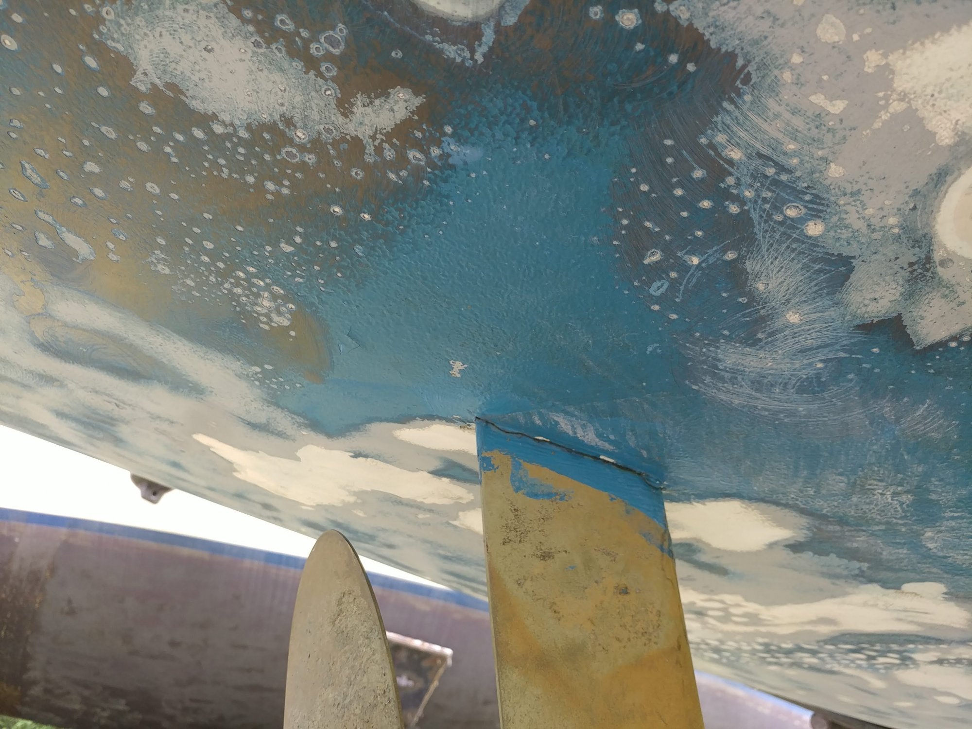

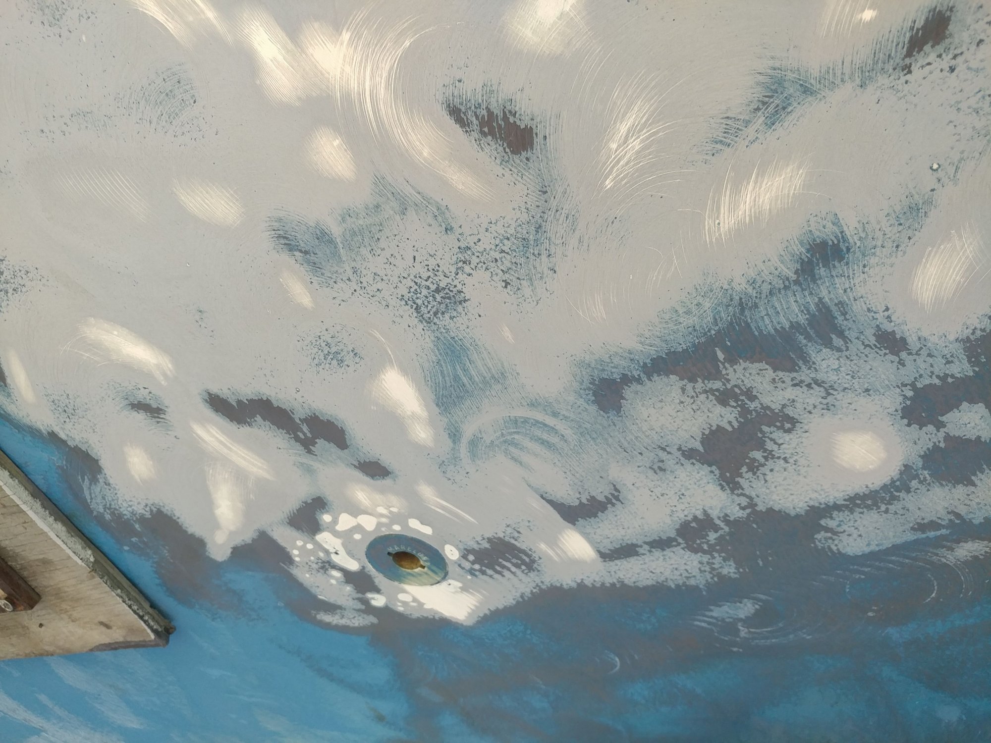

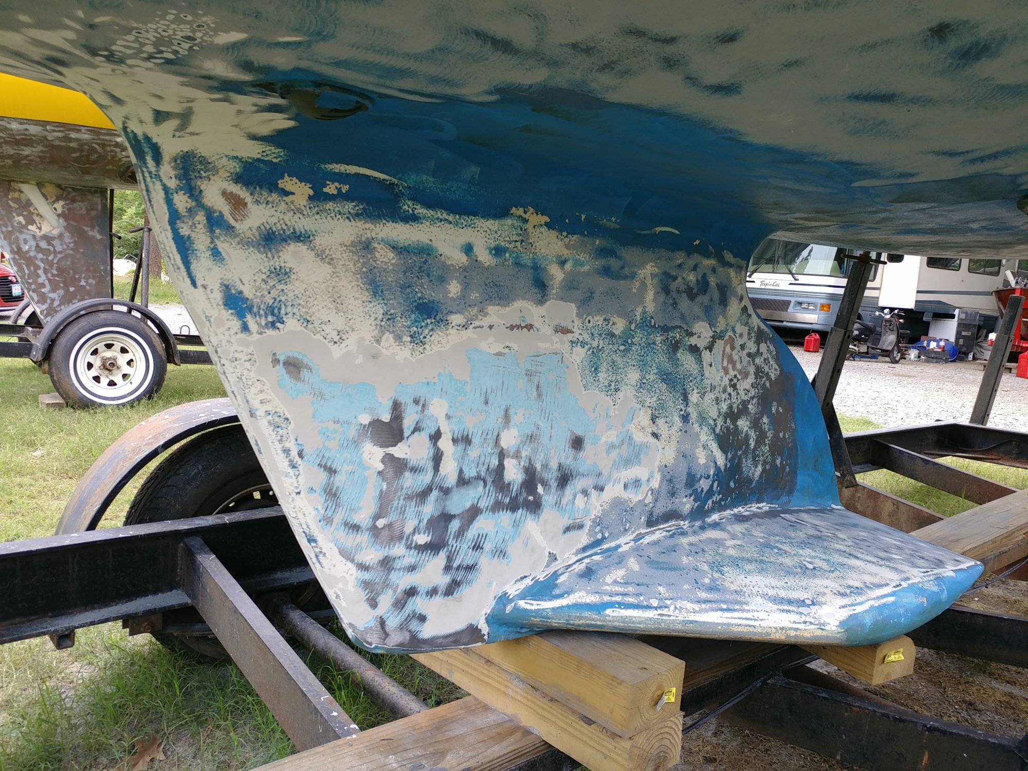

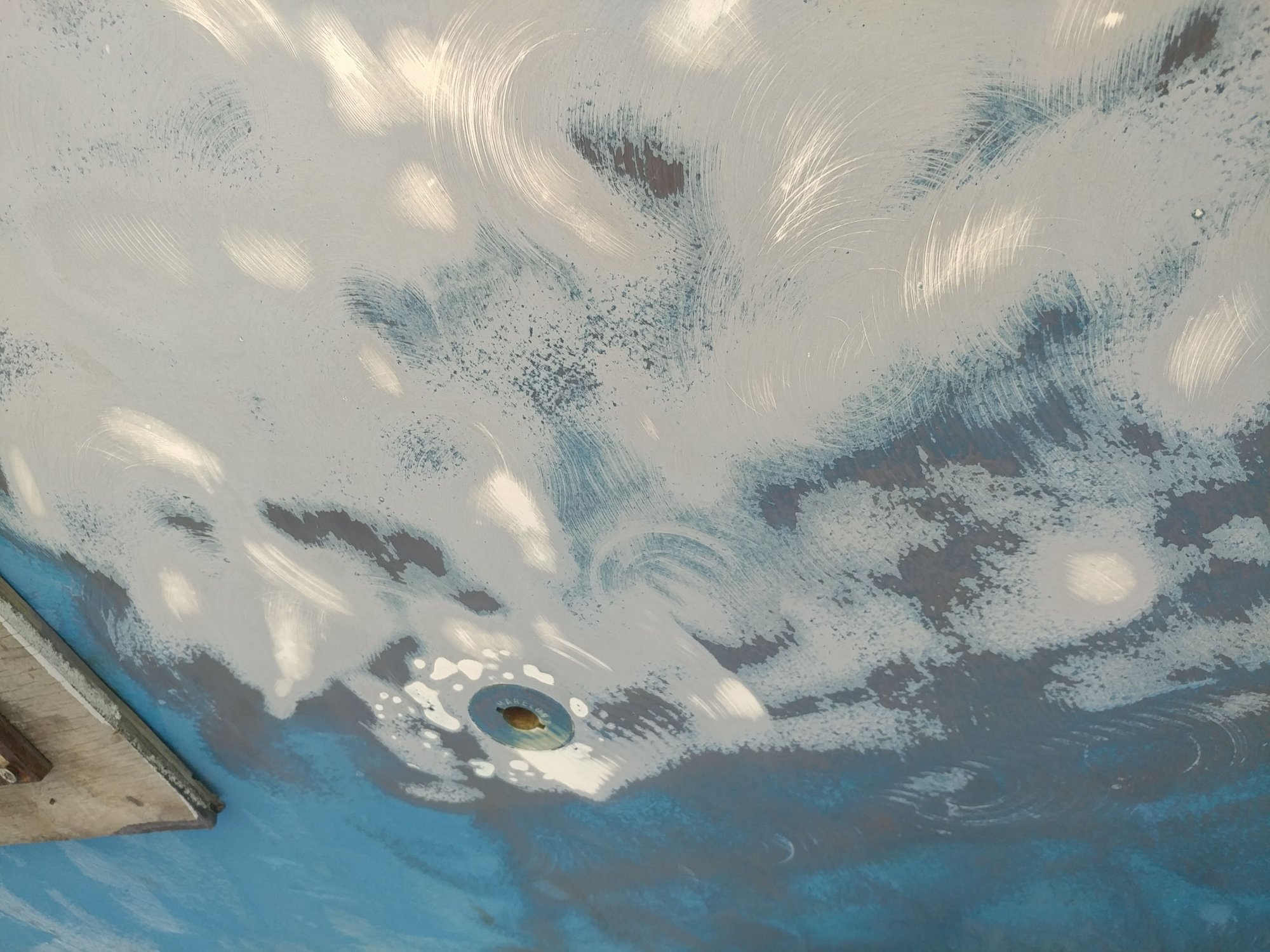

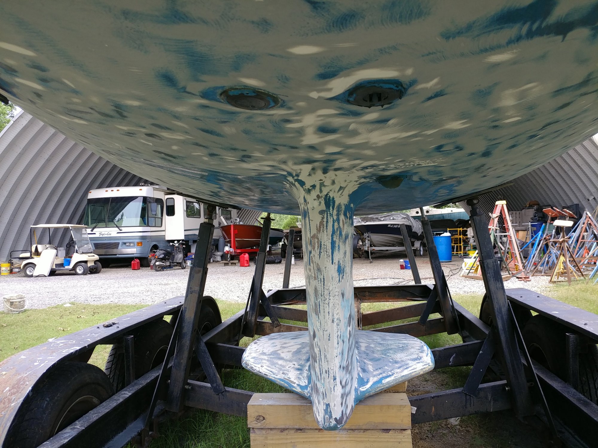

Some in process pics to show the work.
20200706_120801.jpg20200706_120746.jpg20200706_120723.jpg20200706_120639.jpg20200706_120542.jpg20200706_120536.jpg
These were during the sanding process, they still have a few more hours work to finish removing the old coating but were showing me the spots that bubbled up and needed filling in. no visible damage was seen so that is great news, but based on the previous 2 owners being active on SBO I didn't have any real concerns.

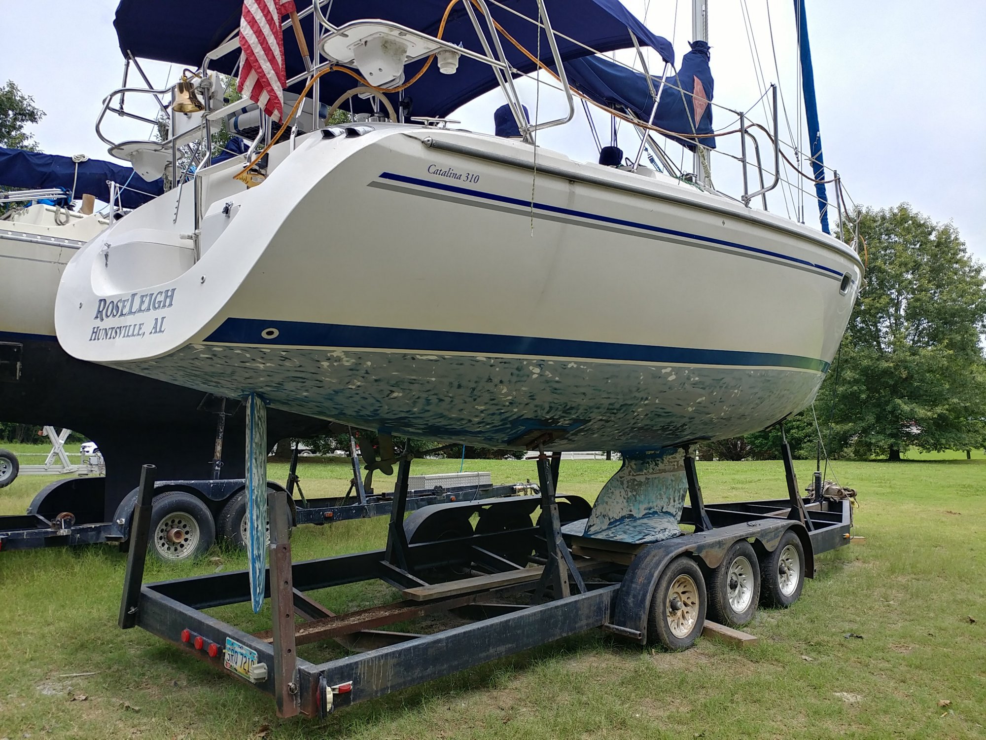

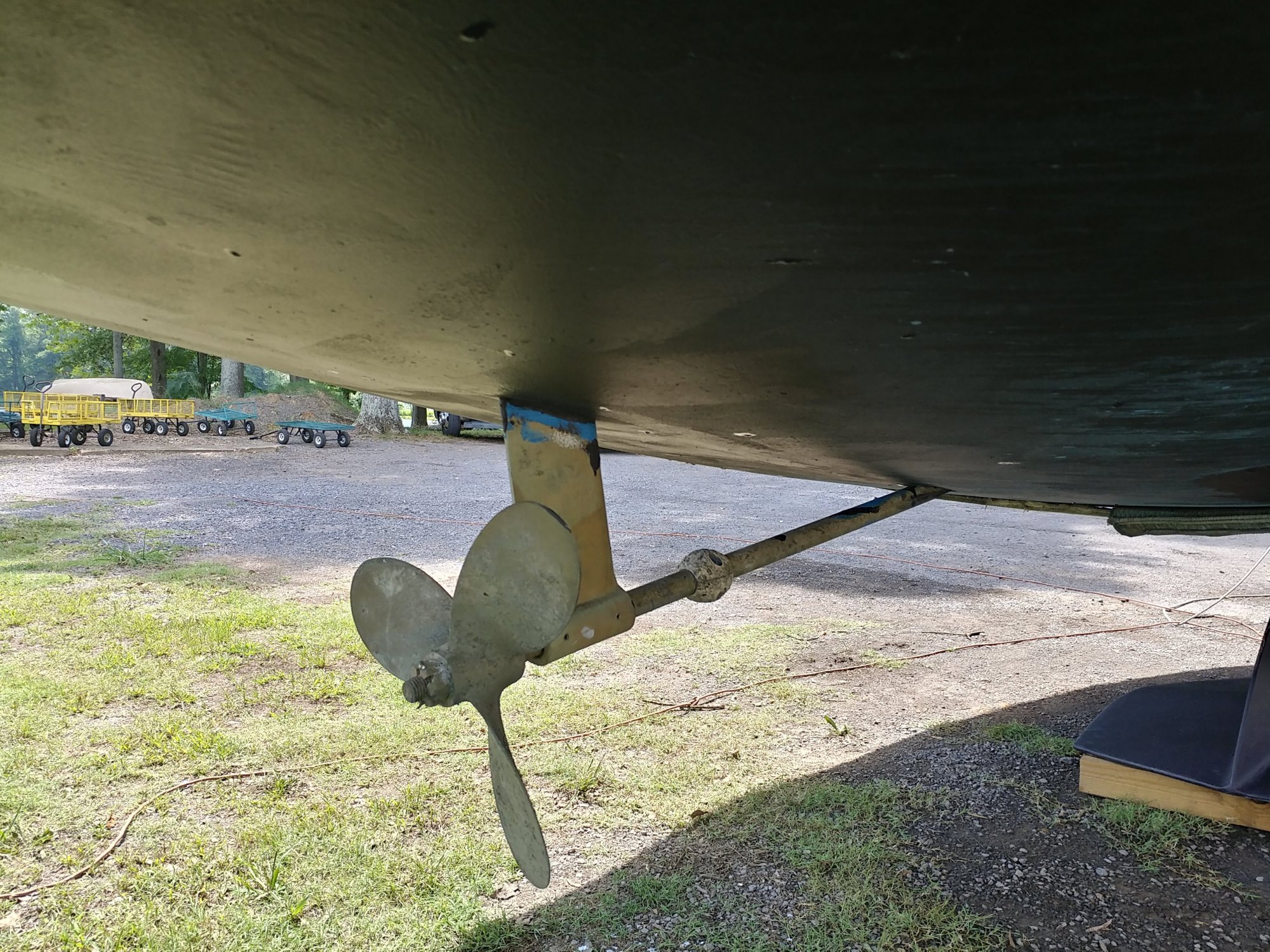

This looked good and I decided since my estimate went up to just stick with the fixed prop and not upgrade to a folding one. I was happy to see that they used the better trailer for my boat for sure too. I messed up and had left my flag up too so I felt really bad about that oversite on my part.

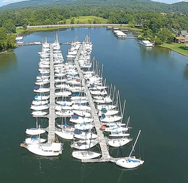

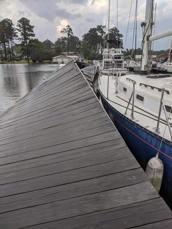

Major damage at our marina yesterday, they think it might have been a tornado or micro burst. Luckily RoseLeigh was on B dock outside so when C dock broke and moved into inside B dock boats we took no damage. Just got back from checking her an other then having to reset the charger everything was good.

Did you get a zinc installed on your strut before going back in?
Did they haul you out on the trailer or with a travel lift and slings? Replacing the speed impeller with a blank plug is a good idea, just in case.
