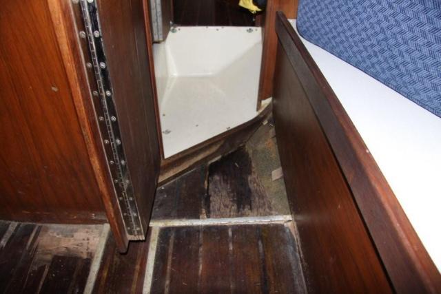

I don't think re-finishing will do as you can see from the photos. The Holly strips in some places have completely pulled away from the teak.

I would clean and clean and clean that wood. sand it lightly and varnish it and see if I was satisfied with the look. Changing the floor is going to be a major remodeling job that will ultimately result in the refinishing of the rest of the interior brightwork. Much if not all of the cabinet work will be tabbed into the hull.
Pull the loose Holly pieces out and reglue them with wood glue (not epoxy) so you can wash t he excess off with water. Sand and scrape the whole thing and refinish with either 12 coats of varnish or just oil. Since it isn't exposed to UV or weather, you can use almost anything. I would us the Benjamin Moore water based urethane varnish I've been using on our house floors for years. It dries so fast you can put on about 6 coats a day.
You'll be amazed how it looks and it isn't such a big job that you'll have wasted a lot of time if it really is un-salvagable. I'll be amazed though if you still want to rip all that wood out, even after seeing those pictures.

I make a living repairing houses and successfully removing a damaged piece of flooring up to the cabinet bases is one of the most demanding and difficult jobs I encounter. There are a few very expensive power tools that can flush cut to vertical surfaces but I don't believe I have seen one that can cut into a tight corner. Not removing the complete overlay will leave you with a joint around the entire perimeter of the repair that will trap water and accelerate the deterioration of the repair.
An honest effort to clean up and refinish what you have may likely yield better results than you anticipate. It certainly won't cost much to try.

I have been refinishing the teak in my boat. That looks refinishable to me. I would do what Ross recommends. I bought some varnish and finish remover from home depot. It smeels like oranges and works in 10 minutes.
I would:
1. clean the floor the best you can with just water to get all the dirt up as much as possible.
2.Use the finish remover. Use a scraper to remove the nastiness that will bubble up. Use towels and fresh water to rinse. Repeat step 2 until almost all the varnish is gone. Not a big deal if some is left.
3.Glue any loose pieces back in place. Replace any missing pieces with the right verneer. You will be able to cut it with a razor knife. Clean up the glue with moist sponge or rag. Lightly sand with 180 by hand. Clean it up and brush on a good polyurethane for floors. Put at least one or two more coats, sanding in between for the best smoothness.
This is a $100 including lunch. It will take more than one day because you have to let the water dry after stripping it.
I got this method right here on this forum by a guy named TonyB.
I know it seems to you like the floor can't be saved. And you won't think it can until you lay down the first coat of polyurethane. It will look like Bob Villa did it. You could almost get away with gluing everything back in place and just coating it in polyurethane. It would look better than it does now, but would not adhere well without removing all the old stuff and lightly sanding it.

Cutting up to or near the edge of the cabinetry can always be covered with a small piece of teak trim. My boat from the factory has this trim and it gives a nice finished look to the interior.
That being said, I would try cleaning first. USe some Captain John's teak cleaner followed by a Tide/bleach/water mixture. 1 galllon hot water, 1 cup tide, 1 cup bleach.
