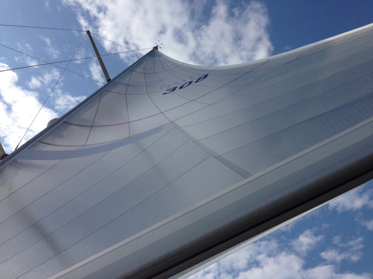

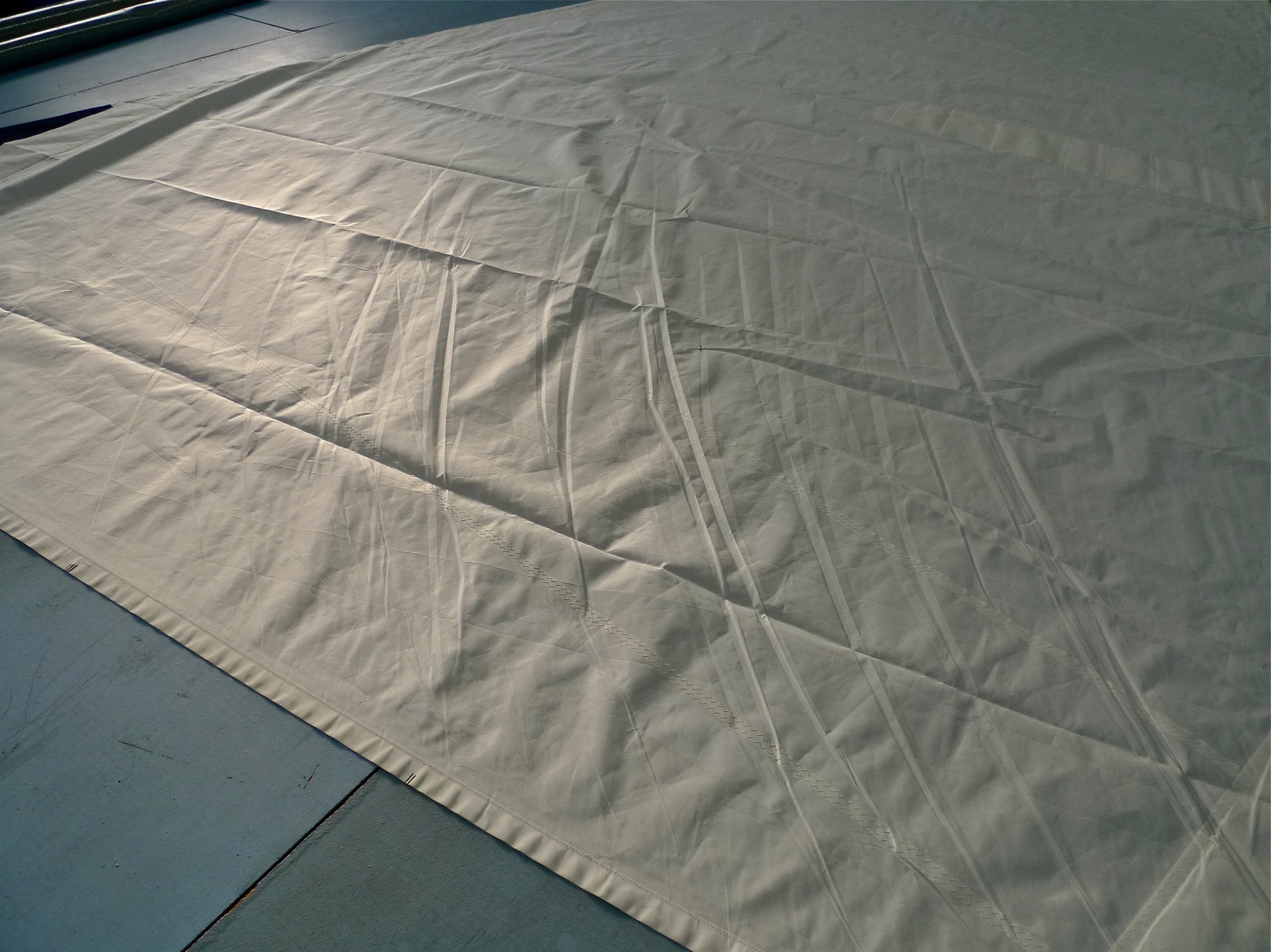

This is what my original main looked like. It could be VERY finicky going in and out due to the bagging which caused it to fold on it's self which shows up as the crescent shaped wrinkles. I replaced the original sail with a laminate tri-radial. It is Challenge, Pentex scrim, Double taffeta. It is thinner and much light in weight. It moves amazingly well in and out although it is actually a much stronger sail that doesn't stretch.IMG_0025.jpg newmain.jpeg It was pricey but it should have a 10 year useful life span at least. It makes the boat perform so well I would replace it tomorrow if it failed and it's only 3 years old, although in truth it looks like the day it was made. The boat heels much less as the sail can be truly flattened whereas the original Dacron had so much stretch it was impossible to do so. I have easily driven the boat to hull speed on many days with the new sails. I sail on many days when people motor. Newer, proper sails are a joy.

I was interested who was the maker of your sail and what year is your boat.
My 2007 H-36 and still using my factory U.K. Sails and no jamming.

I use Z sails out of Stamford CT. The main sail was already shot by the time I bought the 2006 Hunter 41. I couldn't tell you why it was so stretched but it was. So the first thing I did was buy a new jib which believe it or not was in worse shape and then a new main. The boat has been easier to sail, a breeze to reef and overall problem free since the upgrade. Less heel and the admiral thinks they look good to boot.
http://www.zsails.com/
Wonderful people at Z sails. Two of them are olympic sailing champions.
That's a good looking sail. I'm looking at a boat with laminate sails made by Zsails. The relatively short lifespan of laminates is a concern ('though not a huge percentage of the cost of the boat).
I wonder, though, why you're assuming ten years life. Everything I've read on laminate life is 2 to 7, 3 to 5, 5 or 6 years, that kind of thing. I casually averaged everything I've seen to 4.5 years, figure 7 at at the tail.
