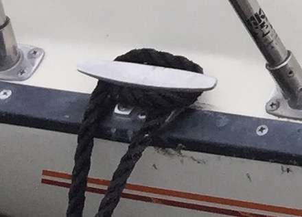

Drop the eye spliced loop over the cleat, under the horns, then lash the loop closed with braided small stuff so it cannot pop back off the cleat.
https://forums.sailboatowners.com/index.php?attachments/jam-cleat-mooring-hitch-001-jpg.40041/
https://forums.sailboatowners.com/index.php?attachments/jam-cleat-mooring-hitch-004-jpg.40042/

As it's my dock line or mooring pendant I leave the small stuff made up to the eye. Drop and lash - 4 seconds tops!
