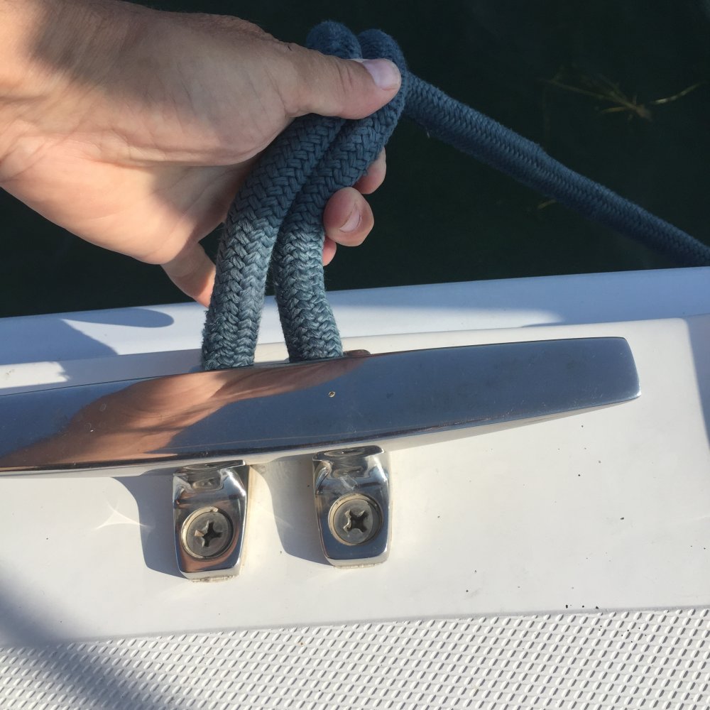

So, the problem is that you are trying to stuff a loop of line into a hole, and it basically is bunching up, which expands the line as you are trying to shove it through
Super-easy neat trick

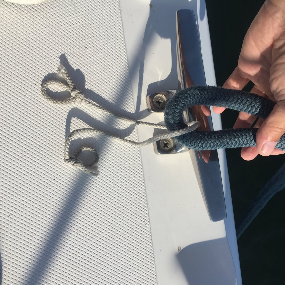

Take foot long length of 1/8" line, and tie small bow lines in each end.
Then, feed this through the eye loop
Now, simply pass both ends of the "specialty tool " P.N. 49-19763-B through the hole in the cleat

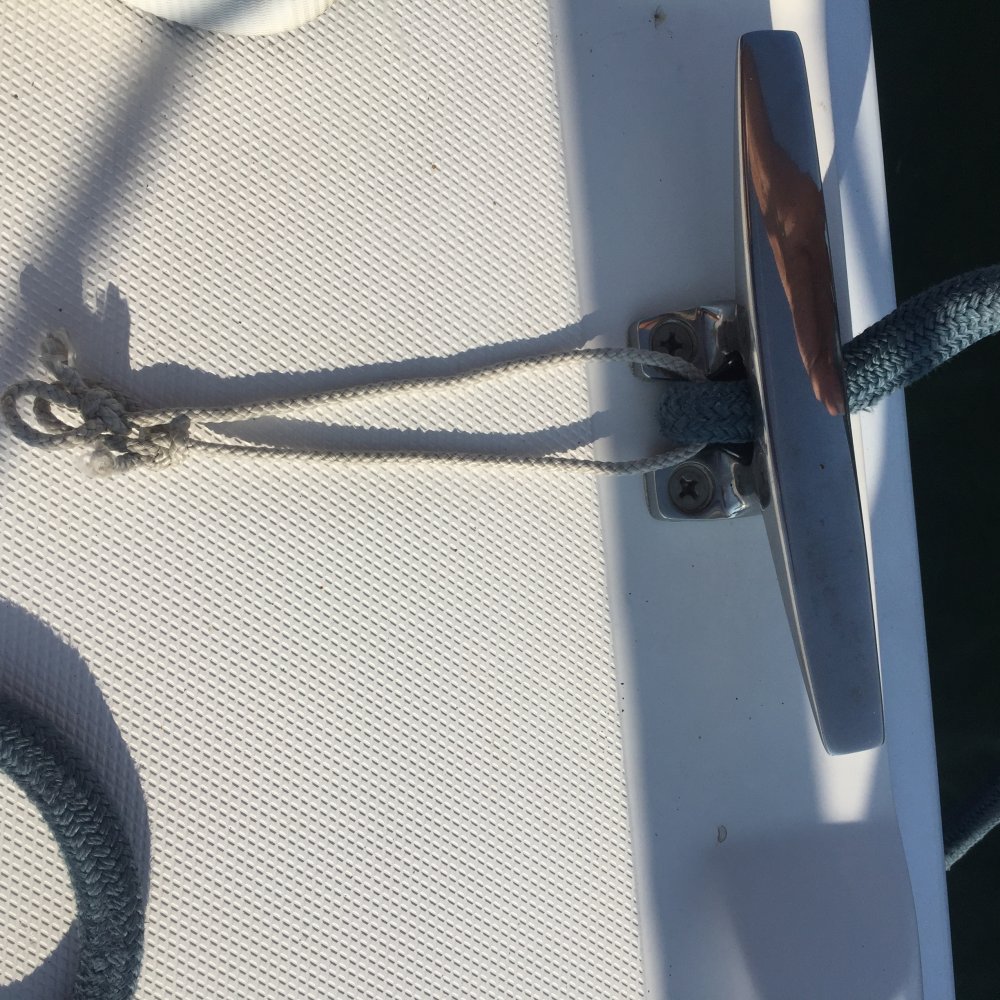

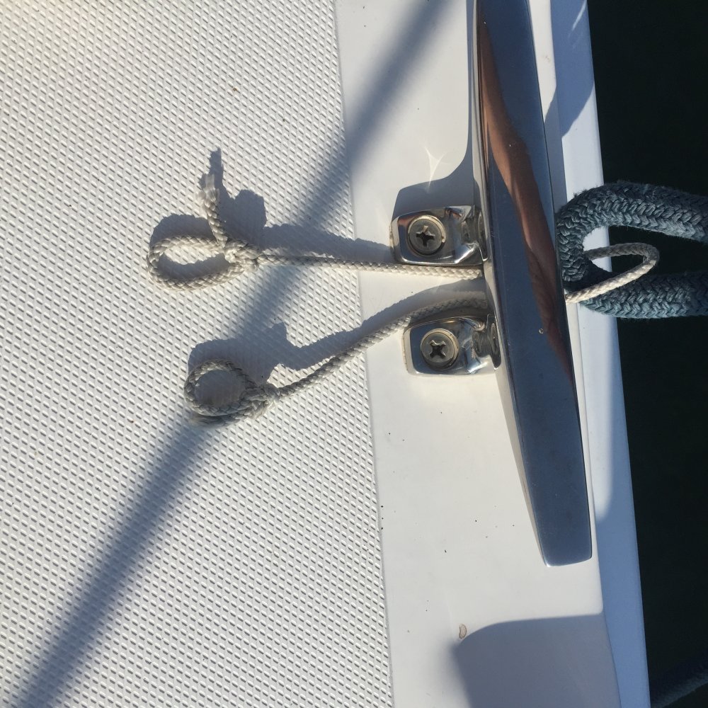

Now, just pull on the 2 small bowline loops, and the eye will pop right through the cleat.
The magic to this is that you are elongating the line, thereby making it slightly skinnier. Plus, you are flattening out the loop in the eye to a point.
The first time I tried this, I couldn't stop laughing how easy it was, compared to trying to jam the line through all these years!!
Note, it makes it slightly easier if you orient the loop so that the line is stacked vertically, I.e., one on top of the other.
