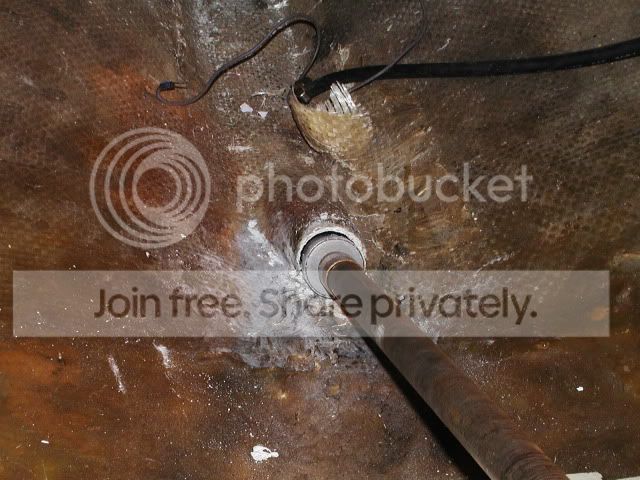

Is the wear just at the inboard end of the tube? I made a new rudder shaft tube by wrapping waxed paper around a form the same diameter as the rudder post and building glass on that. When it cured I had a glass tube that was a close fit on my rudder post. I trimmed the ends and sanded off the bumps.
You could make a bushing to take up the wear and slip that into the stern tube and bed it with filled resin.

Sounds like a reasonable plan, Phil. The remaining tube (upper 90%) is plenty strong enough to carry the small torque from the seal face contact.The pipe is a close slip fit onto the tube?? . if ya can find a new bellows that matches the new OD of the PVC, should be fine.. I'd use epoxy (West G-flex) just so I'd not have to wait 4-5 days to get it set. The PVC won't see any UV and it will be in cool water .. should last a LONG time.. I don't think I'd put a close clearance bushing there in teh stern tube because it would be a hard point that would load the tube when the engine bounces.. A packing is mounted in a flex section, so it doesn't load the tube the same way as a bushing might. A bronze bush replacing the PVC might be Ok but I'd opt for the no-corrode PVC, myself.

Here's what I got
The shaft log is just worn down on the forward, engine, side of the log for about 4". The log is glass, about 1-1/4 ID, and OD is 1-1/2". Wall thickness is not much. Approx 1/8". Not structural or load bearing. It sits down in a recess, that is very tight. If there was any way to get down under it, I would just do some glass work, but can just barely reach one finger under it to feel the bottom of the tube. Considered the possibility of wrapping it in glass but there is no way to know what you got on the bottom side. Can't even get a mechanics mirror in there to see much of it. I cut a piece of 1-1/2" schedule 40 pvc that fits over the tube, loose fit, and it looks pretty good. I know that 5200 will stick to this pretty good, and as I said, the tube is not cracked but just tissue paper thin for the forward 4" or so. I can get about a 6" piece of pipe on there. I think that a 1-1/4" cutlass bearing would go into the tube, and thought about using some epoxy and inserting a cutlass bearing in it, but not too sure about that method either. Keep the ideas and comments coming. All are welcome.

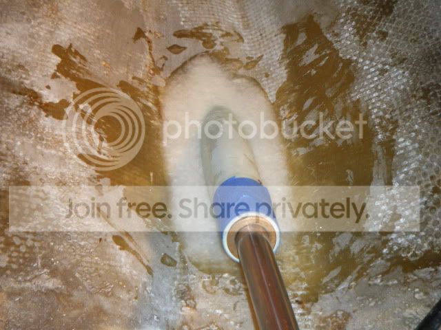

Any chance you could post some pics so that we could see what you're descibing better?? I am a little confused as to the names of the parts being discussed and wonder where I could go to learn more about this.
Tommays' pics are clear as day but I'm admitting my ignorance as to what is what. This seems to be something that I should be checking on regularly and want to learn what it is I'm seeing.
