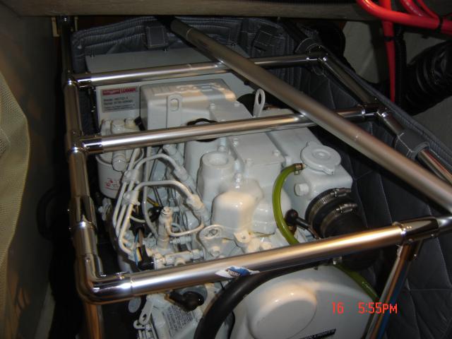

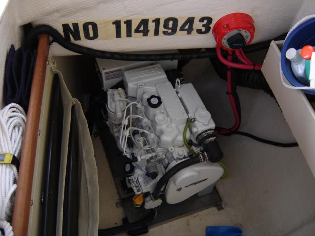

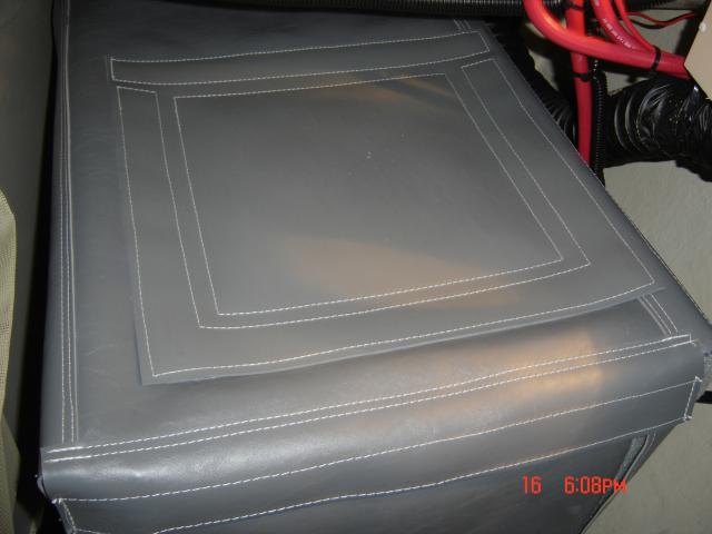

I had a 5kw Northern Lights installed when I commissioned my 356 in 03. It now has about 1600 hours on it. It is mounted in the aft port locker. If didn't originally have a sound enclosure installed and I later tried to add the factory unit but didn't have room. I had a custom enclosure made and it is barely noticeable now.
My unit has 3 cylinders and runs at 1800 RPM versus a comparable Panda that is a single cylinder and runs at 3600 RPM. I have friends who have both and all of us with Northern Lights prefer them for less vibration and noise. Panda does a lot of marketing and Northen Lights is not as well known, but I believe is the better generator. I burn about 6 gallons in 24 hours and we use it most of time we are out of the slip for both heat and cooling during our hot humid summers. Other than changing oil and impellers, I have done absolutely nothing to it.
I took a Cabo Rico 38 from Ky Lake to Punta Gorda last fall with a relatively new 5KW Panda. We didn't run it at night on the hook because it was so noisy.It got quite cool in the interior of the boat while we slept (Nov 07). His unit has had a lot of maintenance issues as well. 'll take my Northern Lights hands down over the Panda, so give them a look.

Jerry,
Nice job on your genset sound insulation install. I also have a 5KW NorthernLights in the locker on my IP35 and don't have space for the factory enclosure. Would you be willing to share the material that was used for your insulation blanket and how the pieces attach to each other an the base? Thanks in advance.
