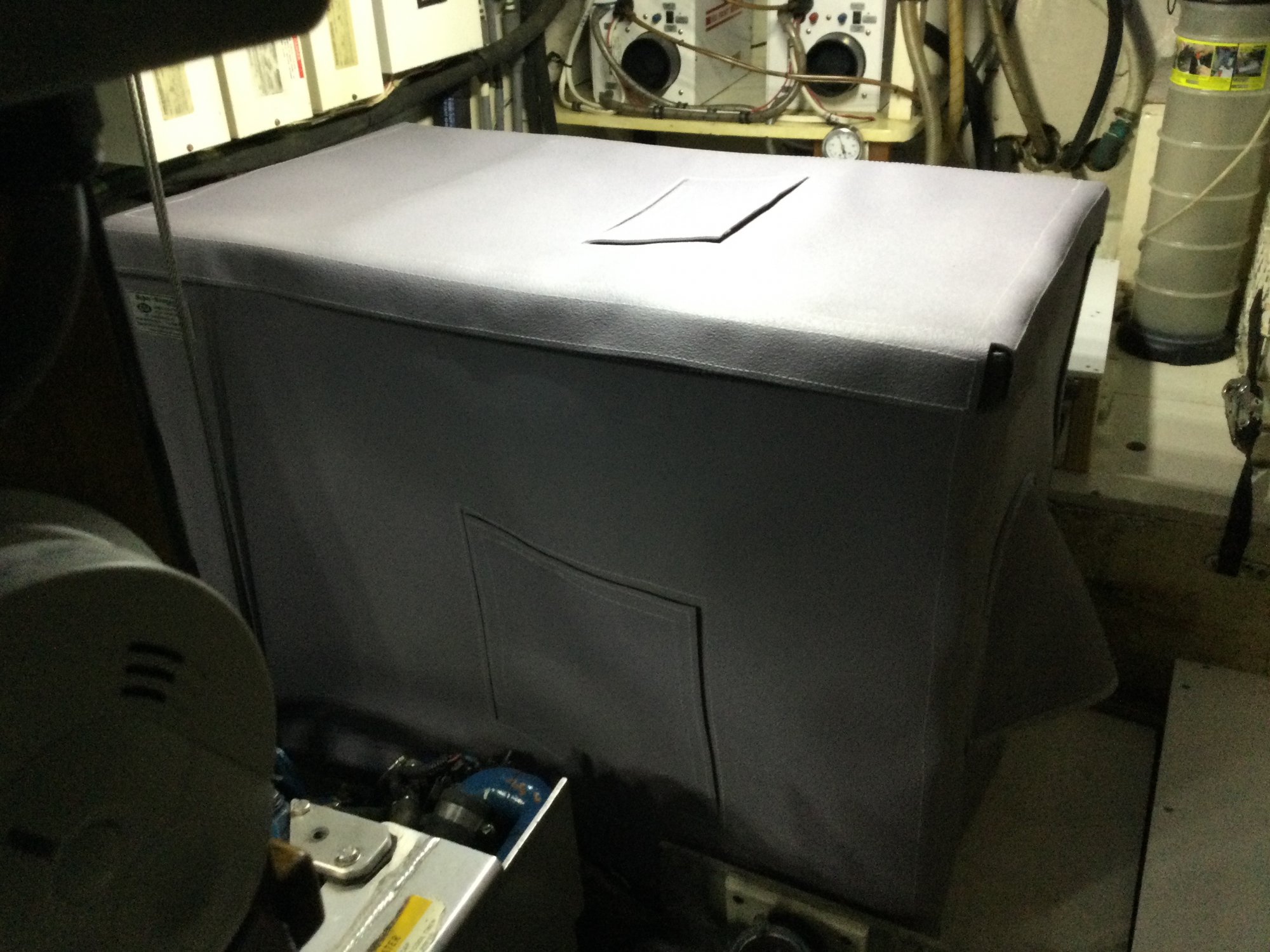

We covered our genset with a sound cover, if you still have your wallet out.
