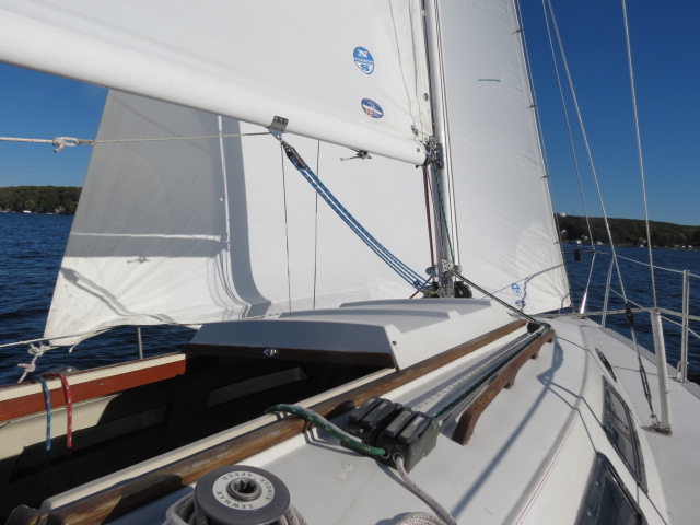

RBone was able to squeeze his deck organizers under the hand rails a bit to line up his lines but my hand rails are a little different so I don't think that is an option.

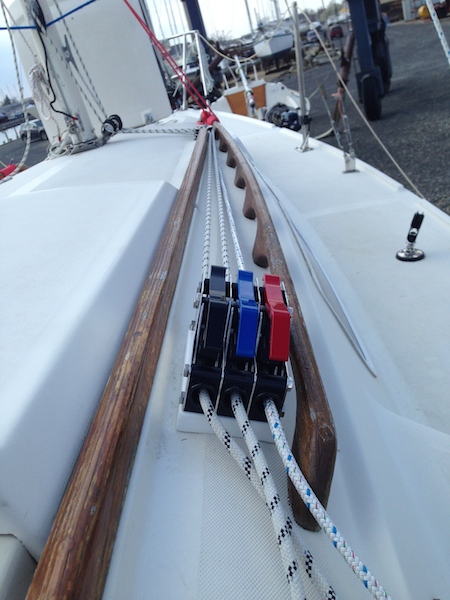

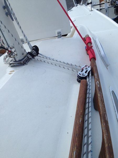

Mine turned out pretty good. Did use a spacer under the rope clutch but wasn't satisfied with the spacer under the organizer. I had already potted and drilled the holes, then found I had the organizer upside down and the top of the bracket was smaller than the bottom. Turned it over and found I had to cut off a bit. Then shimmed it on one side, bedded and bolted it tight. Not much space but doable.
For the rope clutch I found there was a space between the bottom of the deck and the cabin roof. I drilled 3/4" holes and put the washers and nuts inside, then found plugs to cover the holes. It was the same way they mounted the hand rails.

Sorry for the Hijack. these pictures are an immense help. I am doing almost exactly what you have done except I am running two lines through a double deck organizer aft through a double clutch and to a winch on Starboard or port side. THE MAIN OBSTACLE FOR ME is that the Deck organizer has to be mounted directly over my Beam header which is at least 4 inches thick. How the heck can I mount this? Is it possible to tap and drill as I do not think I can find 5 inch stainless steel bolts for through bolting. The other option might be to use a stacking double foot block instead of the deck organizer although this will not solve my problem. Any bedding compound suggestions will be greatly appreciated. Any help guys? Thanks
