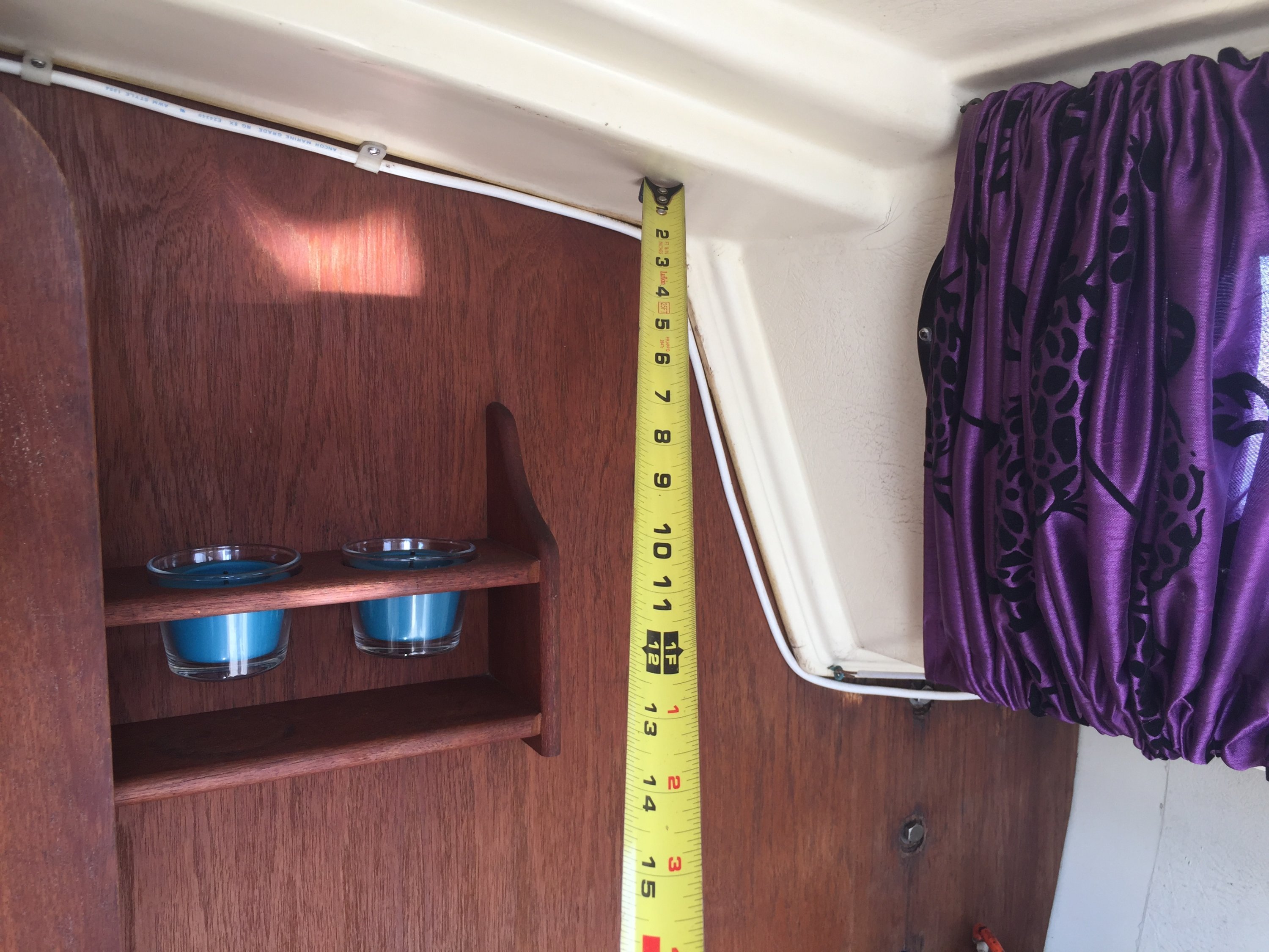

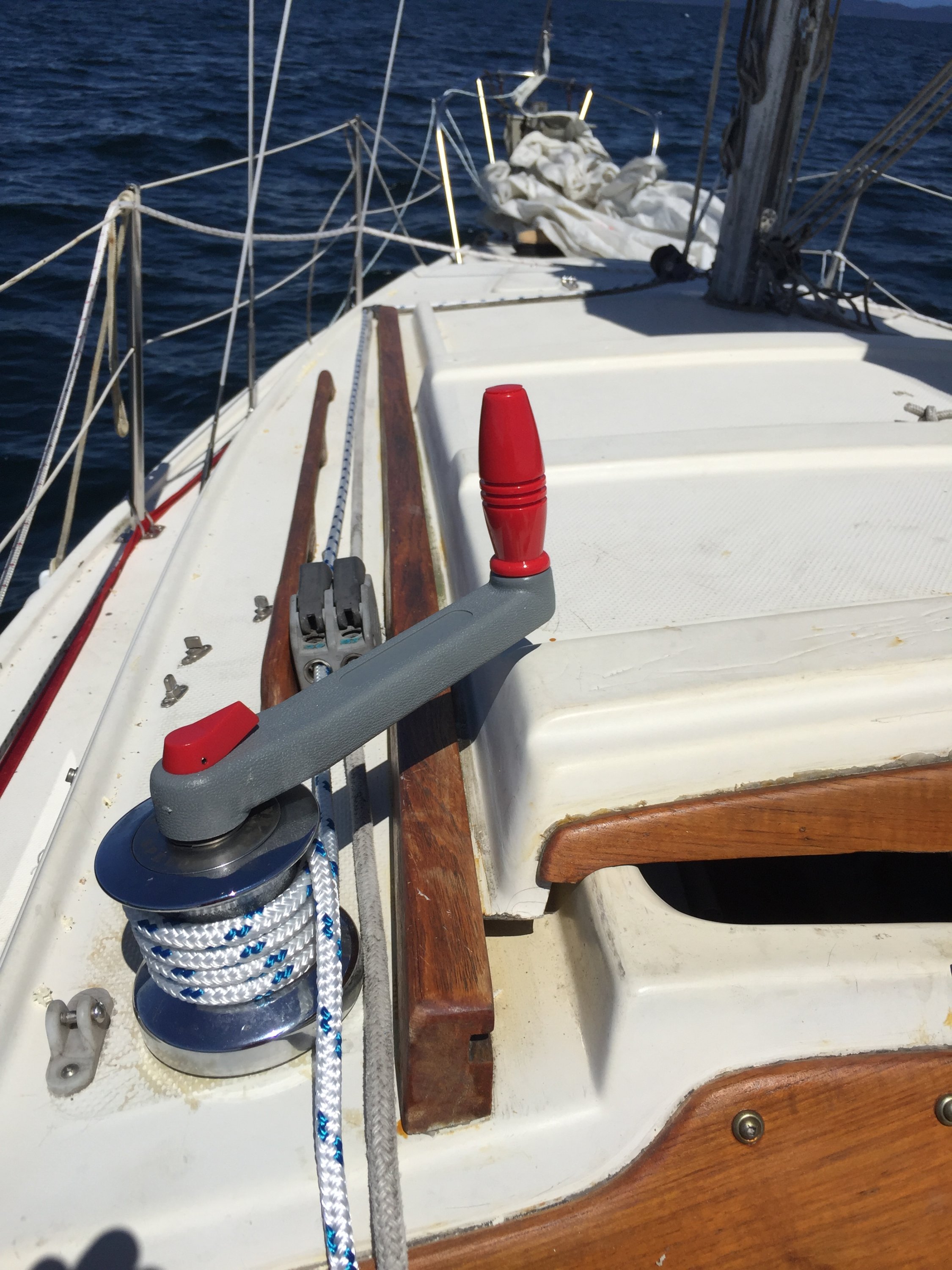

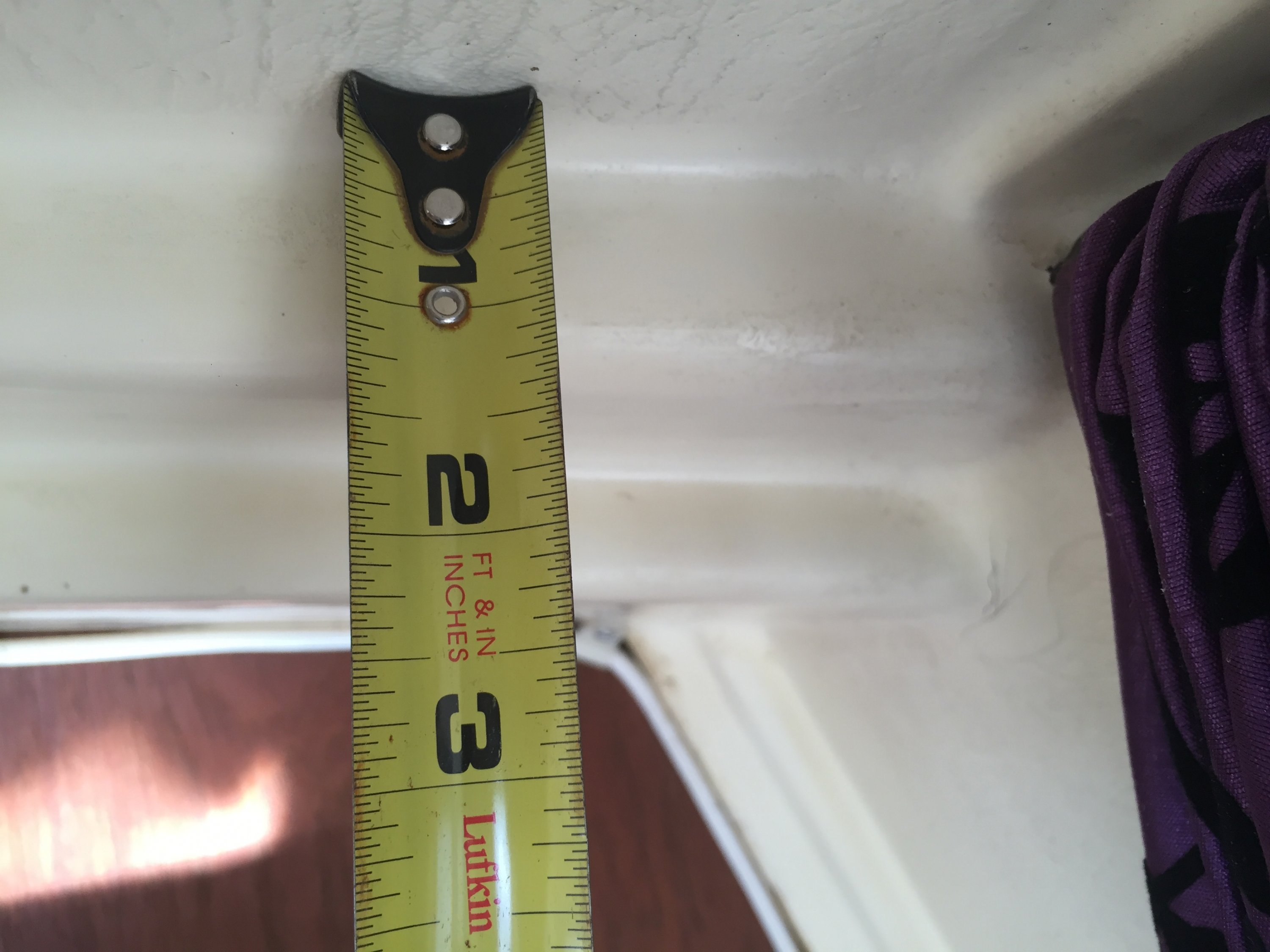

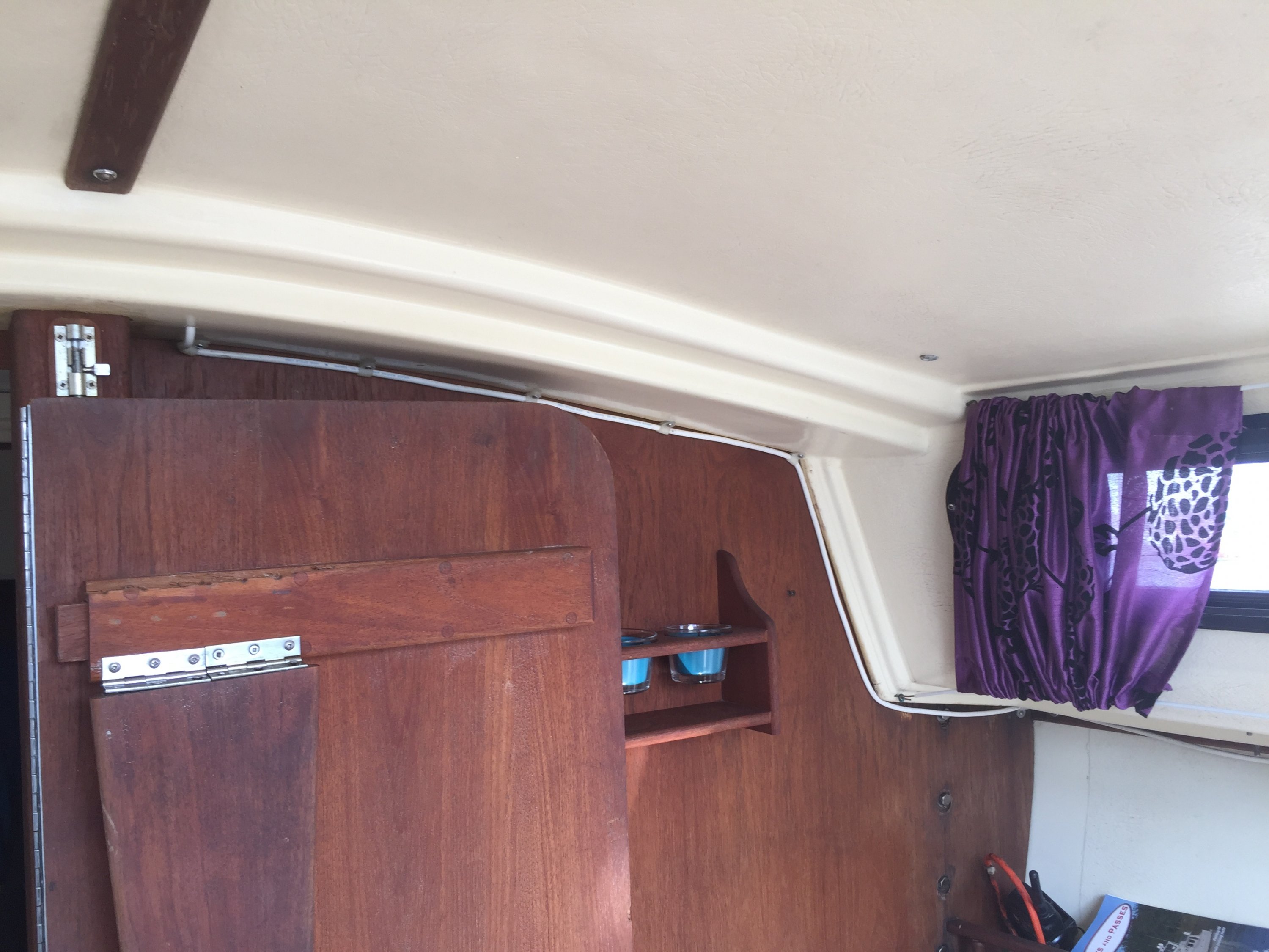

May 16, 2016
11
Catalina C27 French Creek Marina Parksville
IMG_4371.JPG IMG_4373.JPG IMG_4374.JPG Once again thank you CloudDiver for the very much appreciated detailed advice. I still have a concern and will try to post a picture later.. This 3 inch bulkhead that I have to attach my DO to, will make re-drilling through epoxy filled holes very difficult if the drill is not positioned exactly the same angle as the previously drilled holes. As this is the base for my Deck Organizer which will suffer more shear force than lifting force? couldn't i just post fill some inch and a half or longer holes to accommodate a beefier screw? this way I do not have to worry about how the drill exits the back side (cabin side). Or better yet, maybe there is a chance that this bulked or beam or header etc. is solid fibreglass and therefor would only require once drilled through holes with some butyl bedding as there may be no core here? I will try to post a picture later. Everything else is as clear as mud :)
