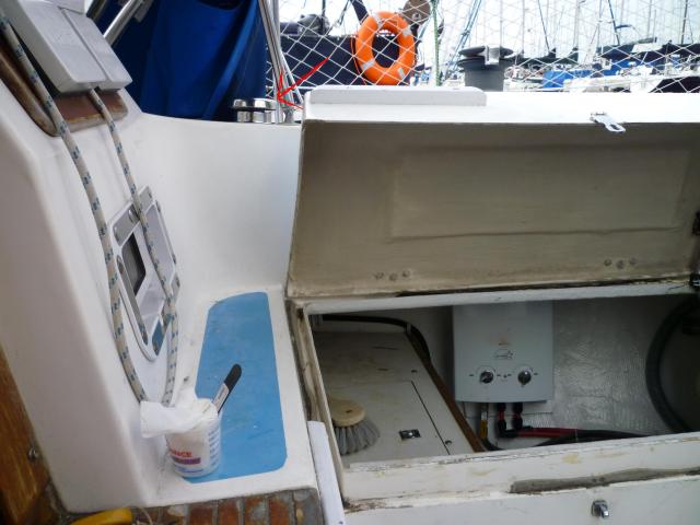

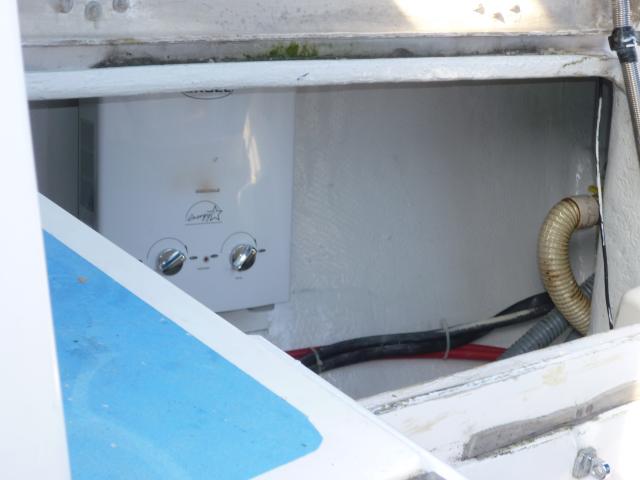

I installed one this weekend
I will do a write up. keep in mind on the safty issue, it is only going to be "on" for a couple of minutes at a time, maybe two mintues x2 for a shower. After install i ran it for 8 minutes continuous with the locker lid closed and these was not excessive heat to the underside of the deck, about a foot above the heater. When not in use the solinoid at the propane tank is going to be off, just like when using the stove.

Stephen, I sent in a "owner modificaiton article" today. But generally, given a "hand test" under the shower head, I would say just enough water flow and heat to make the thing worthwhile. I ran the heater with the flame on high and the water flow about 50% , so about .6 gal/min, so no blasting shower.

Stephen, I will try to get actual measurements this weekend re flow rate and temp. Yes the hot water tank had cold water ( maybe 50 degree) in it when it was runing thru the tankless heater. I think it takes a day or so for the articles to get posted.

Using a thermometer, I determined the following: The water temp supplying the tankless heater was 54 degrees. The full flow rate for cold water was 2.15 gal/min ( kind of odd, since the water pump is a 3 - 4 Gal/min rating); With the flame on highest setting the heater produced 112 degree water at .75 gal/min, at 1.3 gal/min you get 98 degree water, but if the flow is reduced to 1.2 gal/min you get nice 105 degree water which is just right for showering and 1.2 gal/min is a nice frugal flow rate.
The tankless heater is in a locker, so I added a passive mushroom vent to get some heat out of the locker. Heat wasn't a problem after running it on high flame for 8 minutes continuous ( about a minute continuous should be normal use) with locker lid closed and the oxigen sensor did not shut the heater off, but the locker draws air from engine compantment and thru the stern lockers and the passive vent was discharging warm air.
