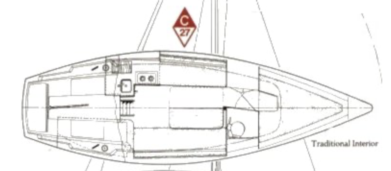

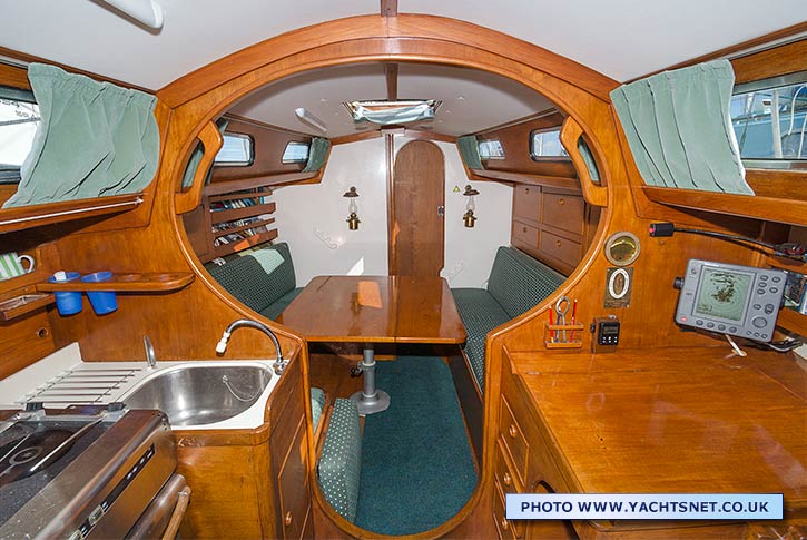

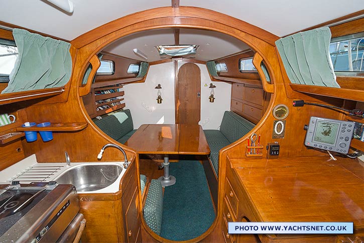

You could keep the bulkhead, but still open up the space like this. You'd probably still be a compression post or beam.
xavpil
Sep 6, 2022
376
Jeanneau Sun Odyssey 419 Milwaukee
Totally! That's what I had in mind. I know I should keep part of the bulkheads, no doubt.
This is definitely a nice example . Thx!

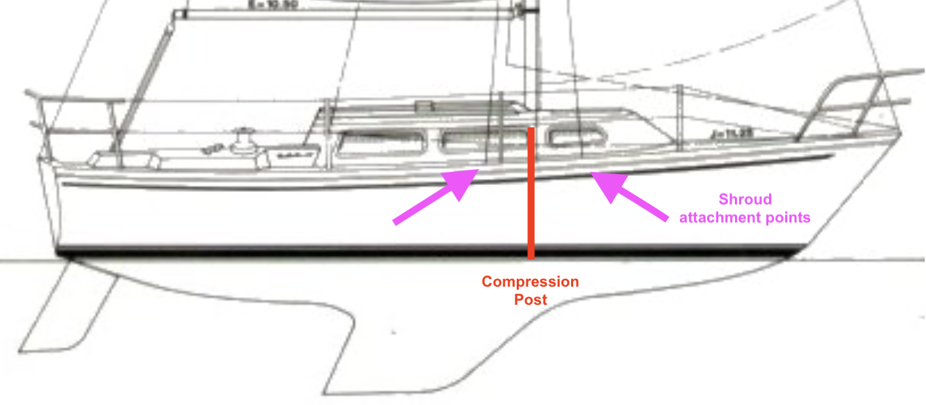

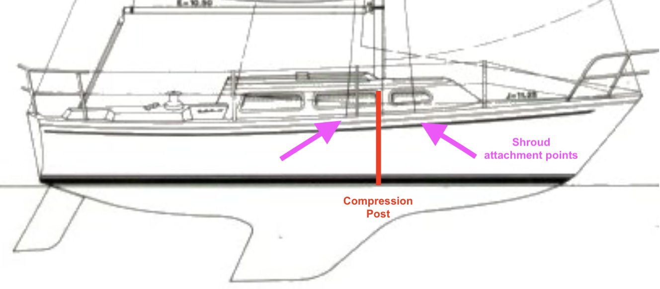

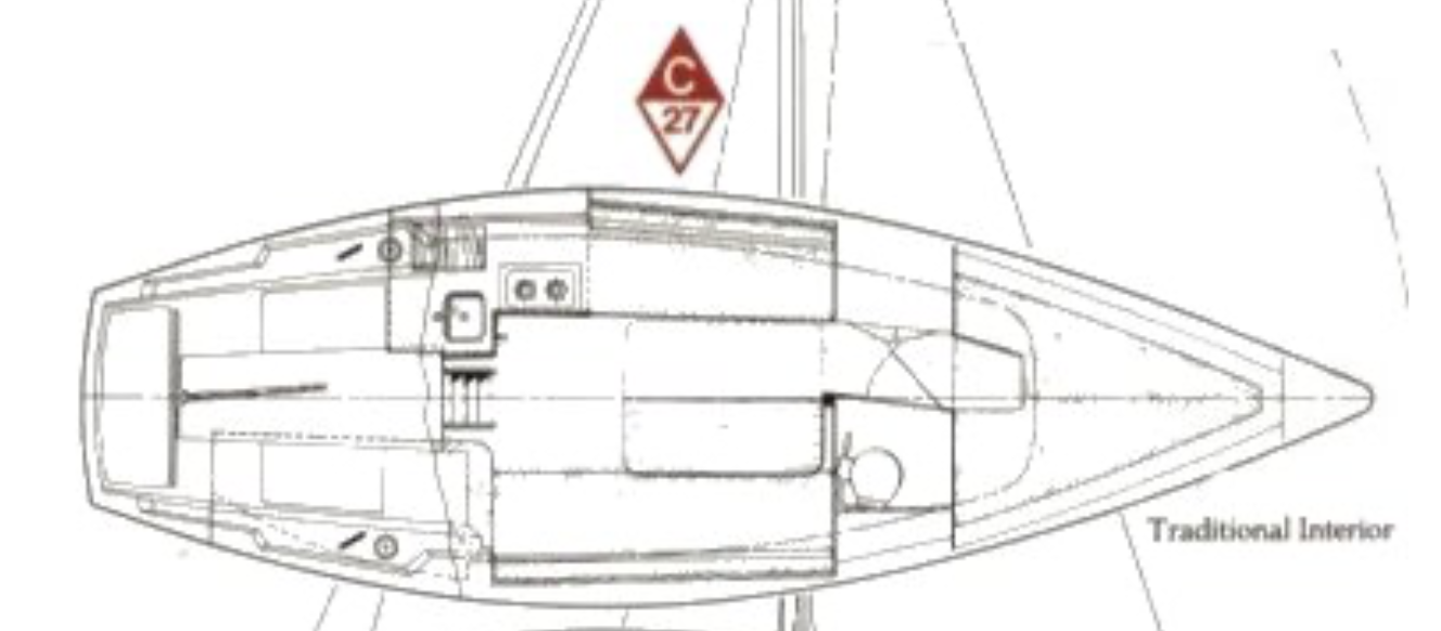

There are some structural design considerations necessary before you warm up the saws-all and jump into the cabin.
The bulkheads you X'd are positioned to provide structure for the hull.
In these to images you can see the design of the port/starboard shrouds. They not only hold the mast laterally in place they draw the hull upwards against the mast. The mast is forced downwards against the keel transferring the forces of the sail to the hull. Those bulkheads press outward against the hull to maintain the structure and shape of the hull. Remove them or weaken them and the hull will fold inwards causing the boat to fail like a house of cards.
Note how the shrouds attach on either side of the bulkheads. The bulkhead on the right serves to enclose the head but it also serves to strengthen the cabin roof holding up the mast and hold out the hull from collapsing due to the connection of the shrouds.
