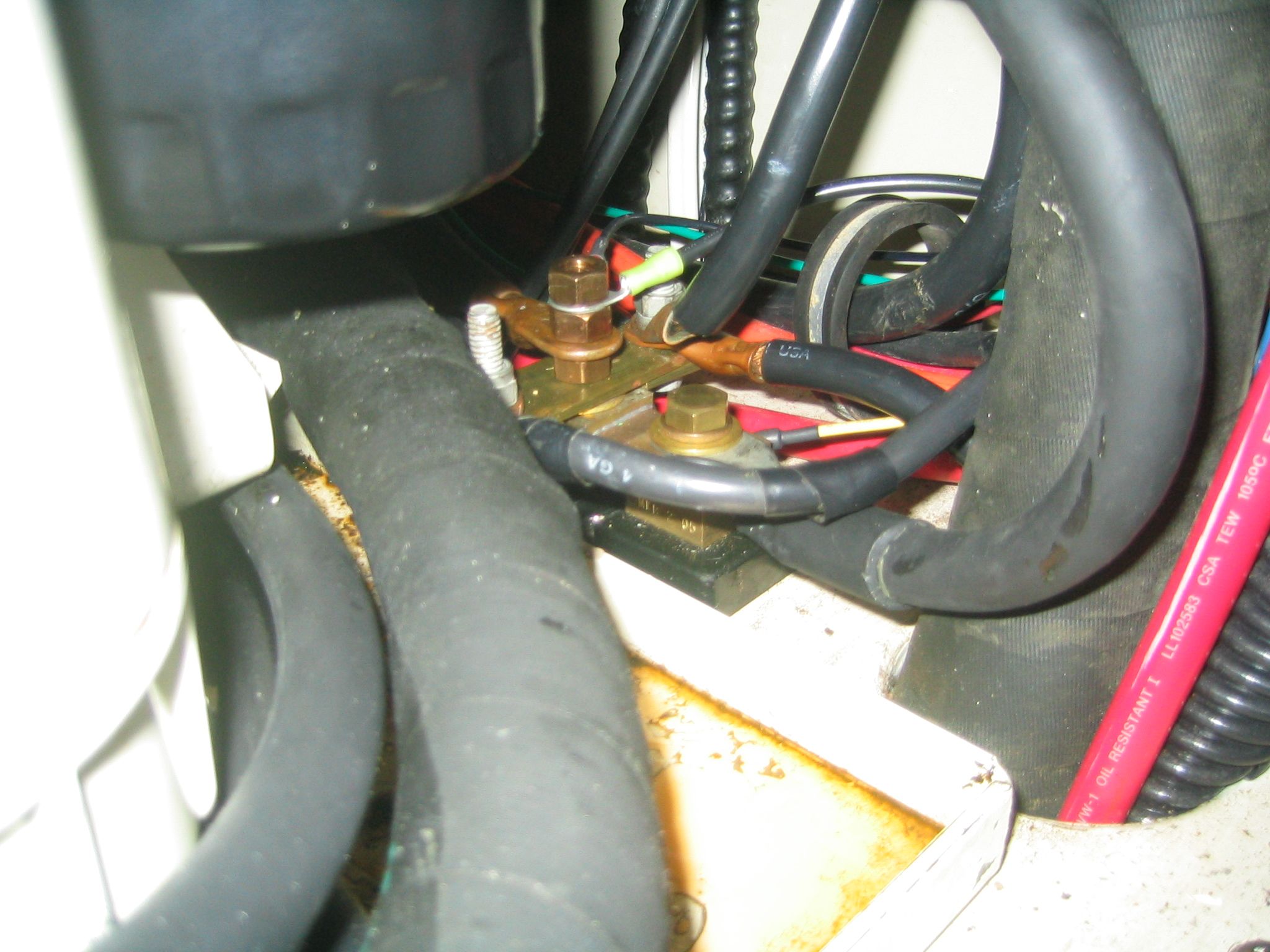

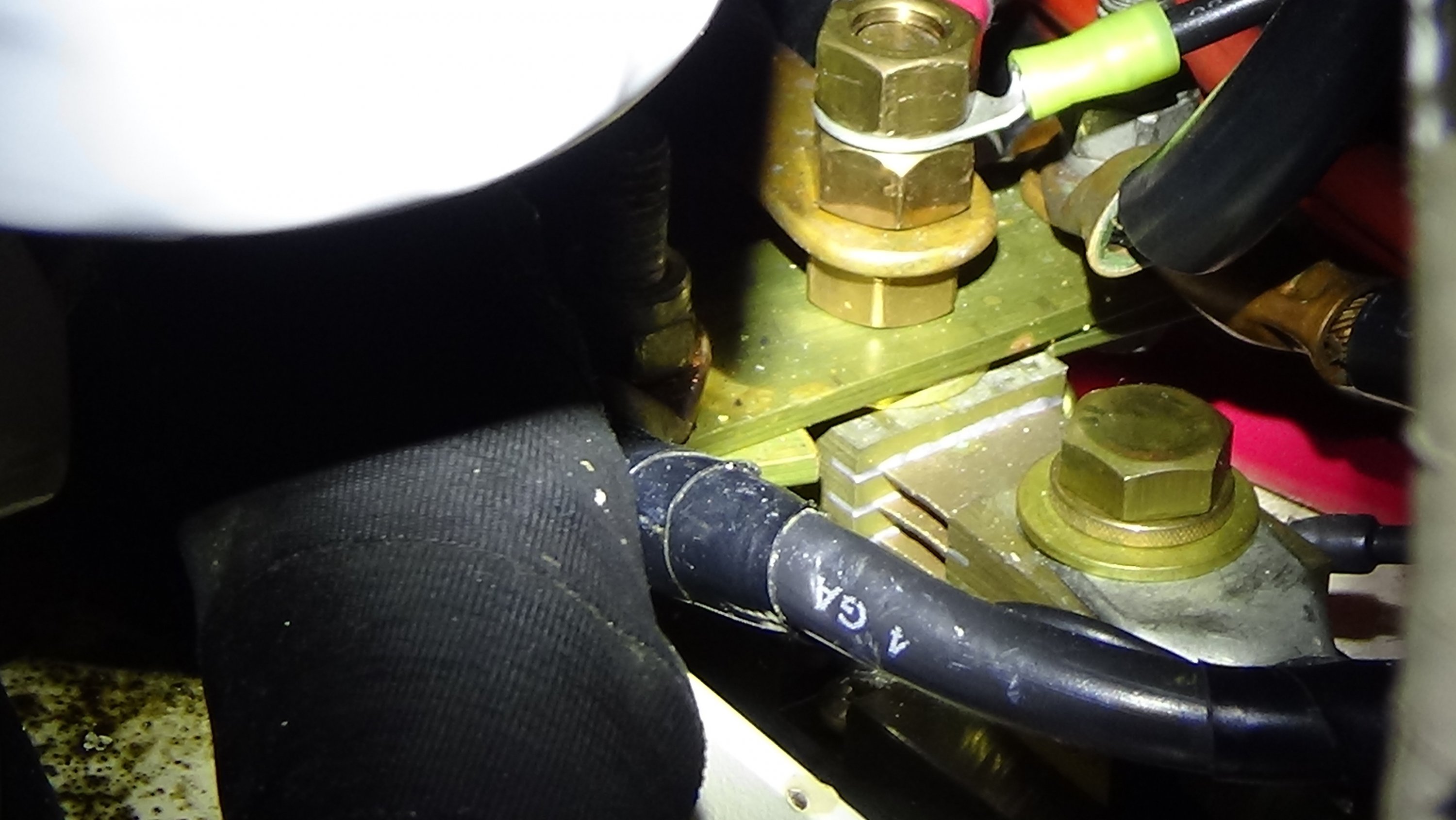

Having more than 4 terminations on one post is a no no. so how to do it with the wiring limits I have is challenging me.
Hi John, had the same problem when I installed the Link1000 on our boat a few years ago. Lots of ground cables and not enough room on the battery post. So, what I made was a buss out of brass bar in the shape of a cross that I purchased at a local metal fabrication shop for about $3, which gave me four mounting points plus a fifth in the center. Hard to tell from the photo, but I mounted the buss bar on the battery shelf, one cable from the ground post terminated on one side of the buss bar, with several ground cables terminating on the other sides. Some had two; one on top one underneath. This has worked out well and solved the post problem.
In order for the Link1000 to deliver accurate battery stats required a shunt. The shunt had limited terminal space, too. It was important to have the single main ground from the boat to one side of the shunt and all other ground cables to the other side of the shunt. The brass buss bar made that possible.

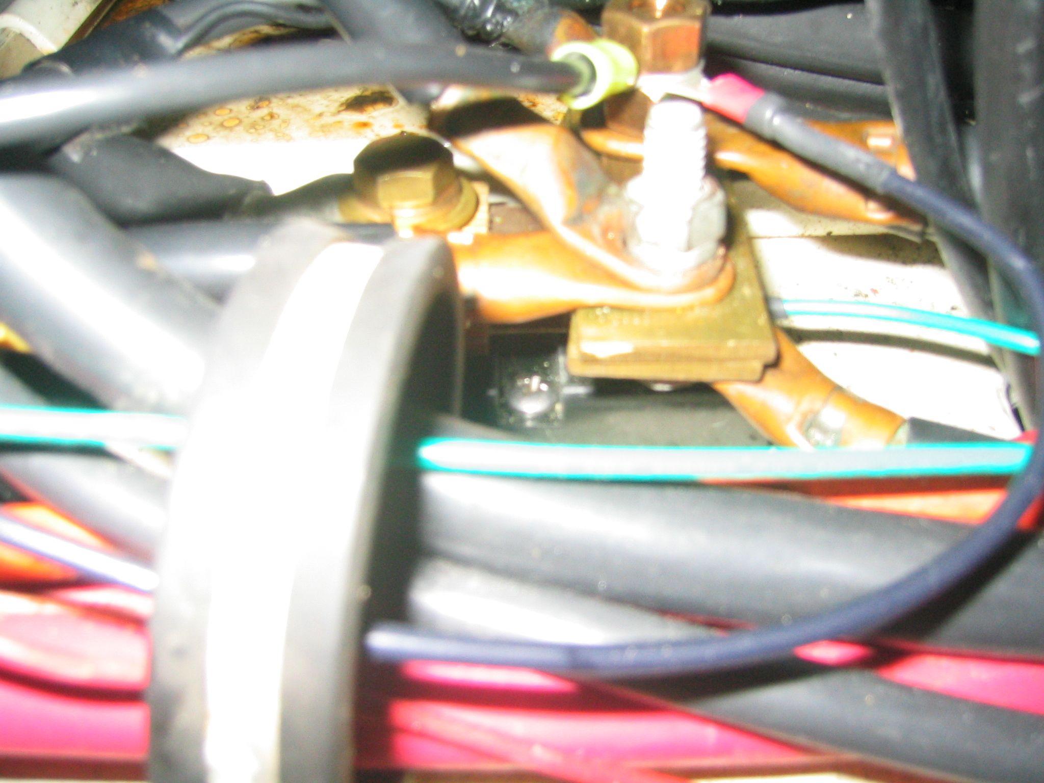

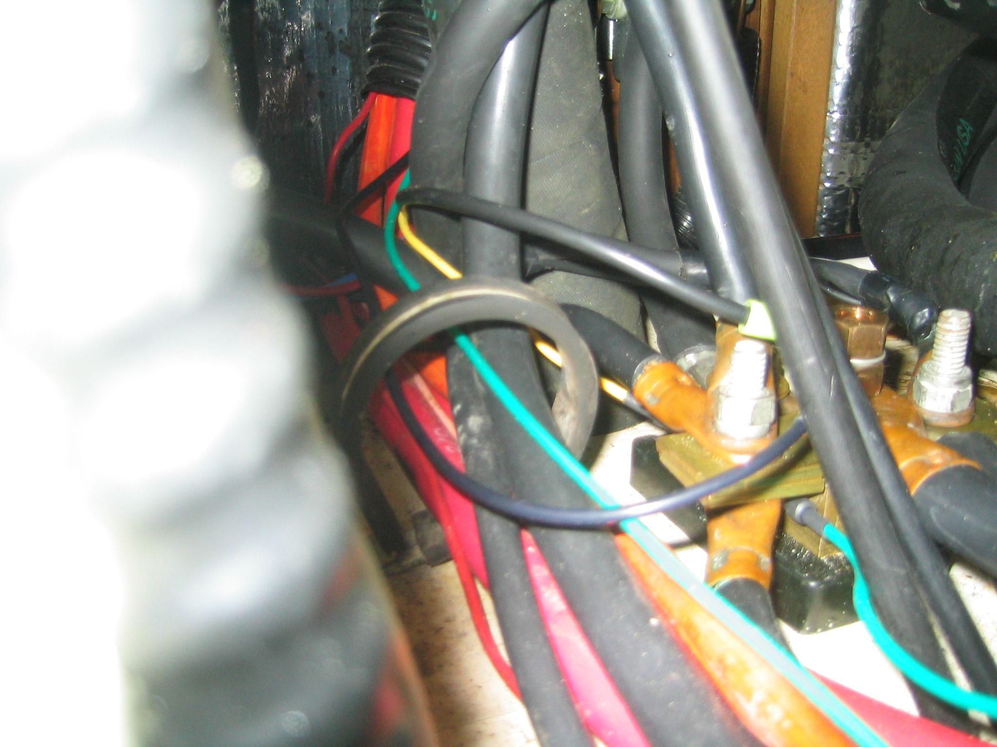

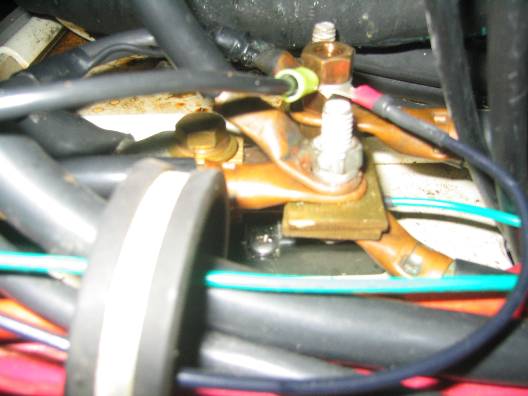

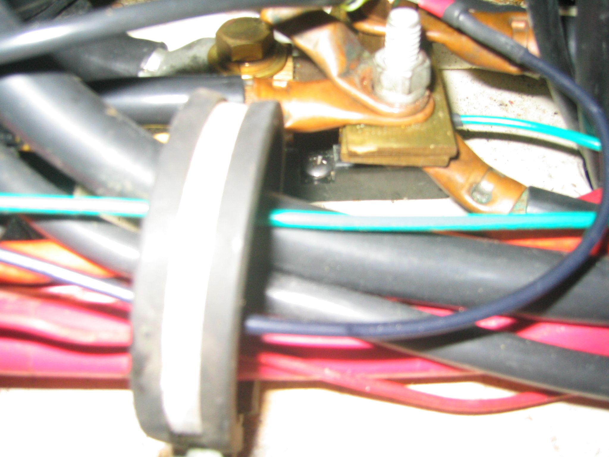

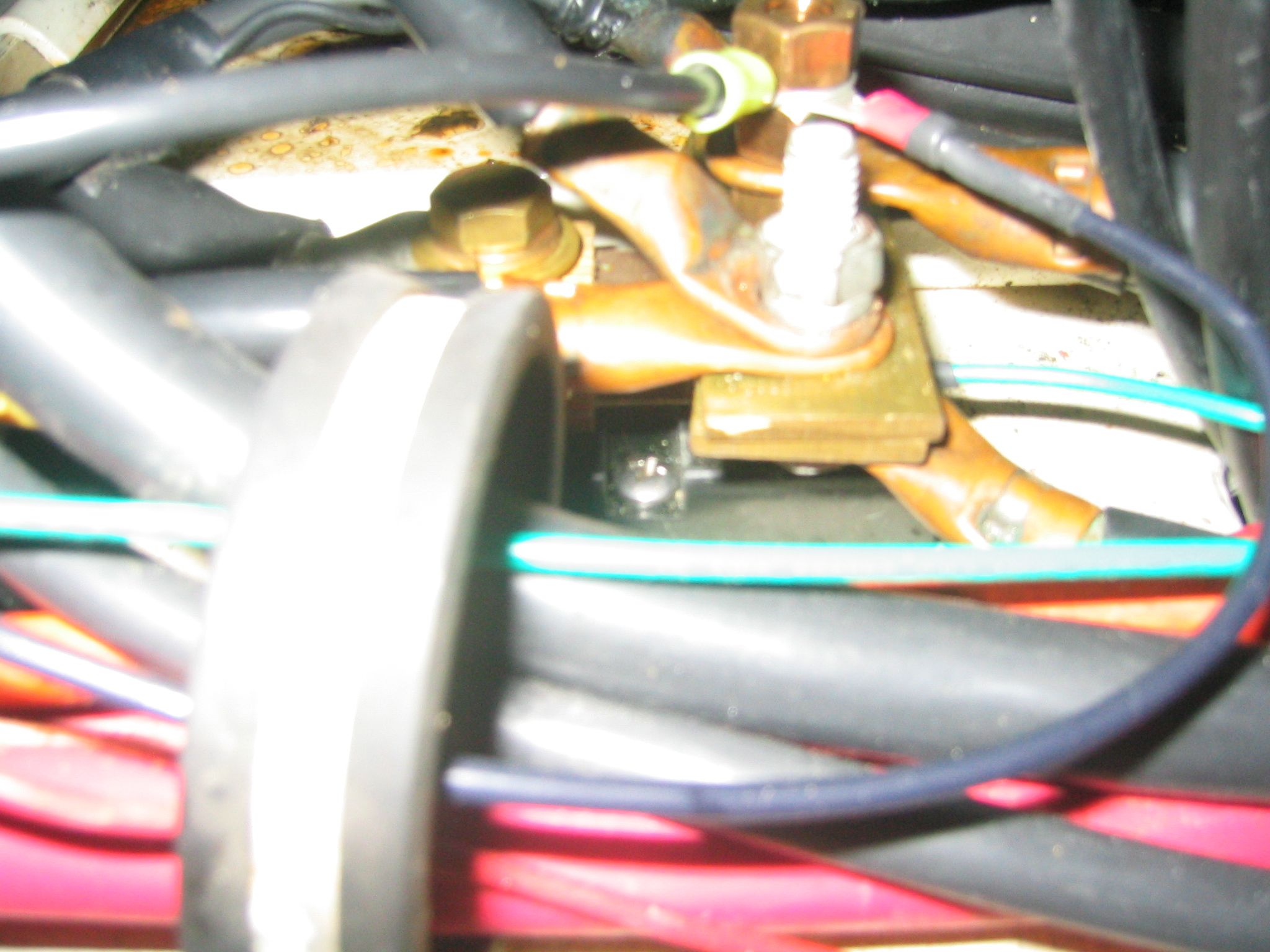

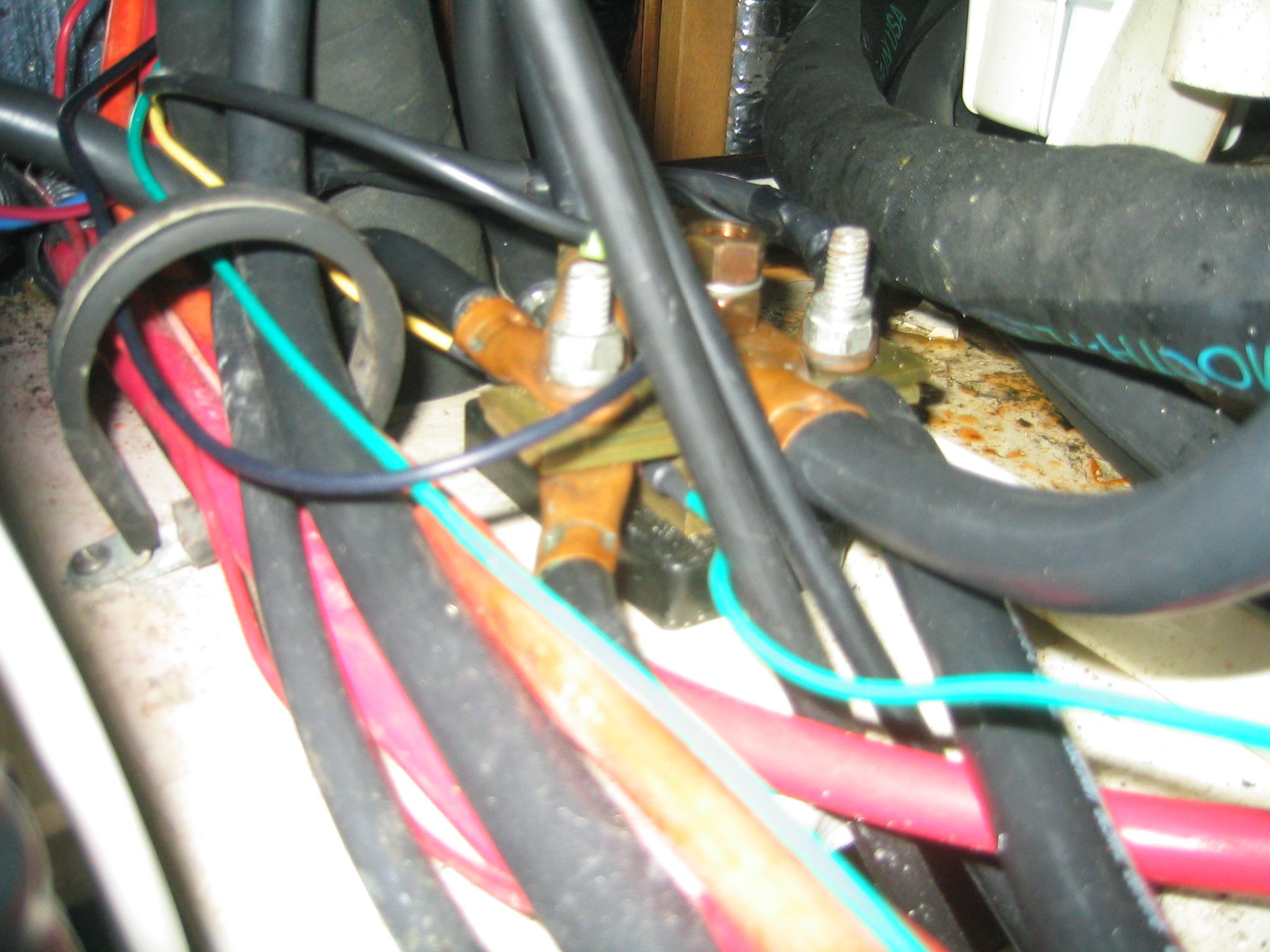

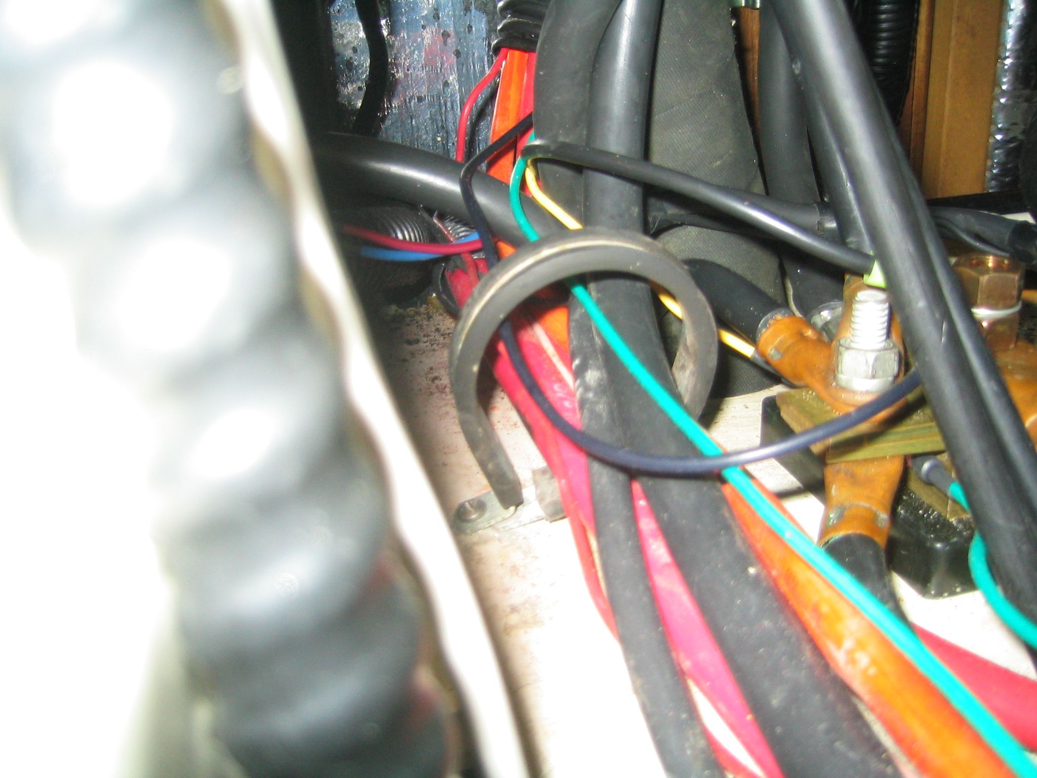

Wanting to get through to winter when I plan to do complete electrical refit.
#1 Remove dead batteries and label where wires came from. Clean up battery compartment.
#2 Trace those wires to the source & relabel if necessary
#3 If wires are undersized, corroded or wrong color for the load or charging device replace them with proper size and color. Red = DC Positive, Black or Yellow = DC Negative. Almost always easiest to just rip it all out and start from scratch.
#4 Replace all battery cabling all they way from starter and engine to switch and batteries.
#5 If battery switch is more than 10-15 years old replace it.
#6 Crimp all terminals with the proper crimp tool. None of the pictured crimps were made properly
#7 All wires connecting to the house batteries (maximum of four wires per terminal but preferably 3 or less) must have fuses.
#8 If you don't have access to a proper battery lug crimper, and hammer crimps are not "proper", measure and spec lugs carefully and have genuinedealz.com make your cables.
Bonus:
Use a negative busbar, positive switched busbar and positive unswitched bussbar (bilge pump etc.) to keep the battery terminals uncluttered.
Label every wire using a label maker and clear heat shrink.
Run alternator direct to new house bank.
The charging supply appears to come from the unit I'm calling an "Echo" unit. This appears to be from 40 years ago and looks to me to be functioning like an echo charger. The only wires connected to this thing are the two positive large wires from the batteries, a wire from the alternator, and a large gauge wire to the start motor.
This is most likely a diode isolator. Rx = Remove it and trow it in the dumpster....

As said before a diode isolator needs to have the voltage regulator boosted to compensate for the extra voltage drop.
If you are taking the isolator out , be sure to check the voltage from the alternator and set it back to normal if necessary. Check before you take it out on all terminals to know what you have. Then check after removal.
If your batteries at the same types and the voltage is set right, a diode isolator is a good solution. Reliable, as it has much fewer parts.
Different types of batteries and/or different charging sources (solar, etc) would be best served by a much more expensive charge controller system.

Hi John, I need to update a couple of things from my previous post and pics. The first part is that when I installed the Link1000 it included a shunt. This shunt has two posts, one for all ground cables or ground sources incoming to the shunt. The other post was for the main boat ground outgoing from the shunt. A better picture of this arrangement is as follows:
In the above picture what you see is the shunt mounted on the battery shelf. The nearest bolt head is the mount for the main boat ground and is the only ground cable connected to this shunt post. The one next to it that has three nuts is the shunt post where all incoming appliance ground cables mount. That brass bus bar that I made is beneath the lowest nut and it mounts on the shunt post where all incoming ground cables mount. As you can see in the picture two ground cables connect to the right side of the bus bar and two on the left.

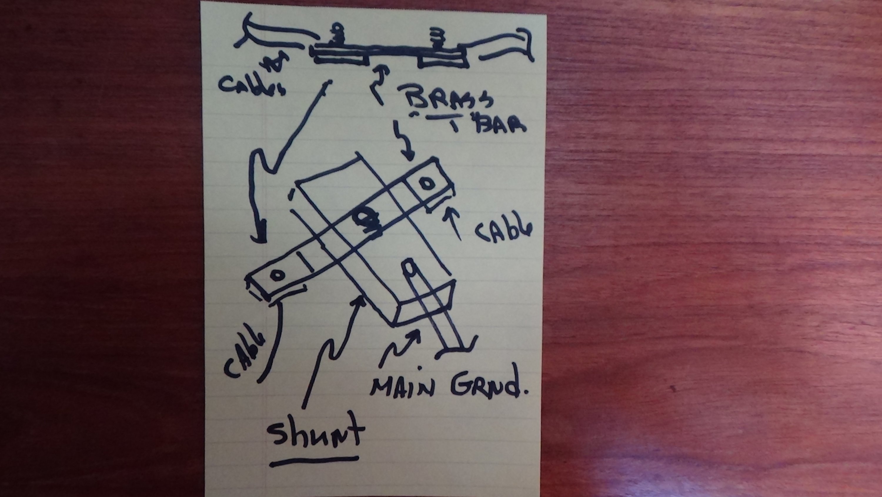

The drawing below shows the "T" bar that connects to the shunt. I placed the small square pieces of brass bar underneath and on either side of the main bar to help prevent the main bar from rotating. Not that sophisticated, but it works and I have a Link1000 that delivers a very accurate battery state.

Most of your wiring should be reusable,
I think I read this a a 1974 vintage boat. When I did some rewiring on my 1985 boat, I cut open several wires well down the line, 5 to 10 feet from terminals and found plenty of corrosion. I dont think I would reuse much, if any, of that bosts old wire.
23,828
Thank you guys. Appreciate all the help and ideas.
I got into the dark corners of the boat. I found that the heavy gauge wires , I thought went to an Echo device actually goes to the battery switch "Off, Bat1, Both, Bat2".

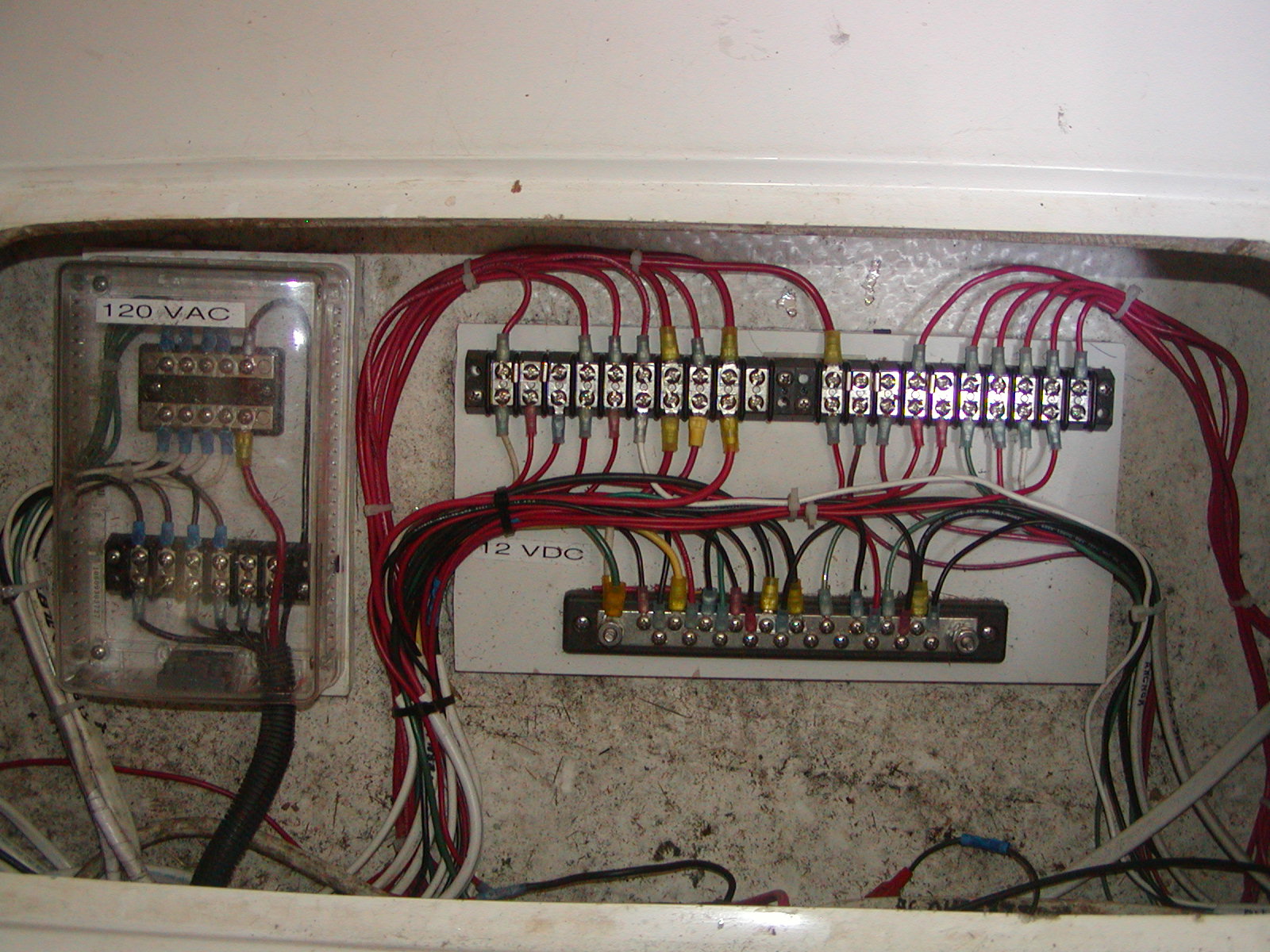

I had to untangle my original wiring and decided to install terminal strips. All my boat wiring heading for the circuit breakers first lands on the terminal strip. The circuit breakers which are adjacent are connected to the terminal strips with short jumpers, neatly organized.
