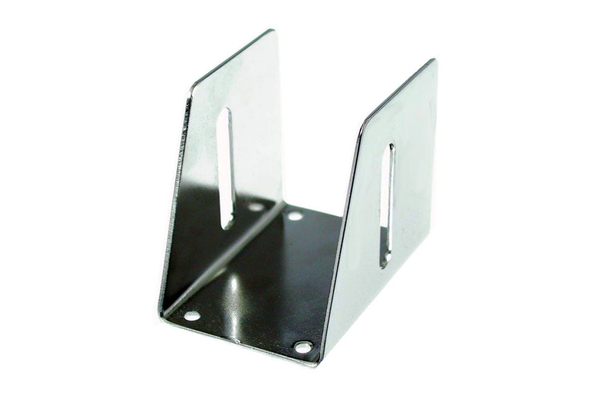

Not knowing anything of the boat it is difficult to guess what the original was, here's a picture of one for a Capri 16.5 as an example of a very simple design, others can be more complex.
View attachment 208547View attachment 208547
Yes, the boat had one of those but somehow in transit from Mass. it got lost. My cousin transported the boat to me. He says he does not know where it went.

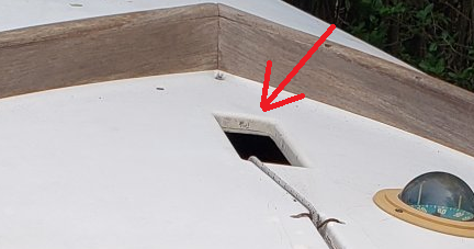

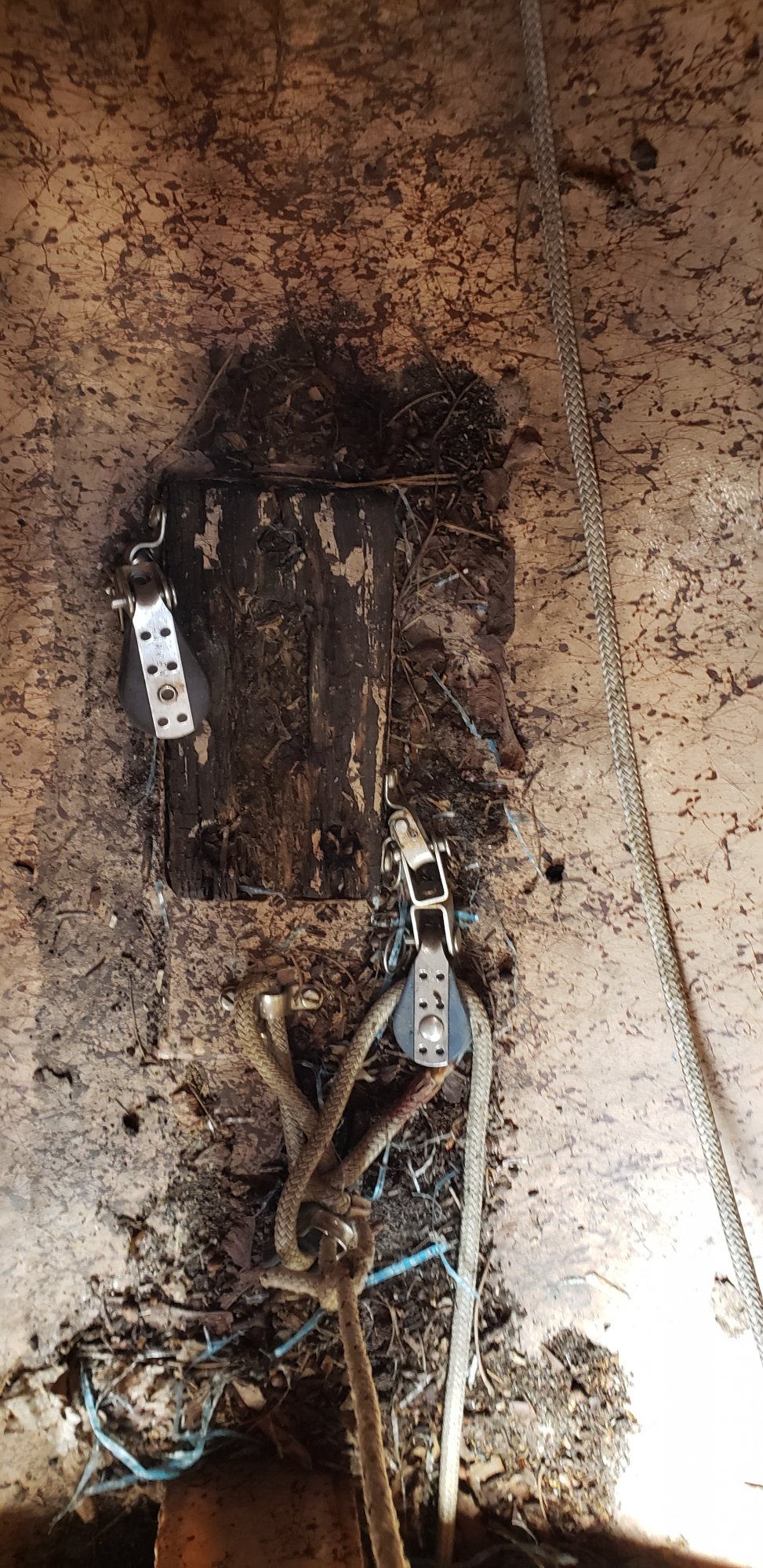

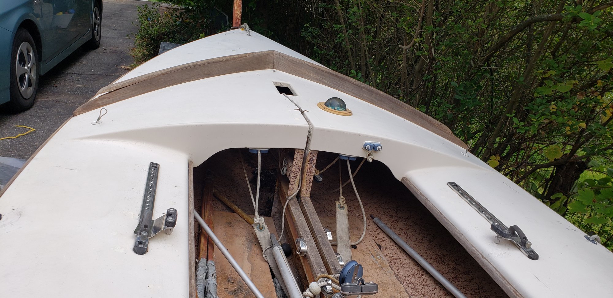

Actually I think you have a more traditional setup. It looks to me like you have a wooden square mast that fits in this hole
... and your deck serves as the mast partners. Is there a receiver "box" at the bottom of that hole? Also it may be possible that you had an unstayed mast for this boat (that would be kind of cool). Do you see chainplates for the shrouds or stays?

I have zoomed in on your pics and I don't see any sign that you had a tabernackle through bolted on your deck. I'm sticking with my guess that the mast fits through that hole and is secured by a receptacle at the base of the mast.

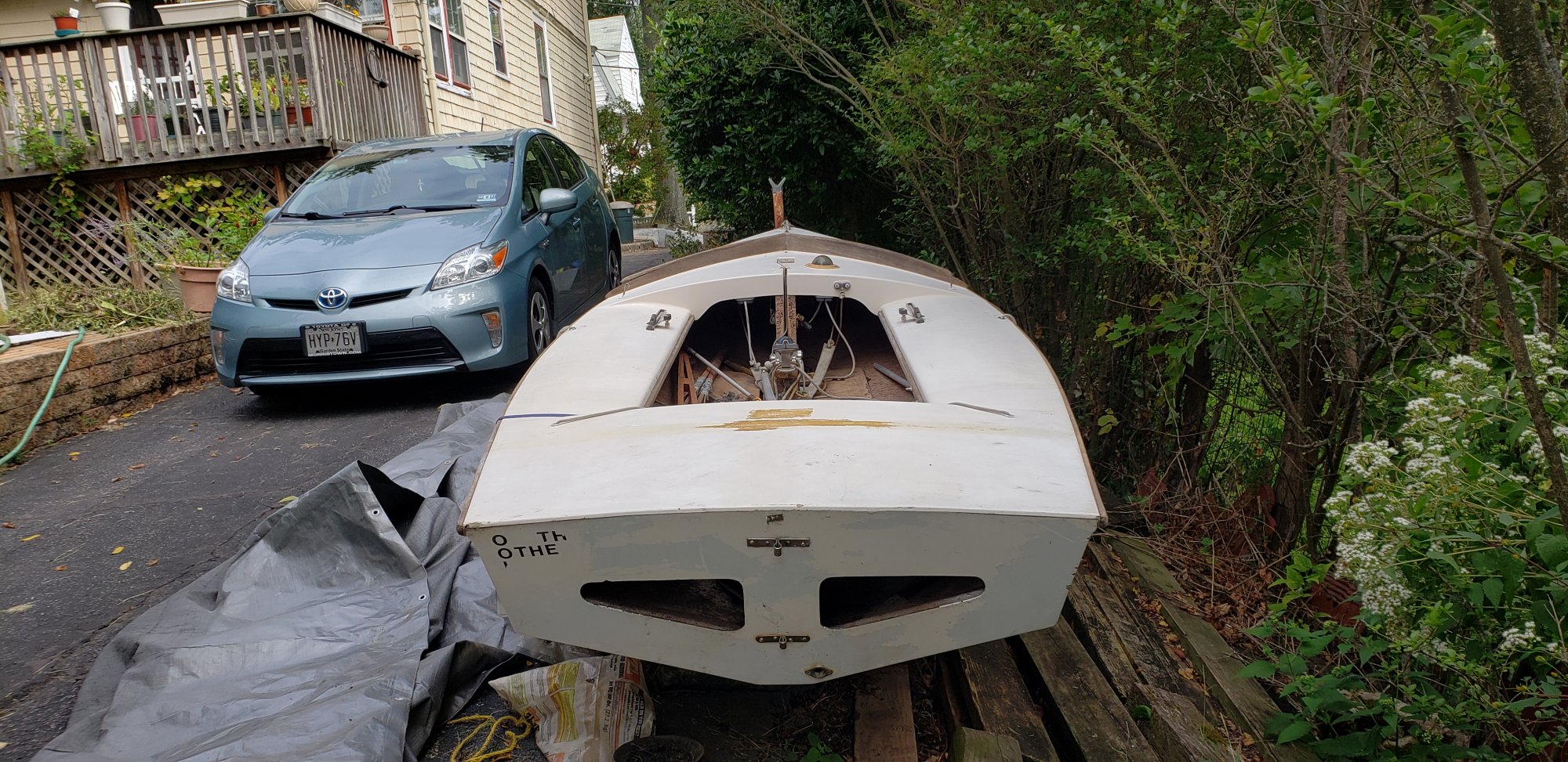

The amount of times you see newbies show up in forums, and say that... when trying to identify their mystery boat.. And then eventually finding that there Is a number or something someplace, is exactly why people ask.
That said, that boat looks homemade, and will likely require using "whatever fits" or making something, like the original builder did.
No I do not. The 24 ft aluminum mast goes through the hull and into a hole on bottom of boat. There ARE clips to secure it around the hole and the mast has a "nipple" that seemingly would fit into a metal receptor.

I've been wrong enough today but is it possible that the nipple fits into the rectangular opening in the deck?
If there is standing rigging that would probably be adequate as a mast step. Setting a 24' mast in there would be a bit wonky. You may want to add a tabernacle.
A Lightning is 19'. This boat is 17'. The Lightning has a 24' P and the boat in question has a total mast length of 24' (As reported by OP). Maybe it's a smaller knockoff done by another designer. They do look pretty much alike. In the picture above I think there are drains in the transom.
