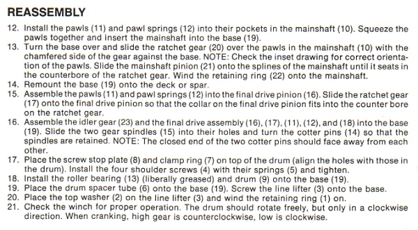

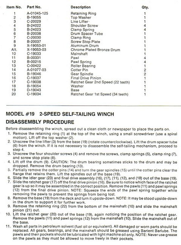

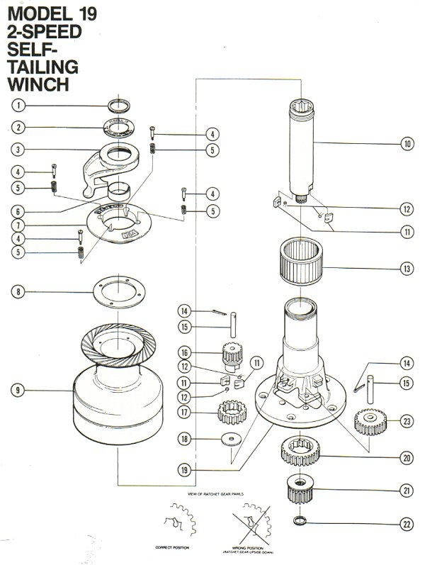

jssailem may be right. We had Barients on our last boat and it was easy to put them back together so nothing worked. Directions are wonderful things.
Likes: jon hansen
May 29, 2018
661
Canel 25 foot Shiogama, japan
Re: When I snug down the top nut the line lifter binds on the heads of the shoulder screws that are below it.
I can see the shoulder screws in Jsailem's manual, but no "top nut. "
It looks like the winch is held (down and) together with the "retaining ring".
Is that the correct manual?

I have that parts blow-up too and my winches have a top nut with two holes for a spanner wrench...and I haven't found a diagram for my exact winch.
