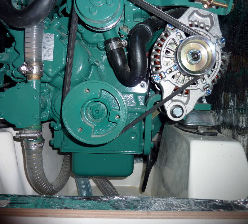

This is a 2012 $400,000 vessel:
If there is, this is what should be addressed not what type of antifreeze is being used.
I would much rather see a rubber hose here but the reality is that many builders use hoses that are not rubber in the RW intake system..

I find that sort of clear hose rather disturbing in such an application; limited chemical resistance, limited cut resistance, limited heat resistance (it may be on the cold side, but is near the engine), known tendency to harden over time or in the cold, used in a place that can flood the boat. That's just cheap. CG rules cover fuels and exhaust, but I guess not this?
Certainly in light of all the matriculates work that has been done on the engine's appearance.

I guess it's been put there by the manufacturer? They DID at least double clamp the intake side, with Awab clamps, and again, got cheap on the single clamp on the water exhaust.
People "cry the blues" about China junk, (and I do too), but this is another example of why everybody bought Japanese in the 70's and 80's. I know that it is a very competitive business in boats, and most other things, but we can't keep building junk.
And this could be yet another case of planned obsolescence by the manufacturer...

That was a brand new boat hence the clean engine. I took the photo on VIP day at the Annapolis Sailboat Show this past October.... Sadly this builder is not the only one doing this.. I agree it sucks but it is what it is and the largely uneducated boat buying public don't complain enough to get building practices like this to stop...
If I had my way PVC hose of ANY TYPE would be banned for below water and any engine room use..... Hell if I had my way it would be banned for sanitation & domestic plumbing use too....:D
