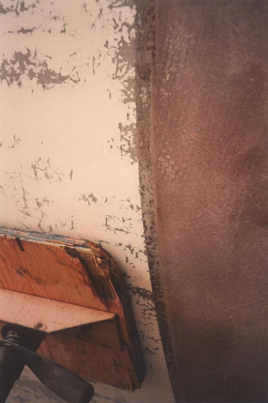

Here's a pic that shows the process I've described: A laminate surface after the failed gelcoat and failed mat were removed (R) and it's appearance following the application of new 1.5-ounce mat using VE 8117 and finished with Cook's sanding gelcoat (L). I did this work on my Sabre 28 and, while more difficult than simply rolling on several epoxy barrier coats, it's not a difficult process. Most important it's worked perfectly for more than 20 years.

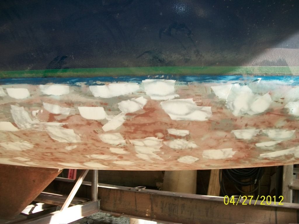

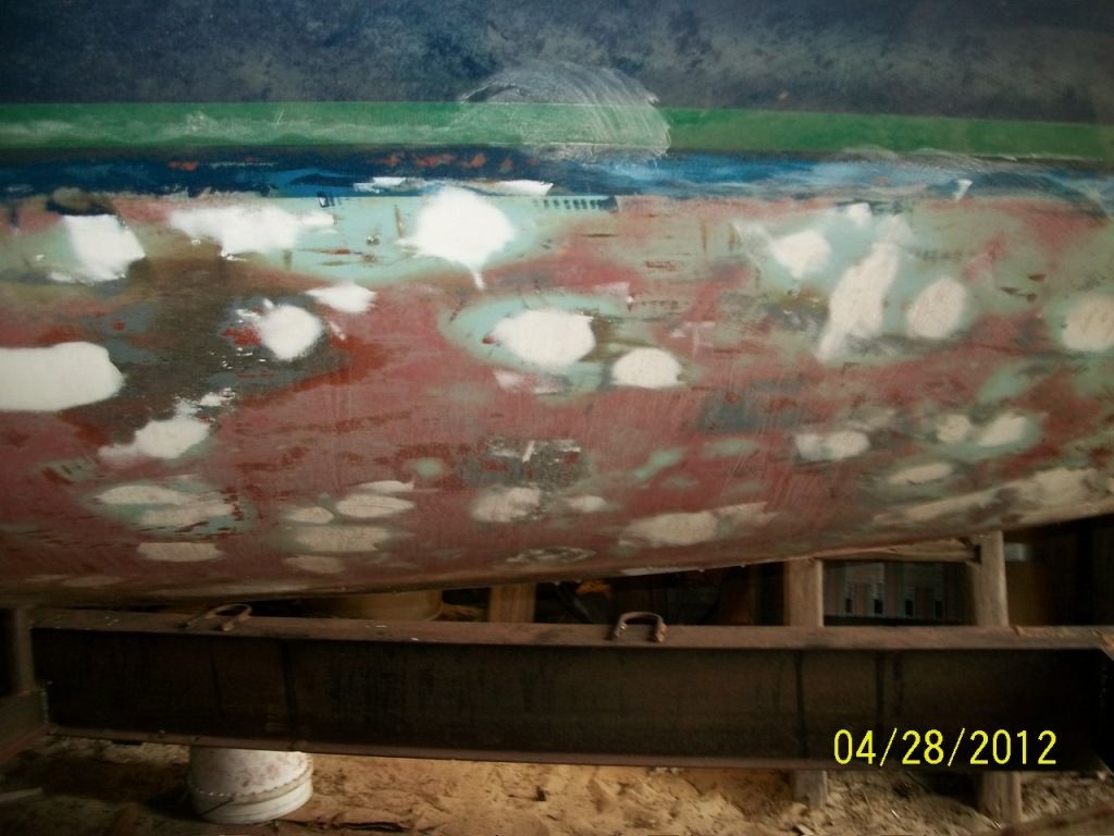

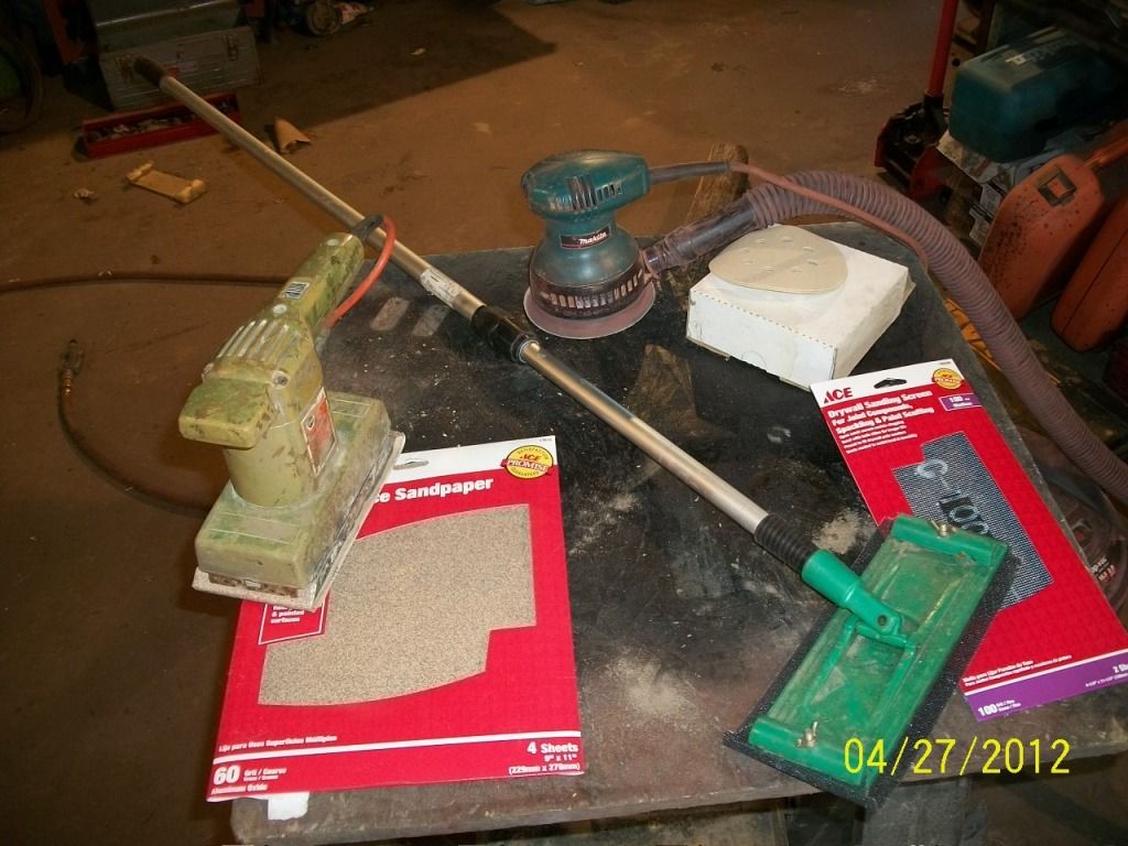

OK I have applied my first coat of filler to many of the deeper divots, I'm sure I'll do a second for the ones I missed...
Next I laid out my weapons for fairing the surface smooth...I would prefer the random orbital for the dust collection aspect, but the sanding pole with the abrasive screen is supposed to produce a smooth finish with minimal mess when "wet sanded"... My fall back is the 1/3 sheet orbital which is known to produce a smooth finish , but creates a lot of dusty mess...
I'll do test spot comparisons before I get fully into it to see which tool actually works the best for my situation...

I'm kinda likeing the effect of wet sanding with the pole sander and abrasive screen...
Going from filling to wet sanding is really blending and smoothing the surface without multiple coats of primer and glazing...(I've bondo'ed a lot of old cars up here in rust country)
I don't know if you can see it in the picture but the filler has been blended.faired down to surface level high spots are coming down and sanding scratchs are dissapearing...
All with minimal mess and from a comfortable standing position...Thanks for the tip Gary...

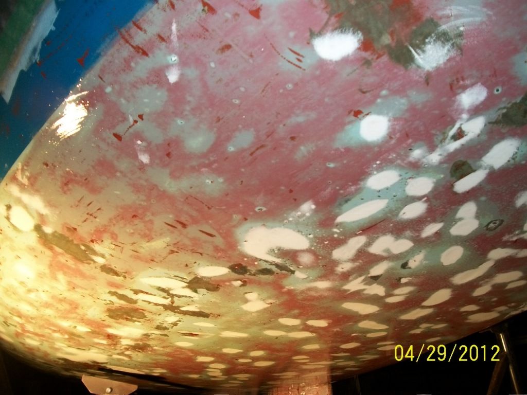

It's coming along nicely... two coats of filler dry sand, wet sand and now starting to apply first coat of epoxy barrier coat...
Really smoothed out from the lumpy mess I started with...

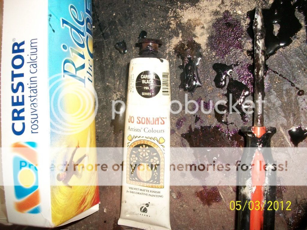

OK so I tried a second coat of clear epoxy today...
Clear over clear is still clear... I could not "see" what I was covering/missing so I stopped after a few sq/ft..
Spent the rest of the afternoon "scuff sanding" the dry clear coat hoping the sanding scratchs will guide me as I apply second layer...not totally convinced...
What i would like is to "tint" the next layer so I can "see" where/what I'm covering...
What can I add as a "tint".. I read on google a small amount of artist oil paint woiuld work, mixed with epoxy resin...I have some...any other suggestions...?

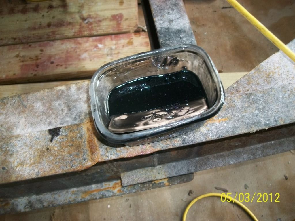

I don't know why I didn't think of it eariler...Carbon Black...about as inert and you can get...
Couple drops toned a batch black...just enough to see the new coating...
Two coats epoxy abour 12 to 16 mil barrier on top of fill and fair...starting to look presentable from what I started with...

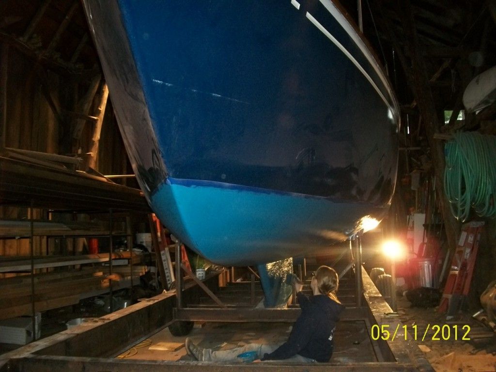

Finally got first coat on...
One more coat and then a new waterline stripe...

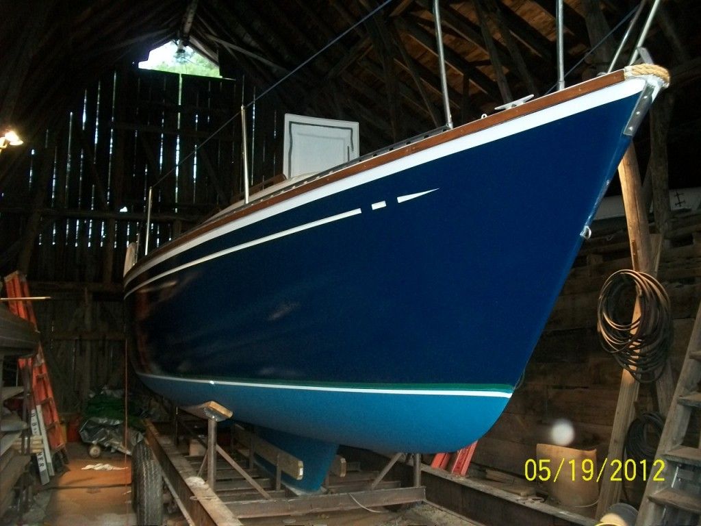

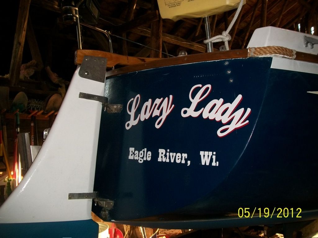

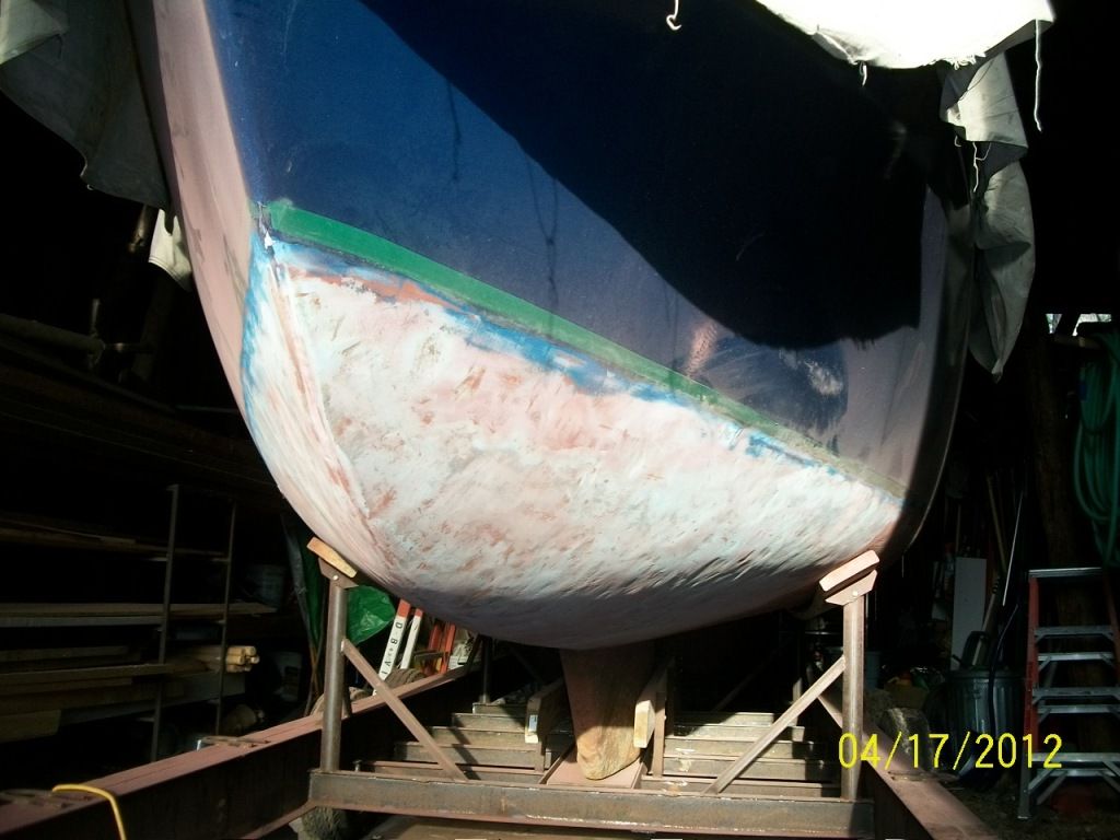

Got the stripe painted, The Hull buffed an polished and the new lettering on....
Cleaning up nice...Won't be long now till we head for the water...
