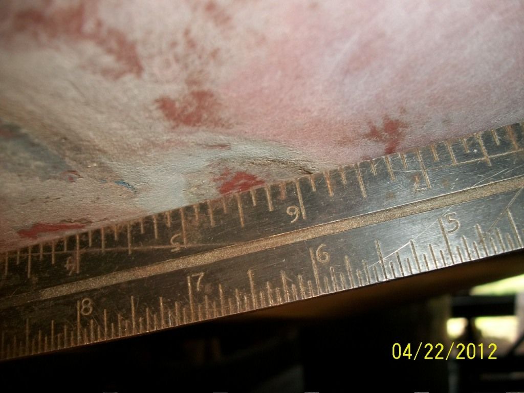

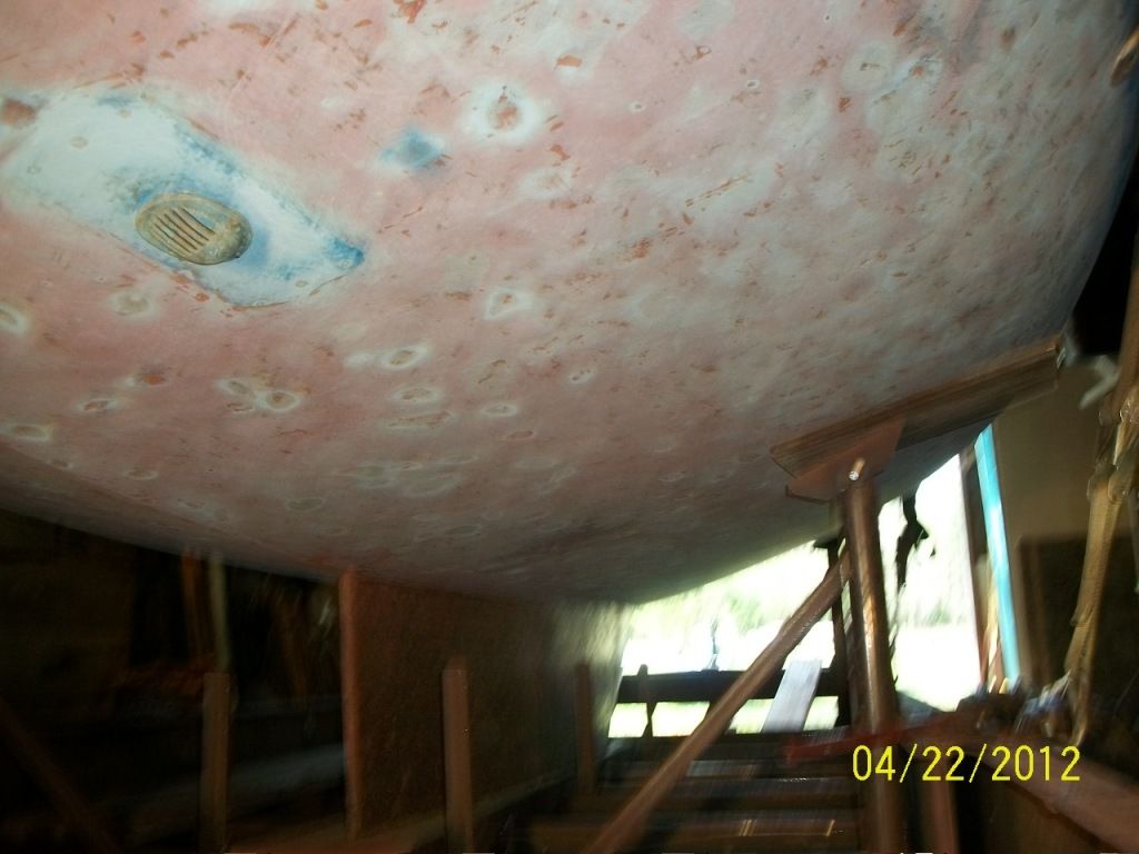

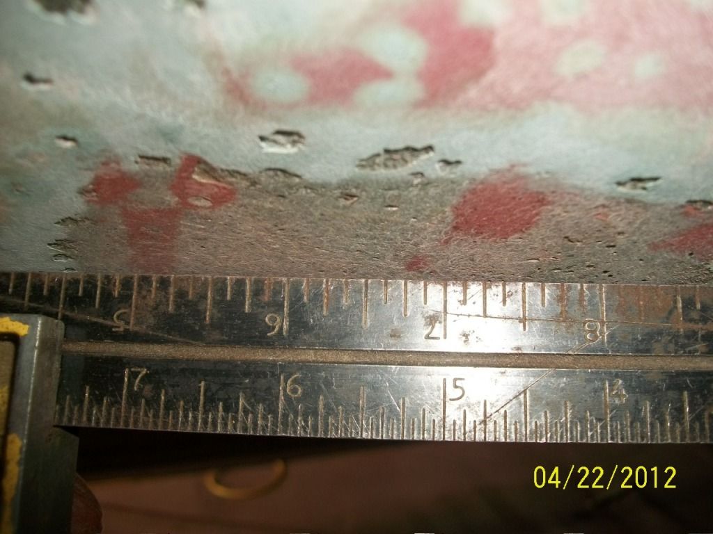

Anyway, after laying under this thing, staring at it day after day...It really doesn't look all that bad...Overall shape is still discernible just has a hundred or more "divots" to fill, so it shouldn't be too hard to "fair out" and get smooth...
After the 1/8" of ablative coating was sanded off, the resultant divots were only a 1/16" deep on average so not much filler will be required...
Worse one was the big one in the front (first page) but even that one is less than an 1/8" deep...
I think the late afternoon "shadows" were making it look worse than it is in the first couple photos...
Plan is to fill and fair with Fiberglass Marine Filler and then a coat of Polyester Resin overall, scuff sand and then hard biocide finish...

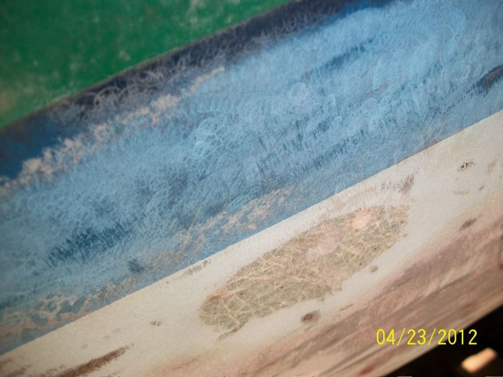

Here's what I'm seeing...There is no gelcoat on the bottom of this boat... I know what gelcoat looks like, there is gelcoat on the cabin and deck...the topsides are painted, but there is gelcoat below the Britesides ( I saw it when I touched up fender rubs)...
Just below the waterline, (green tape) is a blue line of gelcoat <w/some dark blue paint> and then it goes to the gray "Filler"....
There is no hard gelcoat "solid surface" to sand down to without going all the way down to the fiberglass matt.I don't know where the hard coating went, but it ain't there no mo..
I do not have the time, ambition or money to do a "Full Bottom Job" before I launch this season..I may do it in the future, but I have yet to see a full repair schedual I can believe in.
So I will be forging ahead on a Fill and Fair repair job, resin coating the entire bottom to tie it all together and then a couple coats of hard biocide paint for color and to keep the slime down...
I already have and will use a polester fiberglass filler...The can I have has a picture of a boat on it, says Marine on the label, waterproof and for above and below the waterline use...I'm fairly certain the gray matter on the boat is a poly filler (as do most opinions offered) and see no reason not to continue with it to fill divot holes...
At this point "spot coating" the exposed matt is a non starter if the filler right next to it is permeable, so after filling fairing and smoothing out (with wide spreaders, flat sanders and long boards) I will coat the entire bottom below water line with "Epoxy" resin witch should bond and tie in with whatever chemical soup is underneath... 2 coats and scuff sand for adhesion of 2 additional coats of hard Marine Biocide paint...
That is good enough for me for now...I want to go sailing...
