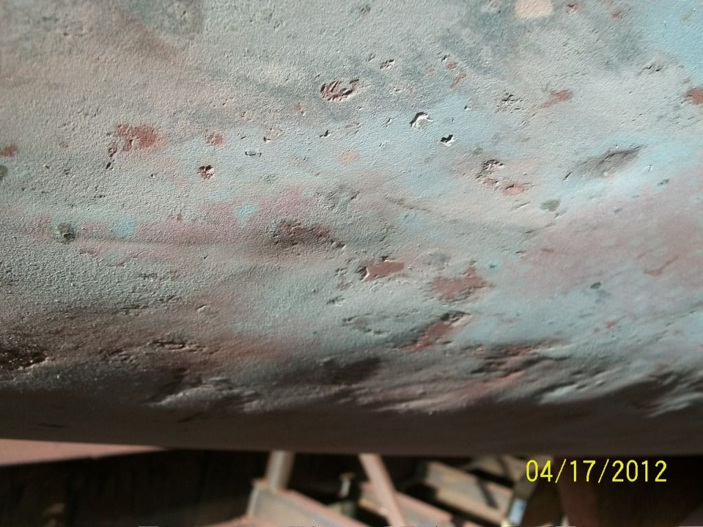

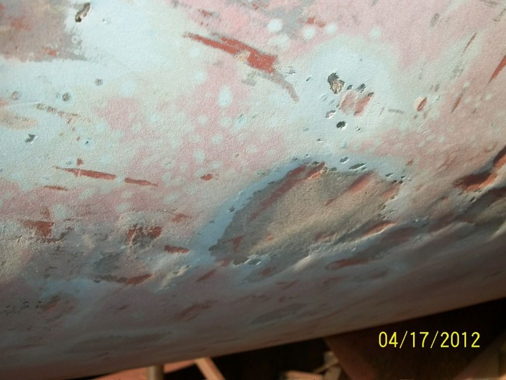

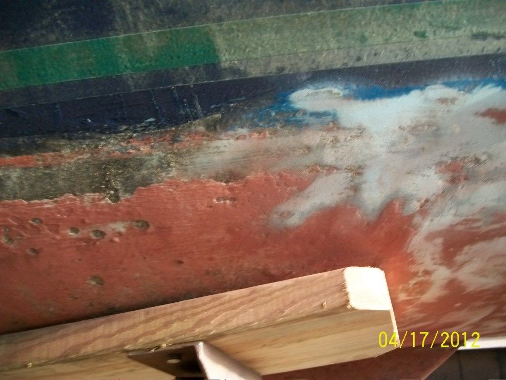

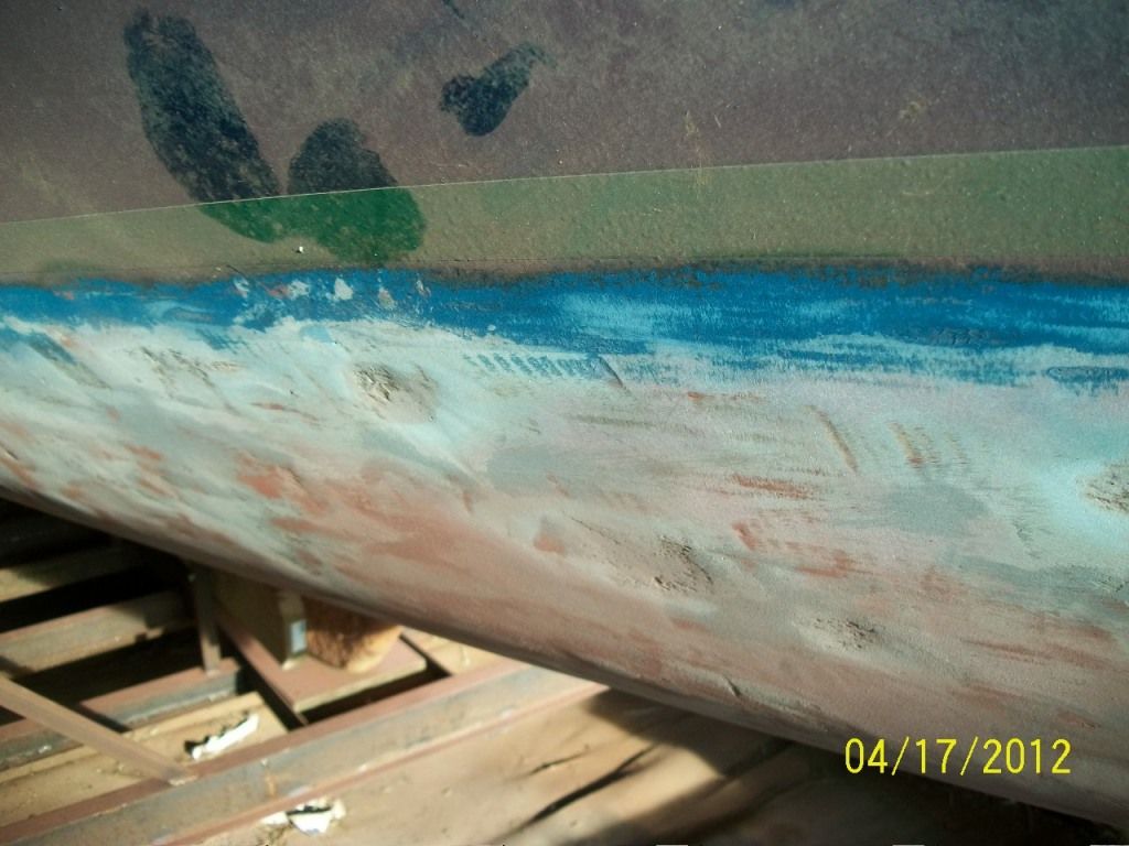

But I'm from the Midwest and not so sure what I'm looking at...(all we paint out here is houses barns and tractors...)
Is this supposed to be so "lumpy"...
Doesn't look like any "paint" I've ever seen before... It looks "thick"... like an 1/8" thick and like it was put on with a spatula and back brushed with a whisk broom...that's just the "Red" layer...
And it's "Soft" almost chalky or powdery...some of it flakes off (in the blistery ares and the "layered" areas.. and then the rest is stuck on tight...
Below that is a light blue/gray also "Thick" powdery layer...
I think it had popped blisters as well and then the red went over that...
Below the Gray is a greenish chopped fiberglass layer that is hard...
The whole thing down to Glass is almost 1 1/4" thick...
But you can see some of the red also goes all the way down to the glass matt..
So what do I got here and what do I do with it...??
I'm thinking continue sanding all the blisters/bubbles down to the green glass matt and then fair and fill with some sort of epoxy/poly "filler"...?
Then fair the bulk of the bottom to smooth out the "lumps...
Prime (type) ??
Bottom paint...
What I'm looking for is advice on getting it to the "primed" stage...There's enough arguments/threads on bottom paint choices already...

Tough to say w/o actually being there. It is not surprising to find a lumpy mess on a boat this age as bottom paint can build up quite a bit. The blisters you speak could be of concern depending on what comes out of them when you pop them and what lies underneath them and how many of them you encounter. You speak of fiberglass matt being exposed and that is probably not a good thing, though some of the early 60s boats did not gel coat below the water line so when taken to bare bottom one would see fiberglass cloth with a resin overcoating. I believe your Paceship is 70s vintage and I would guess the bottom would be gel coat.
Are you finding areas of gel coat and then areas of fiberglass cloth or matt?

The "gel coat" if there is one is whats throwing me...
I would assume the ablative coat(s) <red> would be soft and when sanding I should "hit" a hard coat layer (gel coat) but it just kind of mixes and blends with the gray coat and then bango...glass matt...??

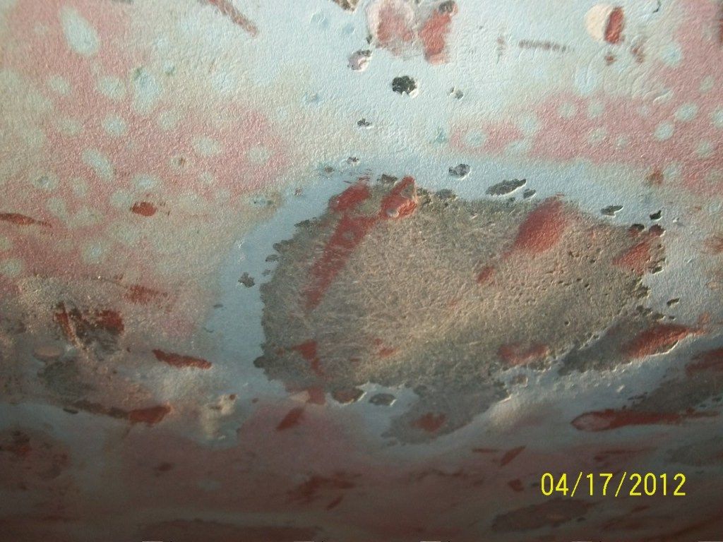

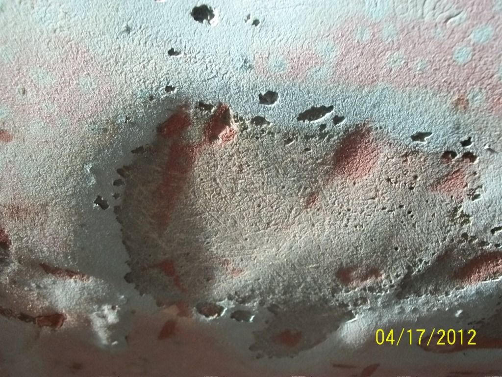

Here's a couple more shots...where you can see glass and depthe of "gray matter"
Blisters aren't "watery" blisters more like air bubbles between layers...and then when they open, they kinda peel away at the edges to become open "sores"..
Some in the red just down to gray... and some in gray that were covered by red...
And a couple that went thru both layers down to glass m matt

I am going to give you a bunch of terms to work with, I would trowel an epoxy filler over the bottom with a "VEE NOTCH TROWEL" .( think ceramic tile setting)Then I would use a LONG BOARD( flexible 2 inches wide and 3 feet long covered with coarse sand paper) to FAIR the ridges. When the ridges are all smooth trowel on a second coat to just fill the grooves left by the first trowel. Some of the ridges will be quite deep and some will sand down quite shallow.

I am no expert. It looks like your gel coat has a lot of voids and for some reason has has torn/worn away. What about using West Eposxy with a filler to fill in where the gel coat seems to be gone and then go over the entire surface with another coat of West to fill in those voids? I really am not sure.

water froze and lifted the gelcoat (or whatever it is) off in sheets making big bubbles kind of like when water gets under a flat roof. It's all going to have to be taken down to solid fiberglass. Looks like someone kept grinding deep into it on some spots.
Ross is right on. I would only add a lesson from autobody workers and use a sureform type shaver to remove the high spots just after the epoxy filler is set but not rock hard. Use microfibers for filling large depressions then use a softer filler to do the fairing. http://www.westsystem.com/ss/how-to-use/
