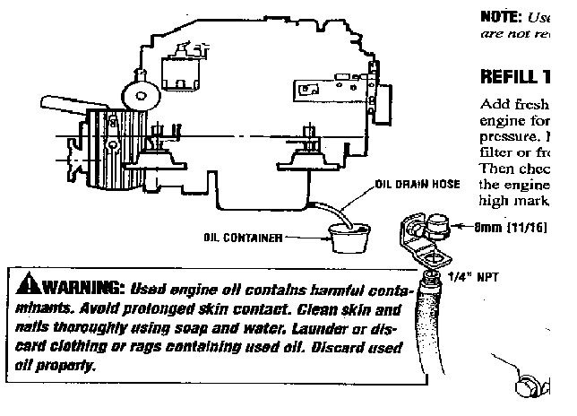

Have a Universal M25xpb with the sump drain kit. Because of location, gravity won't work so I planned on getting a manual or auto pump to change the oil next week. Manual stated that the hose end is 1/4" NPT and looking on the normal websites I cannot find a pump that has the female connection on the hose and most of them have dipstick probes anyway.
