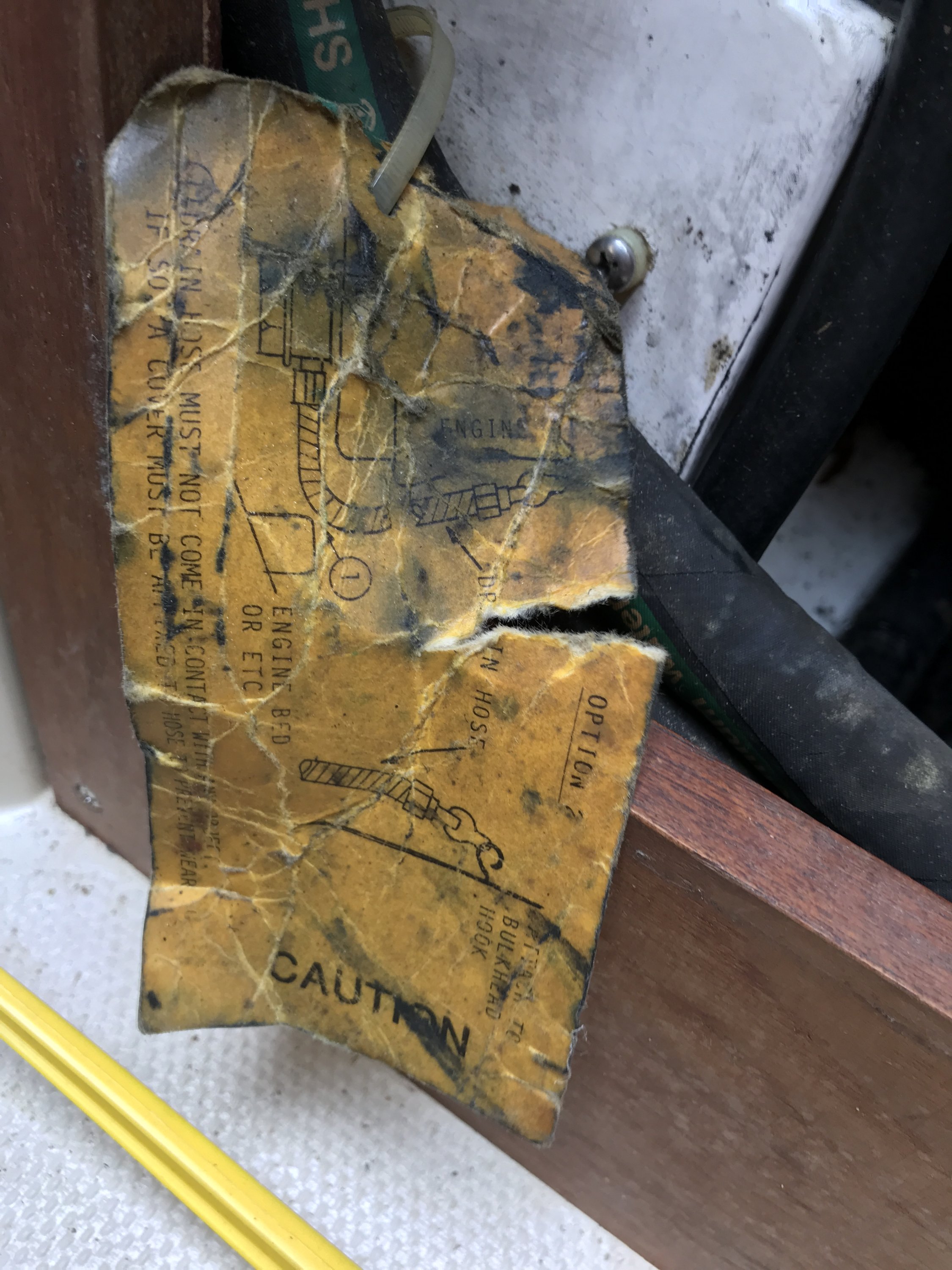

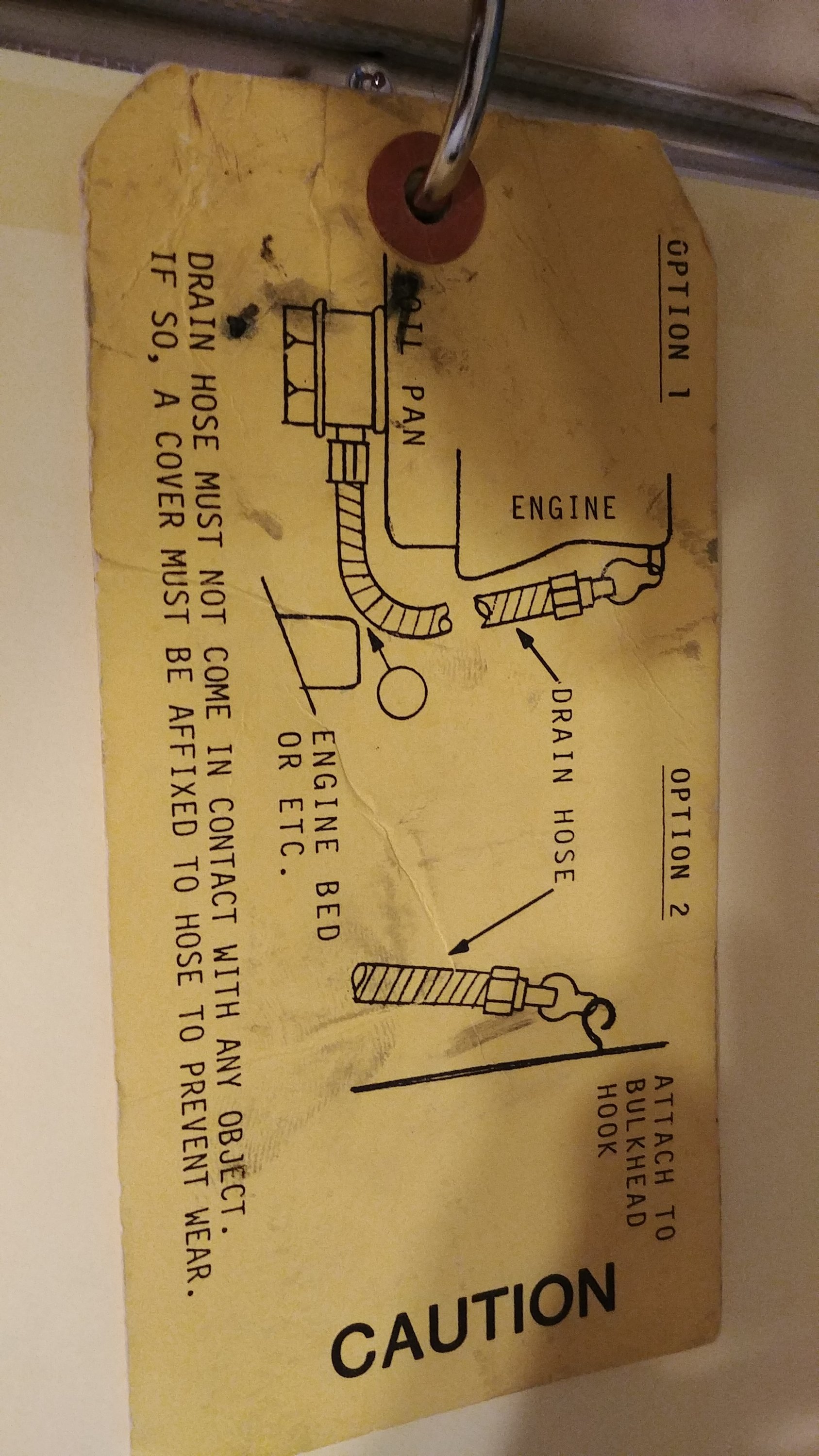

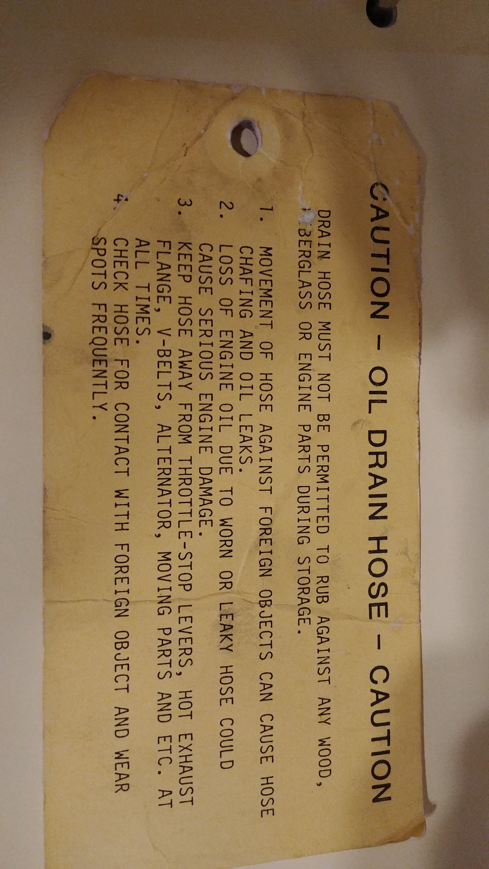

I’m guessing this hose is attached to the engine oil drain. Anyone have experience using something like this?
I’m planning on using a fluid extractor to pull the oil unless someone has a warning against it.
Thanks
