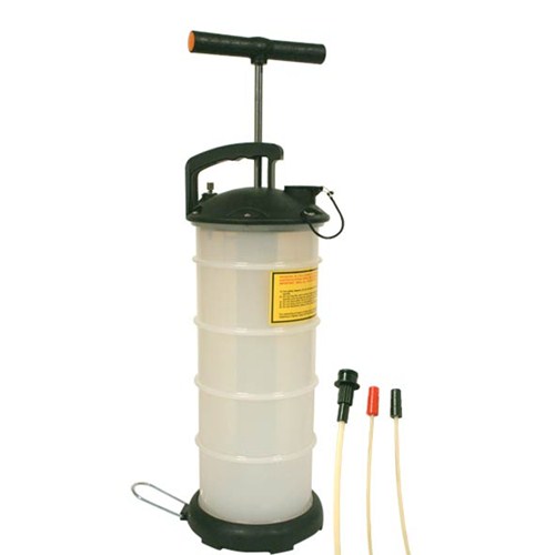

I use this style for my Yanmar 3GM30F on my 340.
Its been in service for 24 years now and still going strong. Plenty of suction and the tubes get to lowest point in my oil pan, so I am confident it is getting the oil out. I use the dipstick opening in my engine and do not need to seal the hose to the opening. You do need a tight seal at the top of the tank. This unit has an O ring that makes a tight seal.
Neat, clean job. Pours old oil out easily.
You have to use it in a warmed up engine. It will never work well in cold oil.
Now you going to ask the name of it…….off hand I don’t know, but you’ll find this style in West Marine or any good wholesale supplier. (Defender Marine etc)
As for your filter try TOAD Marine for the proper one and go from there.

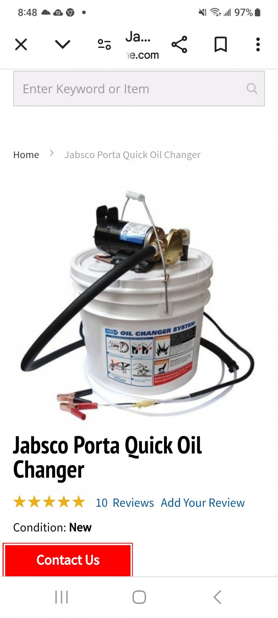

I use a 12 volt pump on the outside of the tube for changing your oil. if you look at it , it goes all the way to the bottom of the oil pan. Quick and easy. I always do it with warm oil and when done pump it back into my empty oil containers. I've been using a Fram PH3595A filter.
