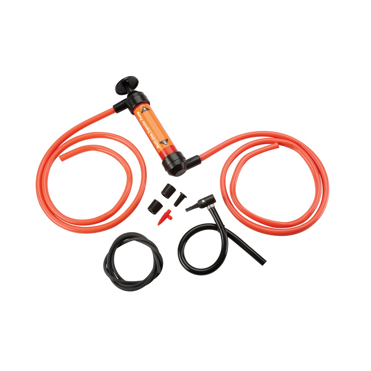

But if you want to change it now, Harbor freight And Tractor Supply and other hardware stores sell a $10 hand pump that would work in a pinch. Not as good as an extractor, but I have used one before I purchased an extractor. A gallon milk or water jug to Hold the old oil.
