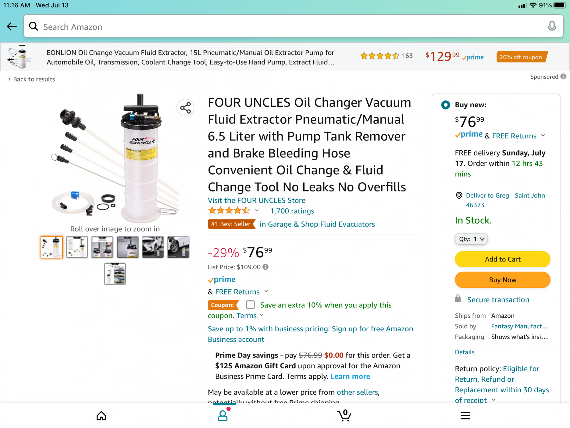

I also have a 2GM20F engine. I purchased one of the on Amazon and it includes several different size tubes. I use the largest one that fits into the dipstick tube.

Hi Lynn, I've used one of these for years, both on our first boat with a 2GM, and our current boat with a 4JH. Works great and has the plastic hose that fits into the dip stick pipe. https://www.amazon.com/America-5060...uPWNsaWNrUmVkaXJlY3QmZG9Ob3RMb2dDbGljaz10cnVl

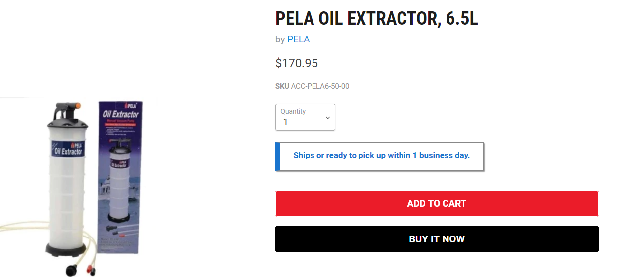

I use this oil extractor for my 13 hp Yanmar 2GM engine. The engine needs to be warm for it to work. Jiggle the tube around a bit. I found that if I jam it in too hard, the tube seems to bend upward inside the oil pan and sucks air instead of oil.
